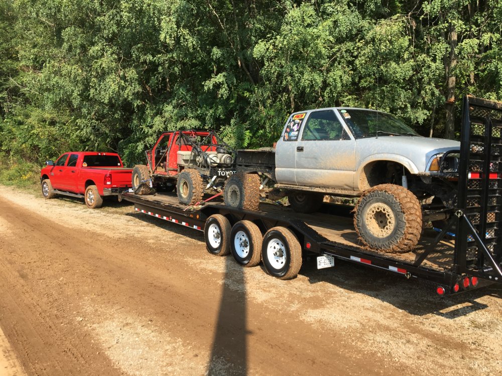

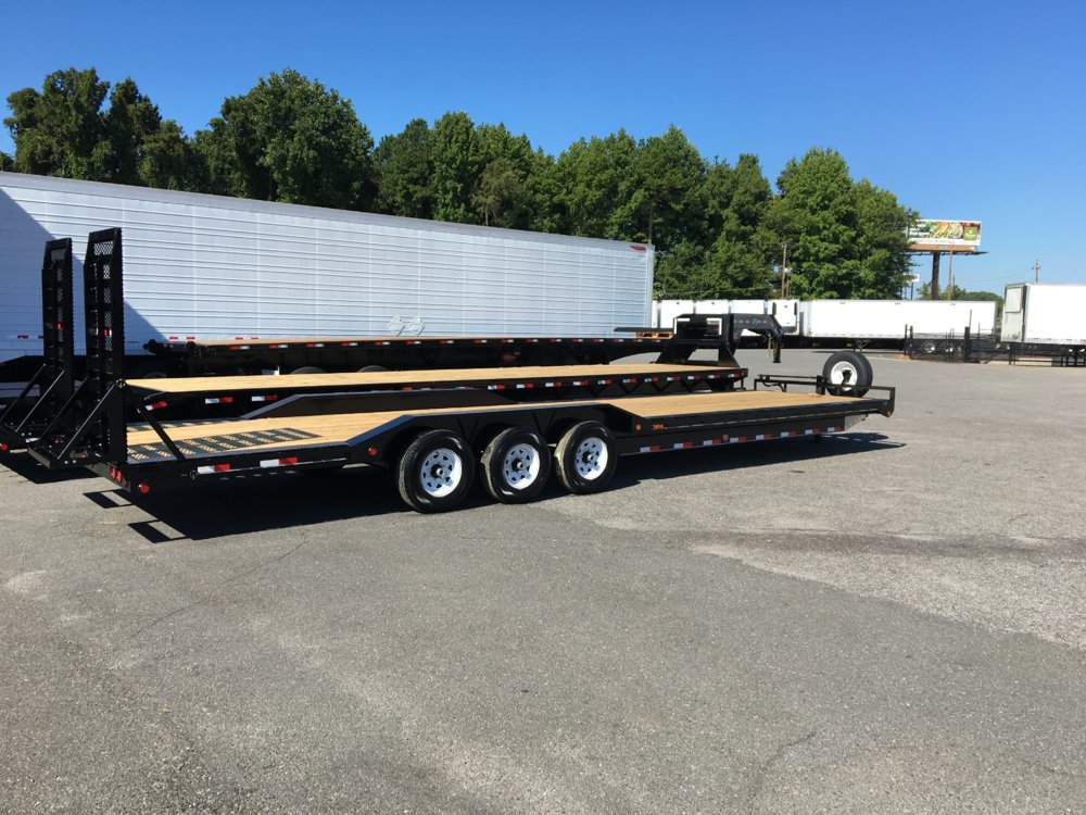

I disagree with this statement. I’ve had my trailer to Dixie Run and back. All through Uwharrie into Badin Lake Campground and backed into a parking spot. It’s never drug the ground once. Axle placement plays a huge role.
As does 3 axles (assuming that 34' pic you posted is yours?)
b36c835d-77d9-4a31-915e-1f9173b4b3a6-jpeg.261985
You can put casters on all 4 corners and never drag the trailer either, but thats not my point.
Yep, mine.
So how do you like pulling a trailer that big with a bumper pull and how do you think the three axles vs two compares to turning radius
Number of axles won't make a difference for turning radius, three axles just scrubs tires worse on sharp turns. Long bumper pulls tow fine in my experience. Like any trailer, how well they tow depends on axle placement and weight distribution.
