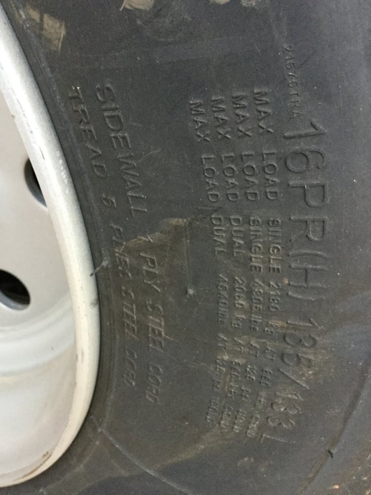

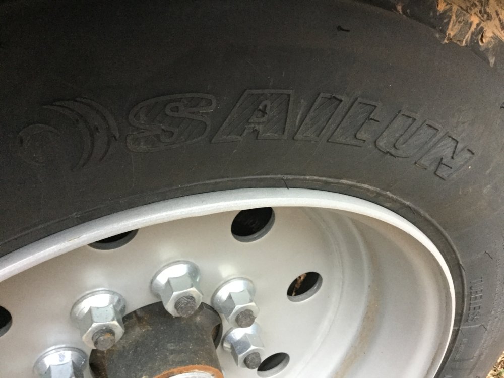

See photos. I am checking my build sheet with dealer concerning these now. I don’t think they are as specified. They are the 215/75-17.5 H 16 ply which puts only 19,220 on the ground. It was pouring rain last Saturday and freezing cold when I picked it up and last thing I want to do was check the tire rating....I should have. Anyway,the Gatormade main frame is a 10 inch I beam with a 12 inch I Beam for the neck. Another feature I liked when comparing pricing to Kaufman options. I did just check the spacing on the cross deck supports and they are on 16 inch Centers as specified. So that was correct.
That math doesn't make sense. You have 8k axles with 9600# of tire capacity per axle. Seems legit.

Concerning the tires, I wouldn't let it bother you too much. It's still better to not have the tires as the limiting factor and that's mostly why I wanted 17.5s. I know the axles can probably handle more than 8k, but that wouldn't matter if the tires couldn't.
The one I got is rated at 17k...but two 8k axles is 16k...and then the tires can support 19k. It's like trailer manufacturers don't math real good or something. Whatever...
