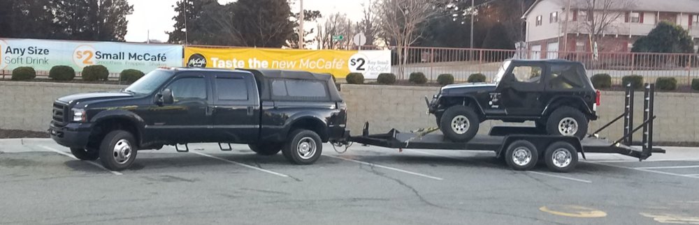

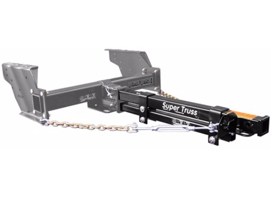

No, I wouldn't trust that little single tube to tow a trailer. Given my wife's health issues we require a bathroom and to make her more comfortable we wanted a "Dry Bath" in our camper. I don't currently have any pics of mine but it's a 60" trussed extension which utilizes a over under hitch. At 60" mine is rated for 1k tongue and 10k trailer with load distribution hitch. A shorter extension gains higher tongue and trailer weights. Given my truck is OLD, I converted it to a DRW and updated the springs to 3600Lbs per side and already had airbags. With Jeep and trailer being approx 5500 to 6000lbs it pulls straight and true without any surprises. I did a lot of research prior to investing in this setup and it really was designed for the truck camper application. @shawn followed us all the way back from URE and can attest to it's stability. I like my setup as it allows me to do exactly what I want but I paid alot of $$$ to get here. I spent over a year looking into this after the wreck I had flat towing with my last camper. Not wanting to revisit that situation again, I think I have got the safest solution I can get with my requirements. I suggest taking time and really researching into how you want to tow your rig.

So put the camper on the trailer when you're going wheeling with the Jeep, put it on the truck when you're going camping solo.
@Rox&Mud 's setup is nice. But backing into the driveway, dropping the trailer, and being "unpacked" is also nice.
I like rox and mud's setup. I looked into those hitches for mine but couldn't find any at the time, mainly because my truck is an odd ball for the year. They may be out there for it now but have gotten used to my current hitch setup.

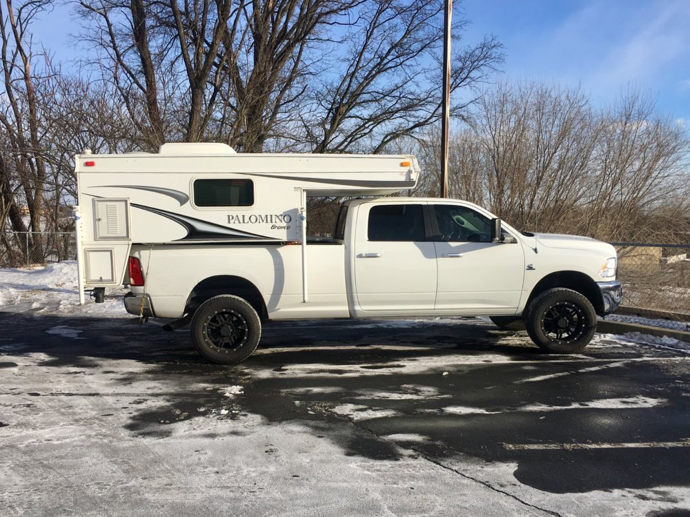

So I have been exploring different approaches, and one is selling my current camper (it is for sale on here); however, I really like this camper and it suits my needs and then some.

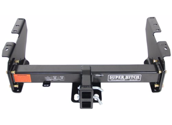

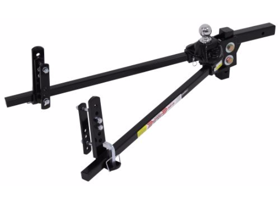

I am keeping the camper for sale, but my price is firm, so if it doesn't sell, then I am going to use it. I went with the hitch and extension like @Rox&Mud posted above (Black Friday / Cyber Monday saved me a couple hundred!). I already have a weight distributing hitch that I had from back in the day when I towed with a Tahoe. I also just put airbags on the truck. With these mods, I think I am setup as best as possible. I would love a dually and I know it would be ideal, but I think this setup will work for me and my truck. Ya'll can wave and laugh at me when you pass me on the highway, because I know I will not be setting any land speed records, but I think it will get me to the trail safely.

Let me know if you have any questions and I hope everything works well for you.
