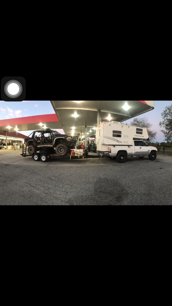

Better angle

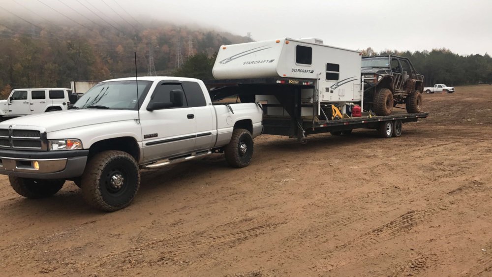

Current set up on a gooseneck

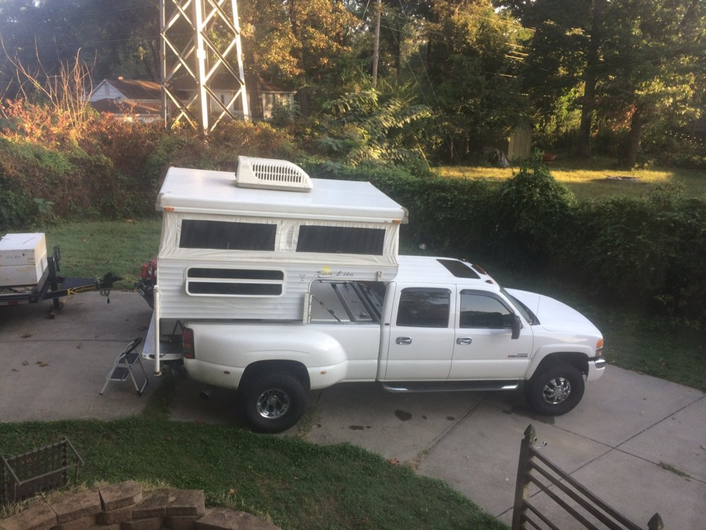

Find a camper that doesn't need a hitch receiver and I'd highly recommend pulling it with a dually. Here's my setup, trailer tongue goes under the camper with plenty of room.

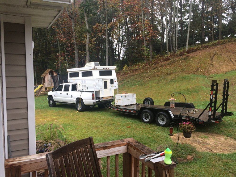

Looked for a long time to find one that that would work with my setup without using an extension. No bathroom in ours but budget wasn’t there anyway.
We decided to remodel the interior and are excited to start using it. Pay attention to jack placement as others have mentioned for your truck/trailer set up.

Nice setup
