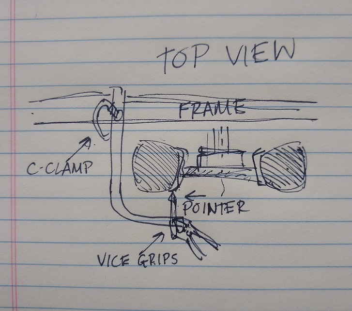

Make/find something that is an "L" that you can mount to the trailer to use as a crude runout indicator. Bent piece of scrap, two pieces of metal welded in an L, whatever. Doesn't matter. C-clamp one end to the trailer frame, and visegrip something to the other end to use as a pointer. There's no load on it because nothing is touching it, you just want it to stay in place. I'm just suggesting C-clamps a vice grips because you probably already have them, and it's all it needs to be.
I have done this runout indicator method too, but to check true on a standard aluminum wheel after hitting a curb.
I drew scribbled this in about 15 seconds while microwaving my lunch; laughing is fine. It's a cross section of the wheel/tire, to illustrate that you want the pointer close to the wheel rim so you can see the wobble as you rotate the tire. You're looking down from above, like you're leaning over it.
