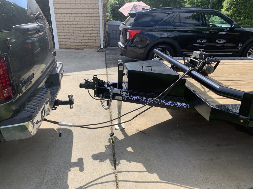

I had a receiver built into my stop bar. Quick disconnects for the winch, so the winch is out of the elements and could double as a rear winch without the trailer if needed.

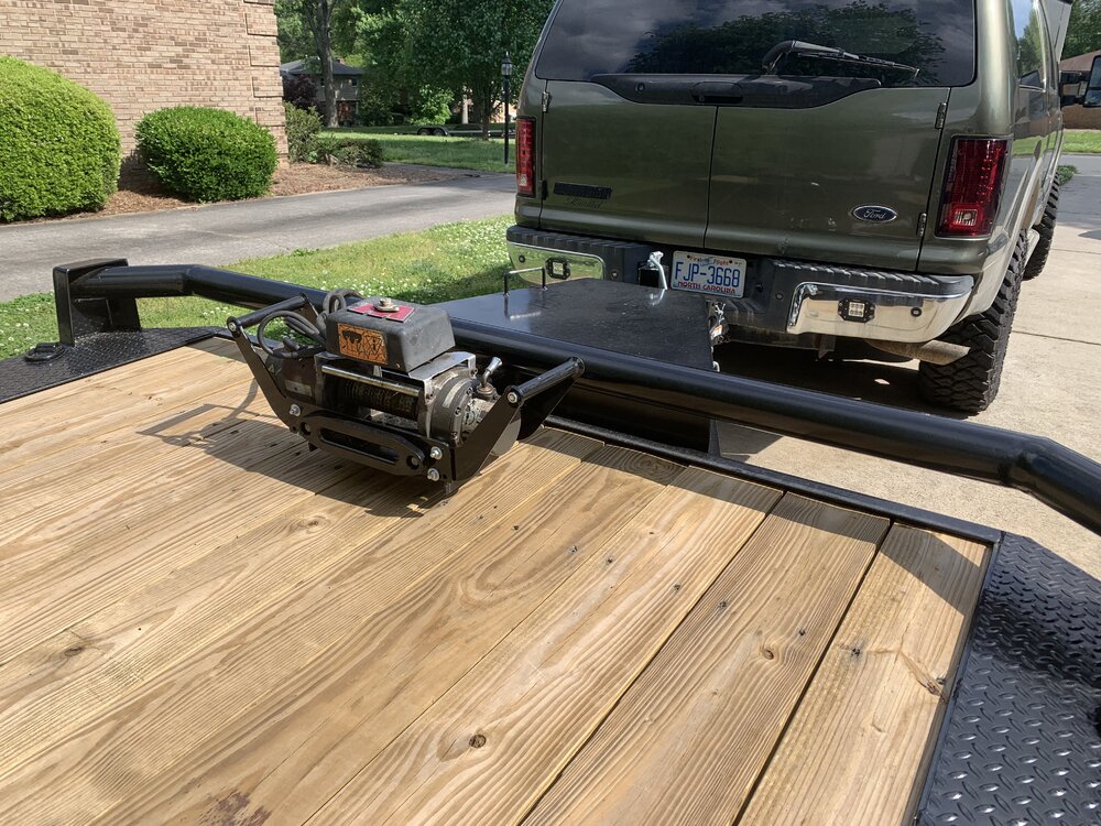

@jeepinmatt has one that is very simple and pretty darn slick. Much less complicated than the one in the posted video.
Here's where I posted some pics:
Doesn't have to be expensive. You can build your own. Just weld some tube to a winch plate and trailer for the pivot, and put an old axleshaft through it for the pivot pin. That's basically what I did.
Only thing I would do different is use a winch without an integrated solenoid pack. It tends to catch water, and also hangs down and cuts into my storage space. My plan was to build a box over all of it, but like most plans...

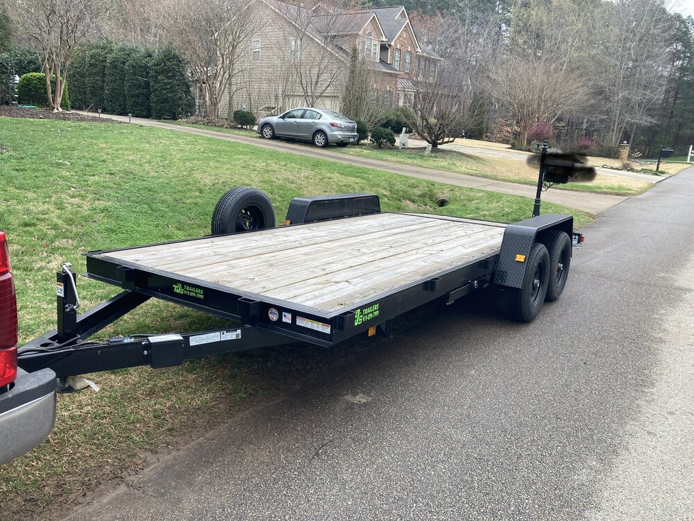

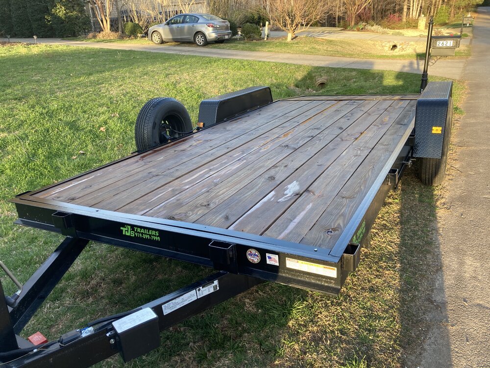

Step one complete - added 3 heavy coats of ATF to the top surface of the deck. I started but bailed on coating the underside. I didn’t feel like taking an ATF shower today.
Before.
After. It’ll mellow and fade as it absorbs and dries.
I’m adding the roll stop, stake pockets, chain guides and run rail this weekend. I’m going to add a couple d-rings and also fabricate some of those stale pocket d-ring things too.
When you are burning all that steel in make sure you have a fire extinguisher nearby. Just thinking about all that ATF on the wood.:kaioken: would hate to see a new trailer go up in flames.
That was my first thought. Looks great, but id have waited to soak the trailer in flammable liquid until I was done making sparks.
