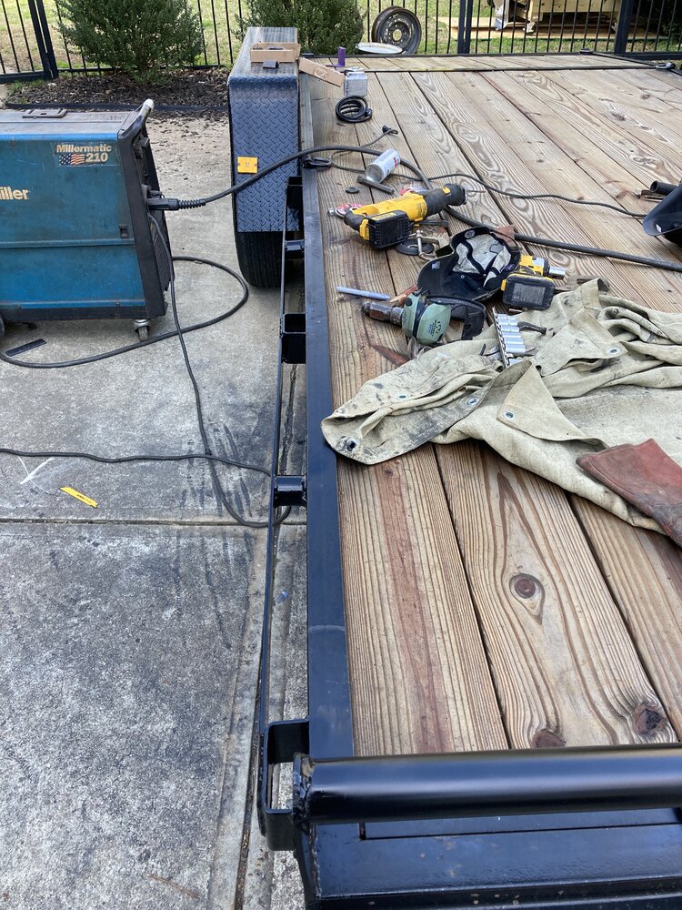

I took precautions, but pressed on today with grinding and welding…. I scorched some wood, but nothing catastrophic.

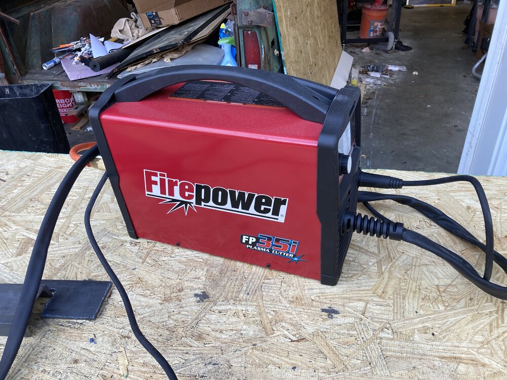

Full day burning steel. Used my new plasma - like a hot knife through butter! Love it!

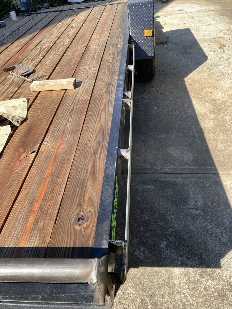

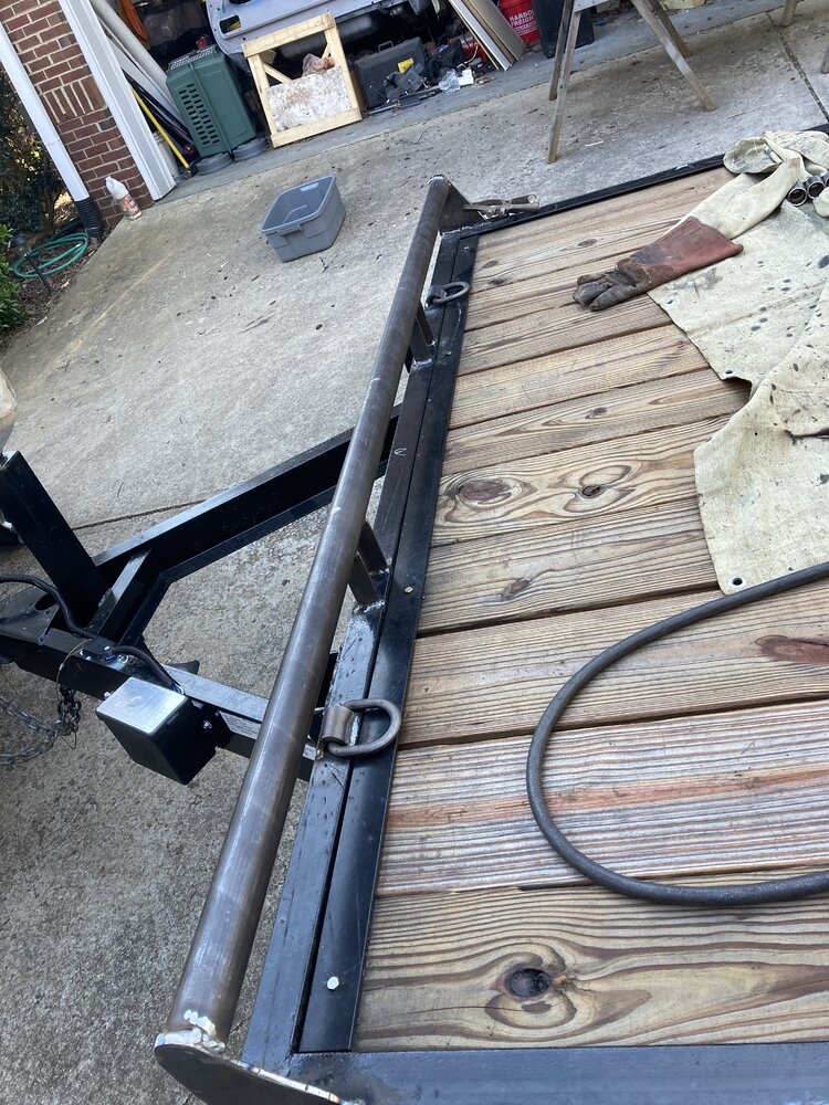

Added the roll stop to the front of the trailer deck
Centered the front,middle stake pockets up front (actually cut off the old and replaced with a new one)
Added a 2nd stake pocket to each side behind wheels
Added chain guides to both sides 2x front and 1x rear
Added 1/4” rub rails front and read to both sides

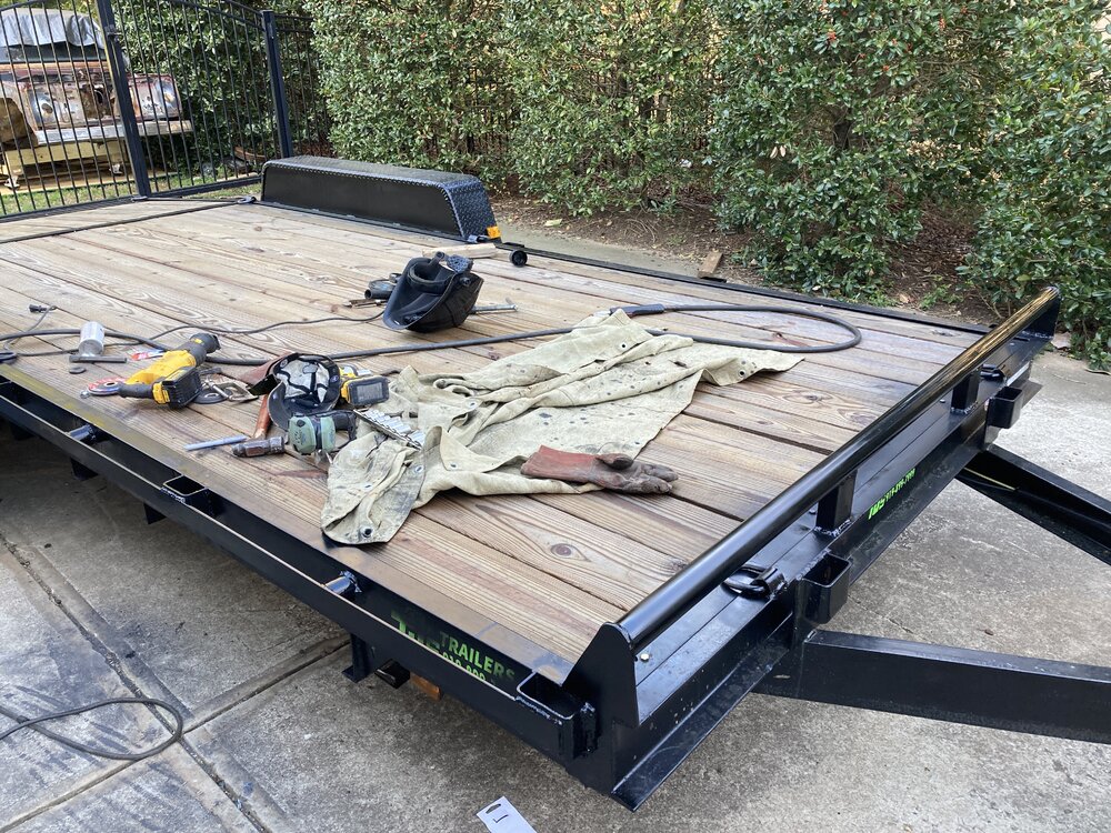

Added 8 d-rings (2 front, 2 side in front of wheels, 2 behind rear wheels, 2 at rear corner)
She’s ready to haul anything. I may go get 6yds mulch Monday just because I can. I’ll load the #2 bronco after mulch to get it out of the yard.
