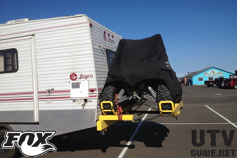

I do appreciate all this input though. Helps me learn capabilities. Shane, that was a great link. Thank you. It sure does look goofy but what a brilliant idea. It is something to consider.
