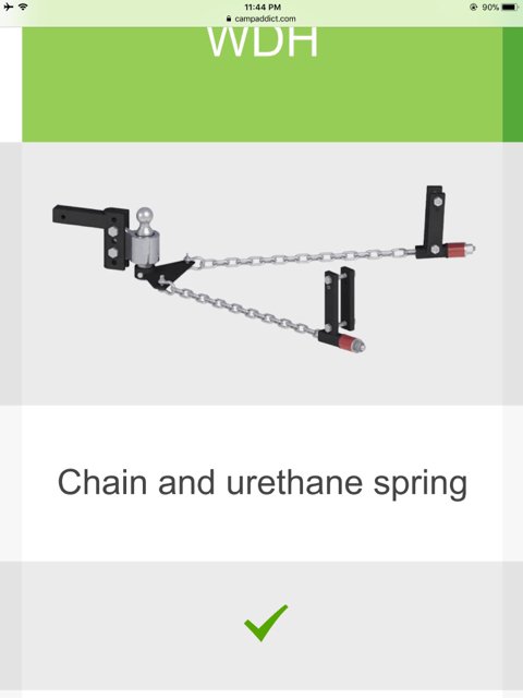

Anyone have any exp with the antisway WD hitches that use chains instead of the sway bars? See pick for the Andersen one.

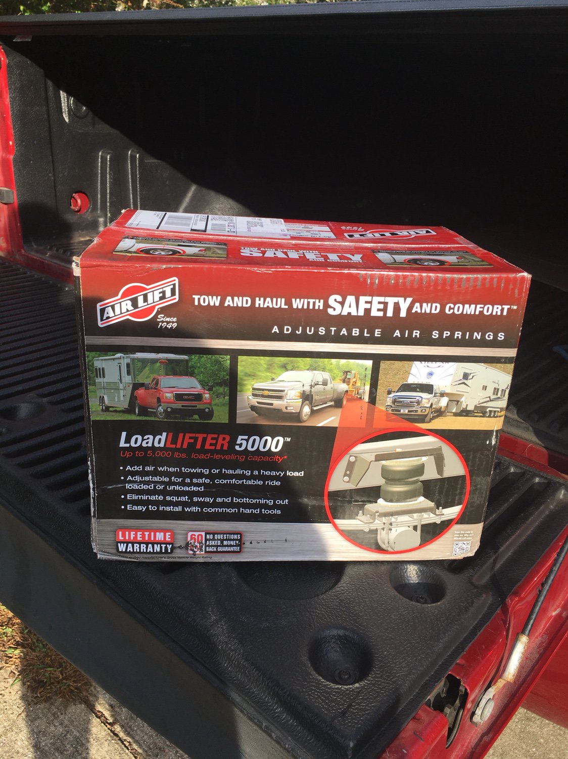

I got on the horn with airlift. they said their 5000 bags are going to mount next to the coil, not over/around it. in regards to the 1000HD bag inserts, they stressed about "prevent coil from compressing under load", that that is exactly what they are designed to do, but they do not prevent compression from occurring. Just prevent bottoming out, and keeping the load level up to 2000 Lb payload. They said either would work for this situation, however for frequent use the 5000 bags are recommended.
Going with full bags then, however the 1000HD was a pleasant thought/detour. Haha. It was a cool convo with them tho.

ordered airlift 5000 bags. found a few brake controllers that plug into the factory harness and work, they are in the 60$ range compared to the 199$ for the OEM controller, which after research, some said they had issues with it not communicating very well. probably going to go ahead and order that tonight. taking advantage of some labor day sales.

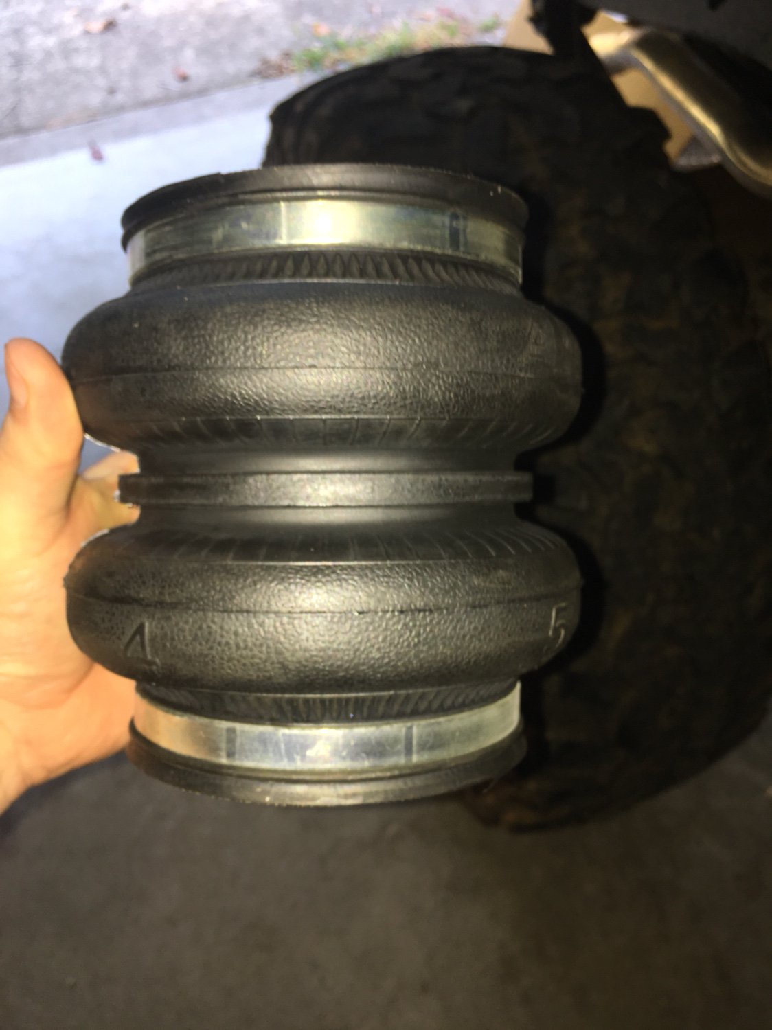

Bags arrived. I’m impressed with the material, it’s more than I thought it would be

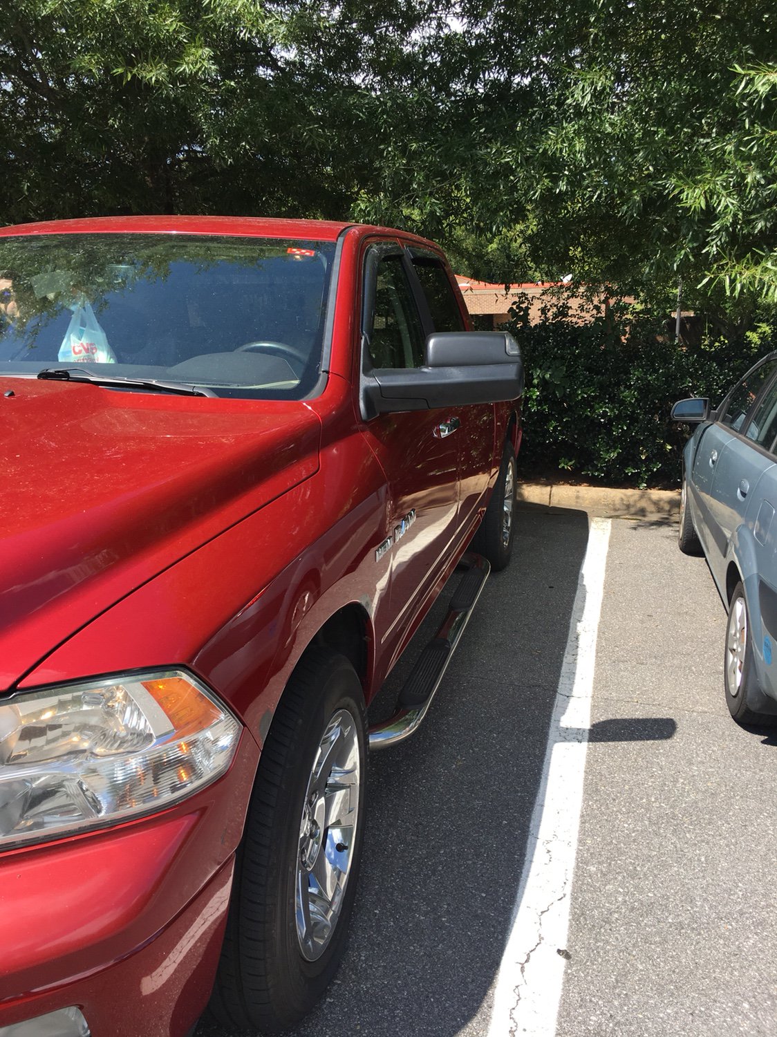

Tossed on the mirrors today in a hot moment between family times. I like it, one less but if chrome. Lol
