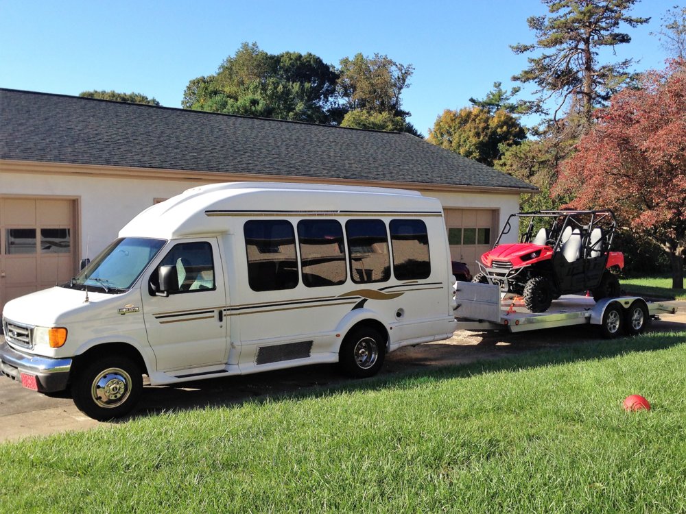

I heard the vans with the v10's were detuned versions of the truck v10's so hopefully the 2006 v10 truck has more balls than this 2006 v10 van. This v10 dually van is vanna white, she is not mine but I have access to use her pretty much anytime. Unloaded she seems to move good, loaded is ok and she stops good but all that overhang behind the rear wheels really makes towing anything with tongue weight tricky, even with airbags.
The vans never got the 3V motor.

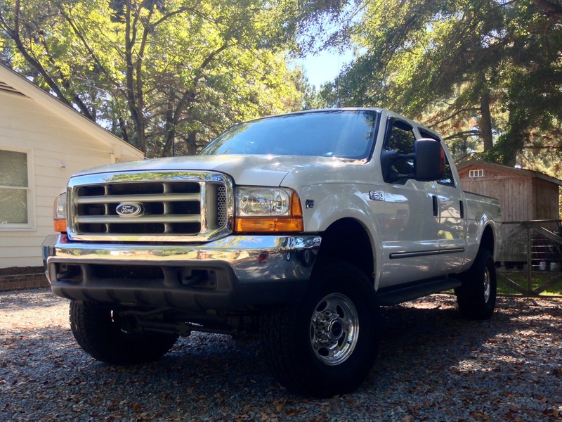

I had a really nice white crew 4x4 Lariat 2000 SD with a v10. It was a great driving truck with good power and I really liked it. The newer v10s have better power and feel punchier. It towed ok and like all said, you have to let them rev. It had 4:30s and 35s and I put many miles on it between here and our mnt place.
This said, I would not go back to the v10 from my current 7.3. The 7.3 only had 32K on it when i bought it in April of 2016, has 42K now. When my neighbor finally sold it to me after years of asking, she practically gave it to me. Good neighbors are hard to quantify. It's a crew 4x4 Lariat.
The diesel is better in every way, gets 20+ mpg unloaded (v10 got 12) and tows 7K lbs of tractor to the mountains like it's not there.
Old v10
New low mile 7.3

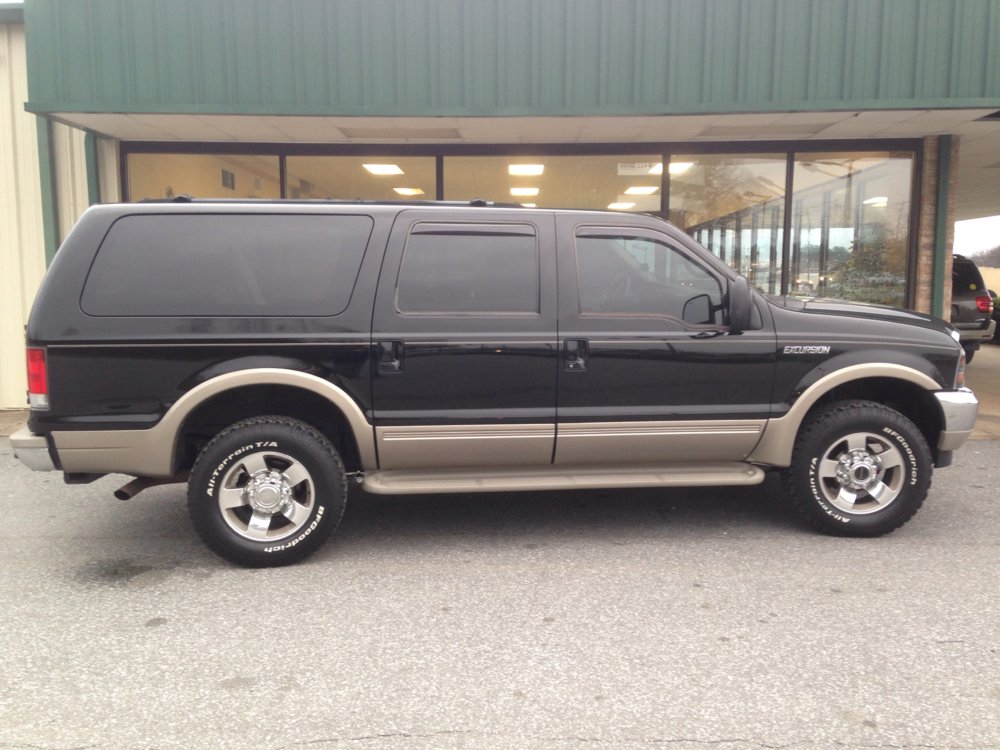

I owned a 2001 excursion V10 4x4 135k with 3.73's...it was like driving an old bread truck! My advice is this...get a 4.10 or 4.30 geared truck...you will hate 3.73's with the V10. The only upside is unloaded highway mpg! Believe it or not I got 16 with mine going to the beach and back! If you buy a V10, the 1st thing you need to do is re-torque the spark plugs. They will work loose overtime! That's the main cause of them blowing out on the early 2V's. 6 out of 10 of mine where loose when I bought it! That said I wish I wouldn't of sold it!
