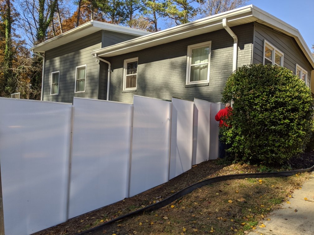

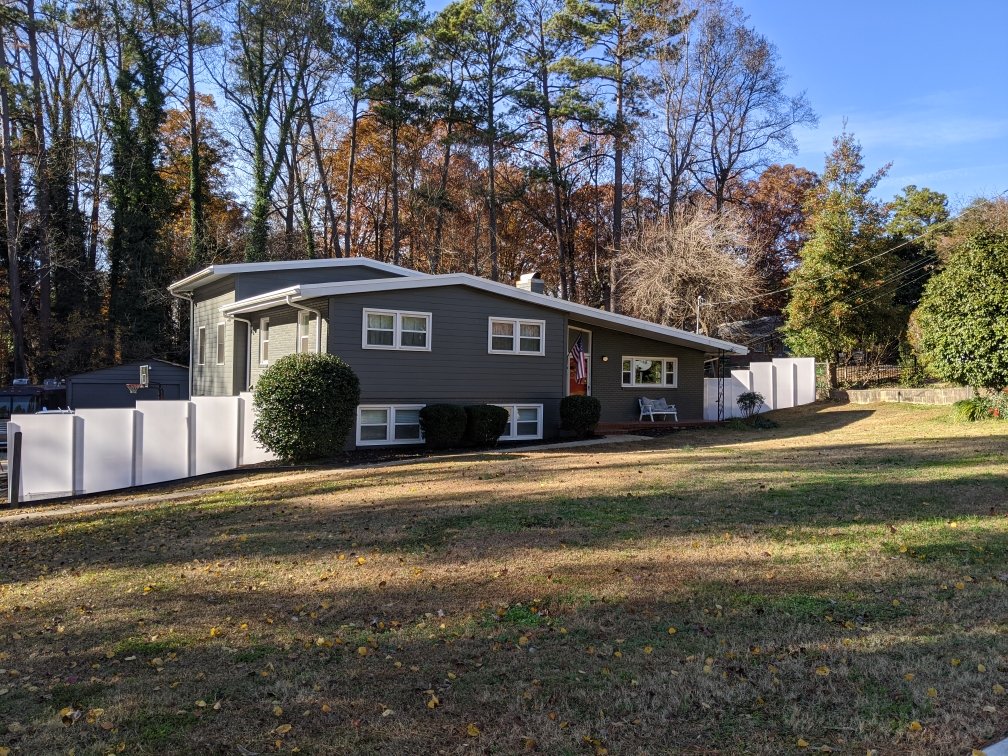

Wife and I decided to make a new fence for our house.
We are going for a modern look.
I found some sheets of corrugated plastic that is translucent. We put new posts in yesterday and today we did one side of the house.
Still need to trim out the fence but it is up
Hope to have it all done by end of next weekend.

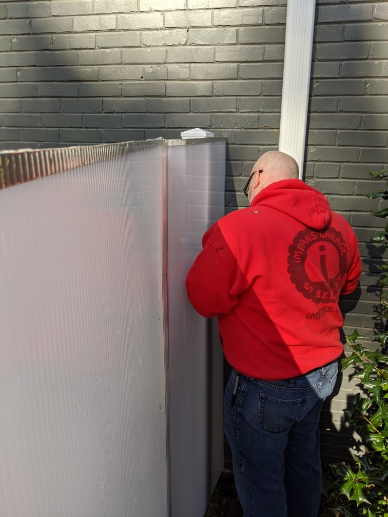

What are the posts made of and how are they attached?
Posts are 4x4 treated wood concrete in the ground.
Then I put pvc 4x4 covers over them with caps.
Each panel connects to the next with a snap connector I found. Then each connector is screw into the 4x4 posts.
With the additional trimming I am planning it will all be very secure.

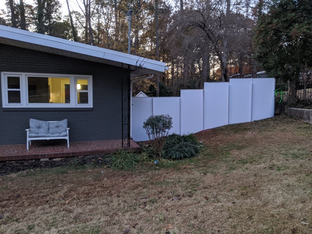

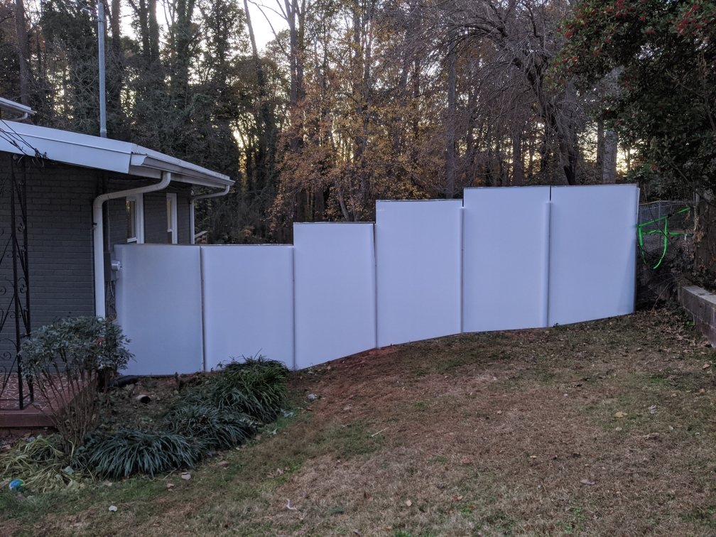

Trying to get this done.
Worked on it all morning

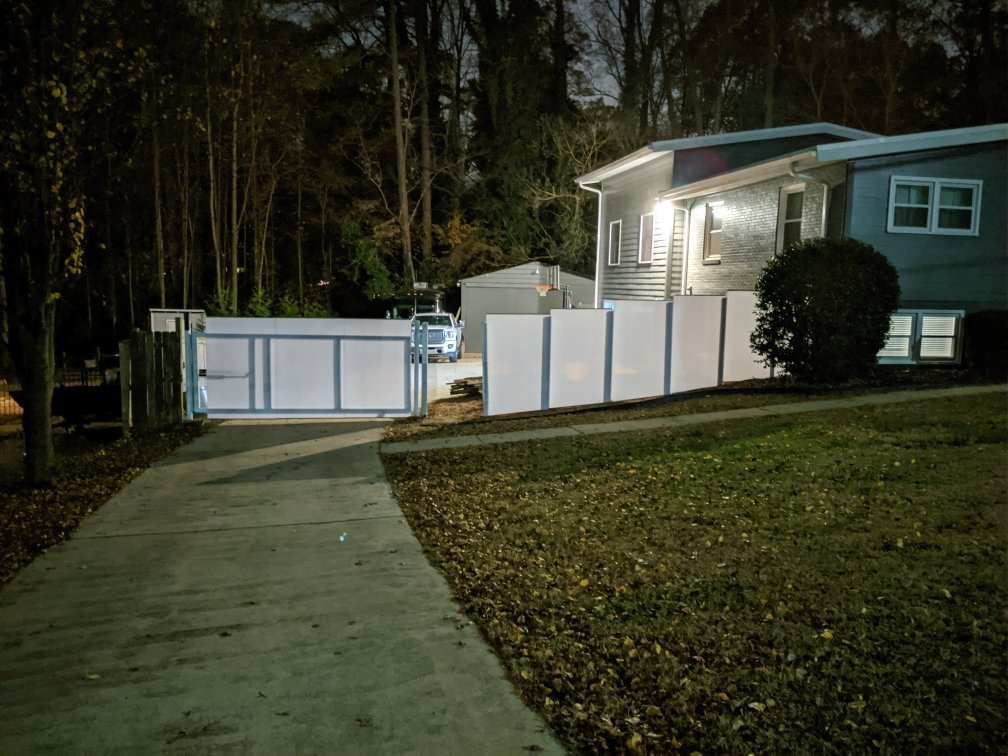

Next is the big gate and walk thru gate and then trim.it all.
