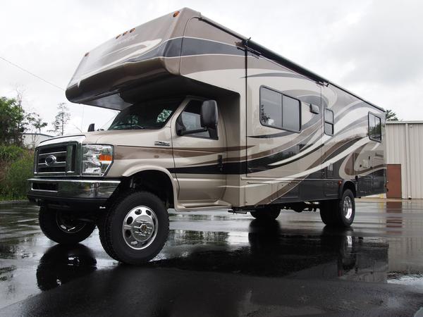

Long story short. My old middle and high school buddy Chris moved back home and was looking for some help getting his 4x4 van business going. He was quite successful in California before moving back to NC. So, we got together and started doing some conversions. Here's a few pics from the last build. Dude drove down from Wisconsin and watched and waited while we built it.
It went from bone stock 07 E350 to the finished product in the pics. Regeared to 4.10, brand new 60 front swapped in, UJOR 4" lift, 5100's, converted tranny (5R110) to 4x4 and added a NV271. Finished it up with 285 KM2's on rockcrawlers.
This one is fairly mild compared to some other UJOR conversions, but it fit the customer's needs perfectly. He then hopped in, pointed north and drove home to Wisconsin.
