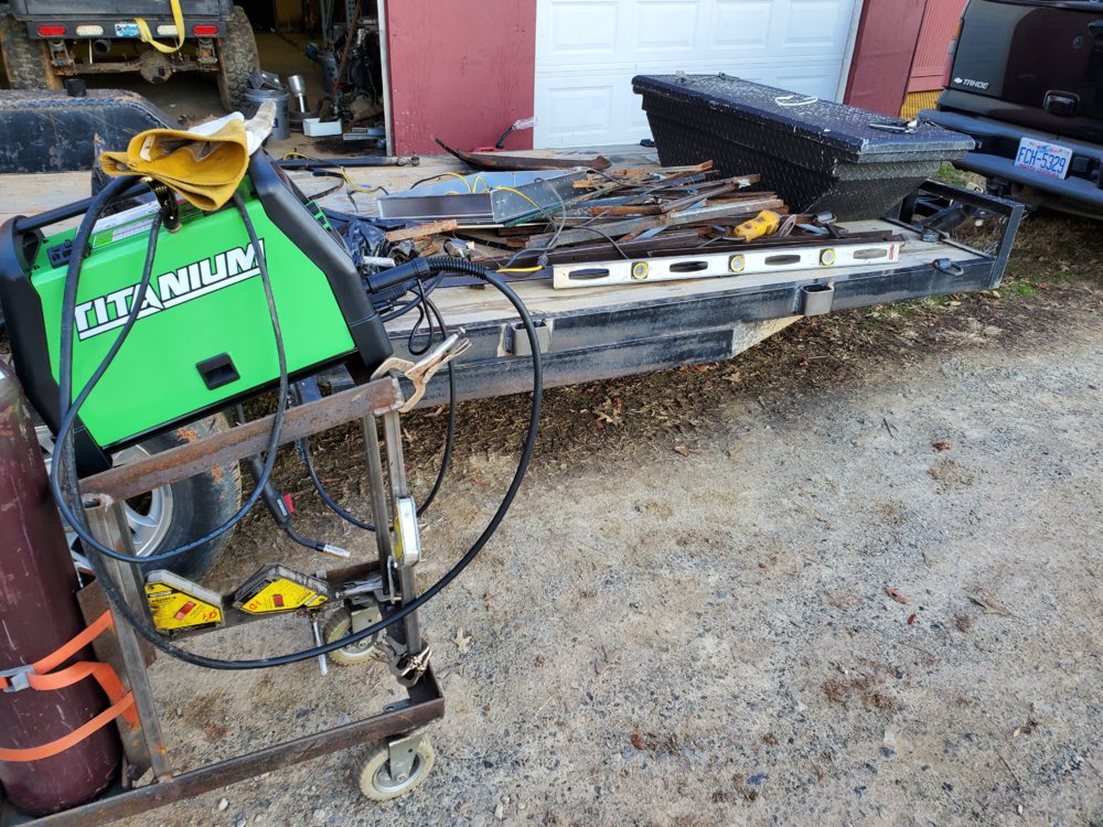

I have a HF Titanium and love it so far. Use ESAB and Miller 480v at work. This lil multi machine burns hot and constant for what I've done with it. Like stated above if the person in the hood knows what there doing and what there using the end result can be just about the same. Of course I wouldn't go after anything thicker than 1/2" with mine bit that's part of knowing the tools limits.
