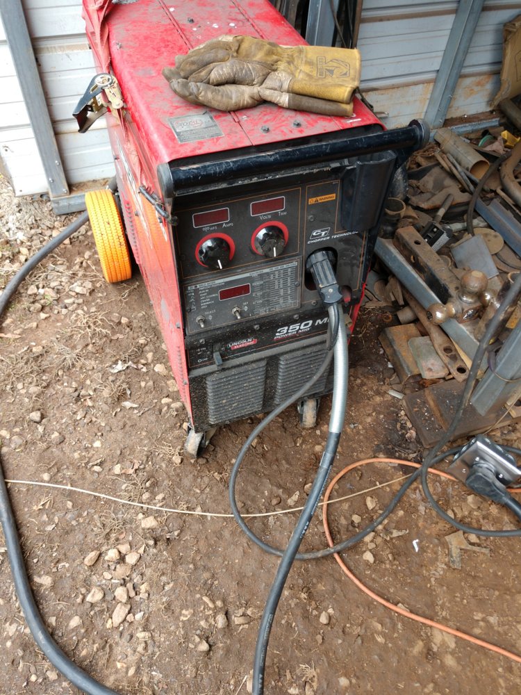

Well I got blessed with this monster machine. This thing is a beast. Little complex to fine tune but playing with the settings I'm getting there.

That is an exceptional machine. If you ever want to sell let me know. I’ve ran miles of wire through those.
Good find.
There are two short circuit mig settings.
One is CV, the other CC. Learn how to use each for different things and it will make you very happy.

yeah i'm trying to figure it all out with the manual. I'm not good at reading and all the terms but I'll get it lol. how nice it is to have a 15ft lead too unlike the crap 6 footer on the 110s that you get lol.

Setting 11 or setting 5. Very different setups.
Screw the manual, just choose each setting and then try it out, adjust knobs & note the changes.
One of the coolest things I did, was get the amperage around 105, then turn the wfs down to slow everything down.
Allowed me to make much slower, more easily controlled welds on critical items, without sacrificing my amperage below 100.
There were on welds that I was testing to verify parameters, so everything was destructive tested to aws d1.1/api 1104.
It’s been a few years, but IIRC, welded sch 80 6” pipe, settings were around 100-105 amps, volts @ 17.5, wfs 175-180 with .035” solid. 75/25 mix. Pipe was beveled, gapped, tacked. Welded with 1 root, 1 hot, and 3 stringer cover passes.
Passed visual, and bend testing and was flawless.
Not saying that’s the end all setup, I was just pushing the machine and settings to see what all I could do, with settings not in “normal” range, and still execute a solid weld with results that meet code.
I did around 50 of these tests with different machine settings just to test theory and confirm/deny suspicions.
With that said, I am a very competent welder behind the hood, and know the shortcomings of short circuit mig, and know what to look for, look out for, and avoid.
I don’t mean that as tooting my own horn, just mean it as, I have countless hours of shield time in a controlled environment destructive testing each and every one of my welds/setup to reinforce what I’m doing right or wrong.
The settings won’t band aid poor technique.
The settings will allow you to tailor a good technique to how fast/slow you like to work, to allow you to execute the best weld you can.
Awesome machine for mig, short circuit or spray. Great for stick work as well, and scratch start TIG on steel.
Glad you pulled the trigger on one of these!!!

thank you very much for the advise...especially since yeah the manual is bunch of mumble jumble to me lol. I'll try and play with those setting you mentioned ..got me exited now. I had it going descent but couldn't get amps/volts to match wire speed so it was burning great but wire speed wasn't what I wanted. I'll keep playing with it now that I know where to start.
