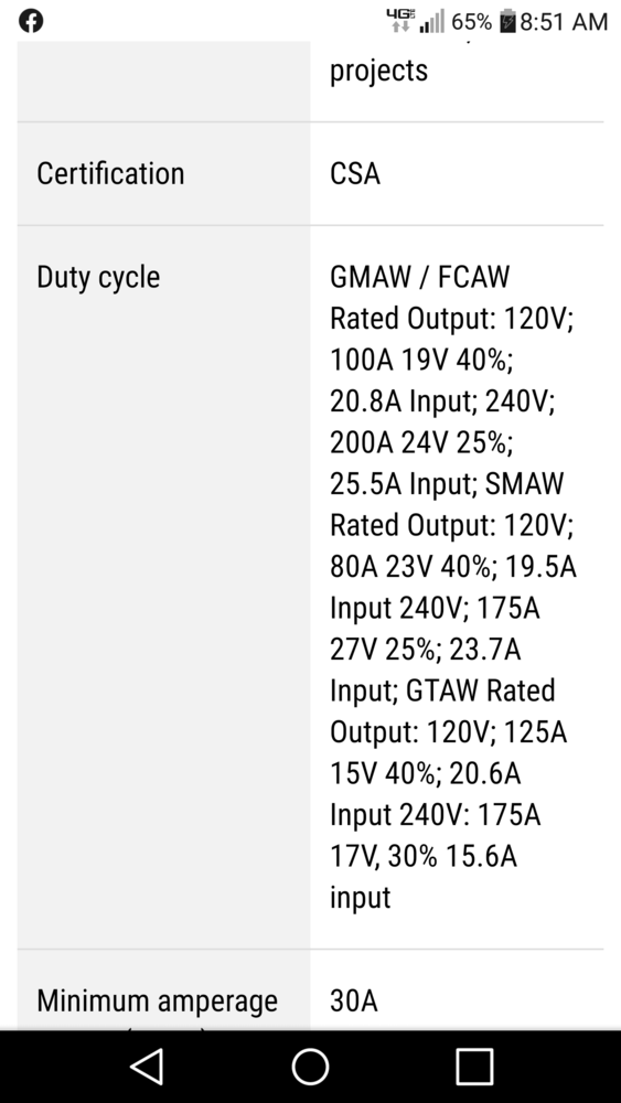

These are the important numbers. Also proves the duty cycle is for hobby use at best.
Yes, it does not have high frequency. I disagree with hobby use. I have welded with it all day long and not had any issues. Online reviews are great. One review a guy just runs beads for an extended time and cannot get it to shut down. Runs it for 30 min non stop if I recall correctly. Is it a professional machine for nonstop welding for hours no. Is it capable of welding axles and cages where you are not welding beads non stop for hours in my opinion definitely. Had several people use my machine that are good welders and they all like it as well. Also have used the Lincoln MP210 and it is a nice welder as well basically same specs as the Omni and welds just as nice. For cost and warranty I would go the omnipro hand downs. At least when I bought mine for $50 or so you could add a 3 year unconditional warranty to it.

Gmaw 19 volts at 40%. Since it requires dang near all that output for short circuit with
.035 wire is say she's pretty part time. 4 minutes of good output out of ten.
Of course lighter wire will run at lower settings with a bit better duty cycle. Anything heavier then 11ga. For an extended period running high quality beads without large puddle manipulation will be a struggle.

For the record John I've saw your abilities and bragging about the chances to use a real machine. And your welds appeared to be wholey better.....don't cheat yourself with a half assed investment. Get machine meant to work as hard as you talk about being able to do. Or buy a toy and learn to only make sparks at less than half the capacity as a dedicated machine.
