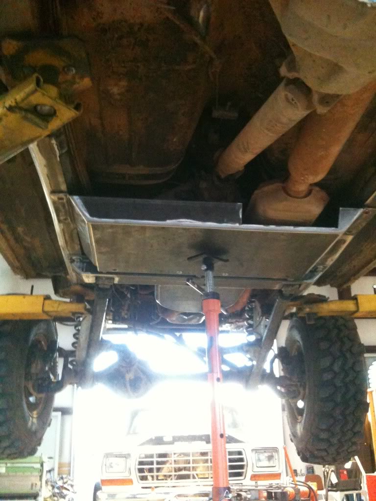

What color should I paint my skid plate?

To ask, what do I use to clean bare metal for paint prep?
Soap and water? or something "stronger" like MEK or similar?
I like it. I painted all mine black too.
Just spray brake cleaner on it and let it dry and it's ready?
spray w/ brake clean or carb cleaner, then wipe down w/ a rag so it is clean and dry.
Water is ok if it is reeaally dirty and you need to get a tpo layer of grime off first, but not so much for the final prep.
And remember, several thin layers > 1-2 thick ones
Like Rat Lab said,
Spray it on and wipe it down, It drys fast after you wipe it down. Cleans any oil or grease residue off of it.
yeah - oil and grease residue are really your biggest problems.
Although lets be honest, a well-used skid is gonna need repainting soon anyway.
That skid looks almost identical to the one on my XJ that MarsFab made for me.
Mmm...79 Ford in the background...info?
