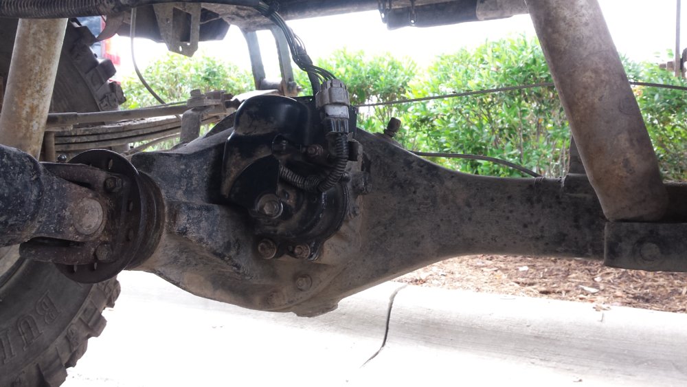

Thought I broke a hub, turns out was a hub and stub shaft. Time for drive flanges and 35 spline stub shaft upgrade.

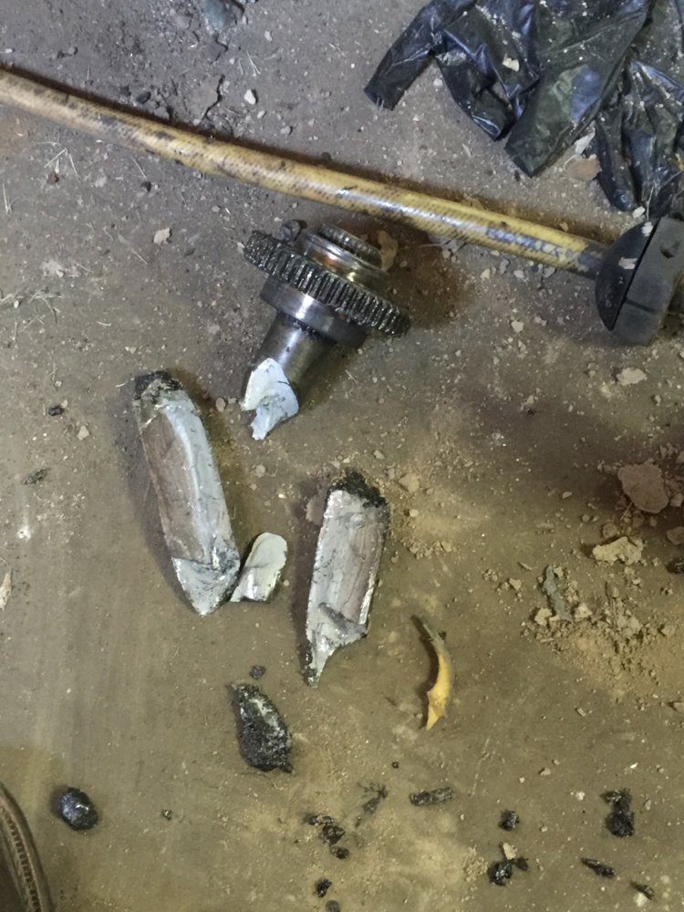

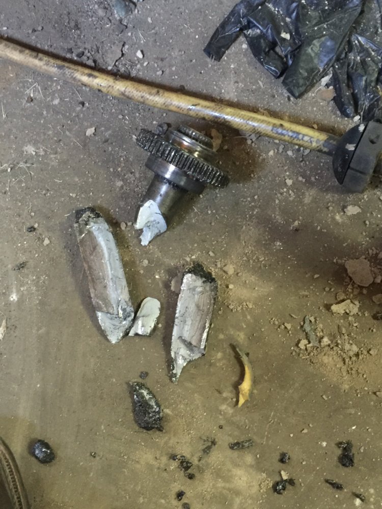

Hope that spare case works out for you.Finally tore my 231 down to reseal it. Soon as I cracked the case it had plastic bits everywhere and some aluminum flakes. Turns out the shifter pads were basically gone and the shift gear for hi-lo started eating the shift fork. Good thing I have a spare case.![]()

It will, not a direct swap so just using it for parts. The input shaft on yours is different in length than mine.Hope that spare case works out for you.
