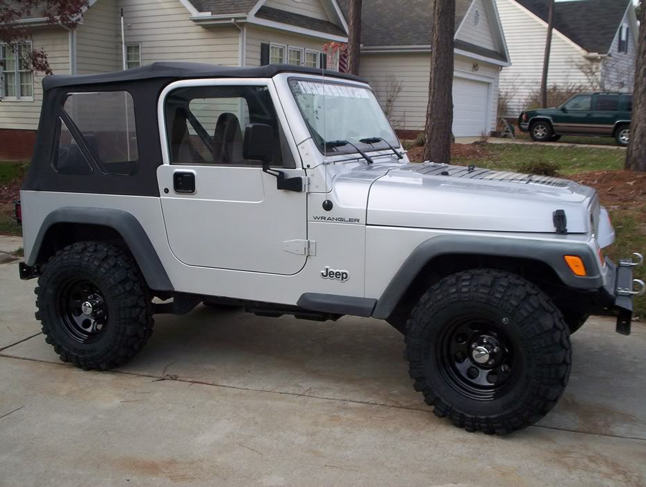

Here's a pic of 32's with no lift:

Way way way back when i had a TJ and it was stock i wheeled it for almost 2 years unlifted w/ 32 BFG ATs i had people tell me i couldn't do it even as they stood next to it...
The key is your rim offset. I was using the stock wheels and when the axles flexed (sway bars unhooked) it would just clear the flare and flex up under the flare perfectly..
In certain situations the tire would rub on top of the coils/shock mounts but just enough to rub the paint off. It would also rub some on the top of the fender again just barely.. It flexed enough to fully hit/use the bump stops so i was happy with that...
