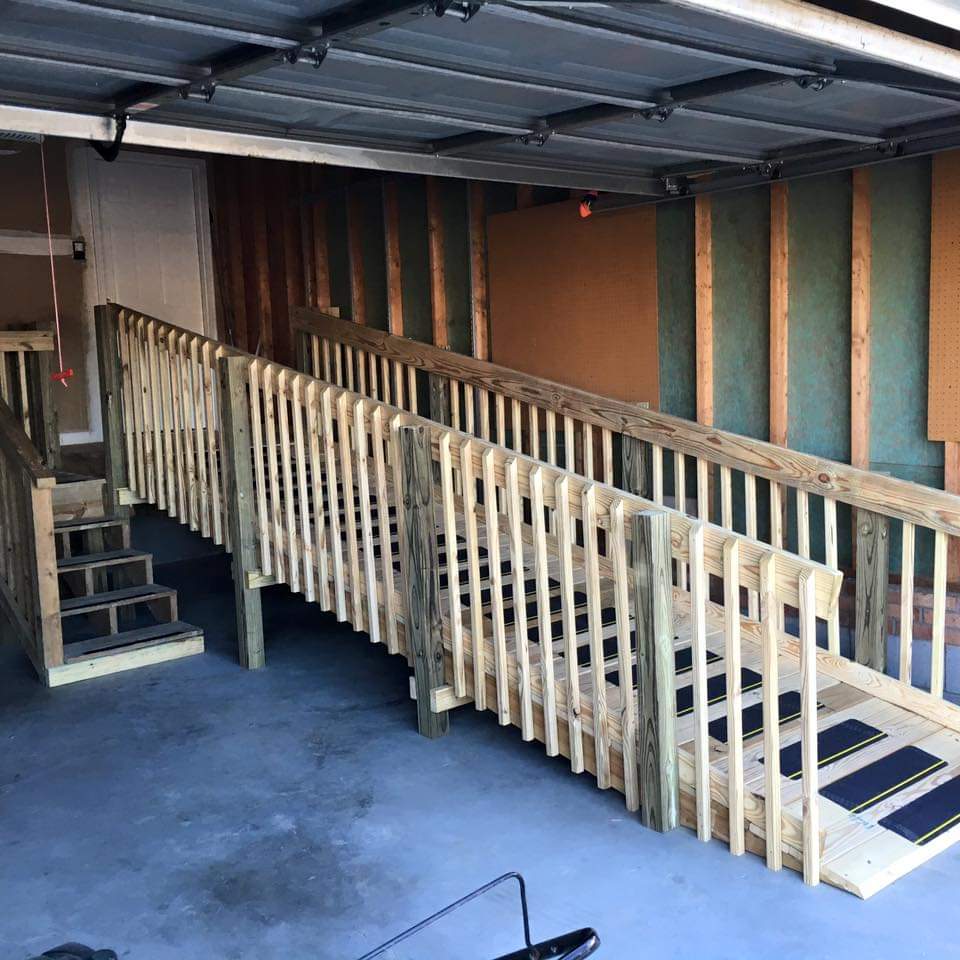

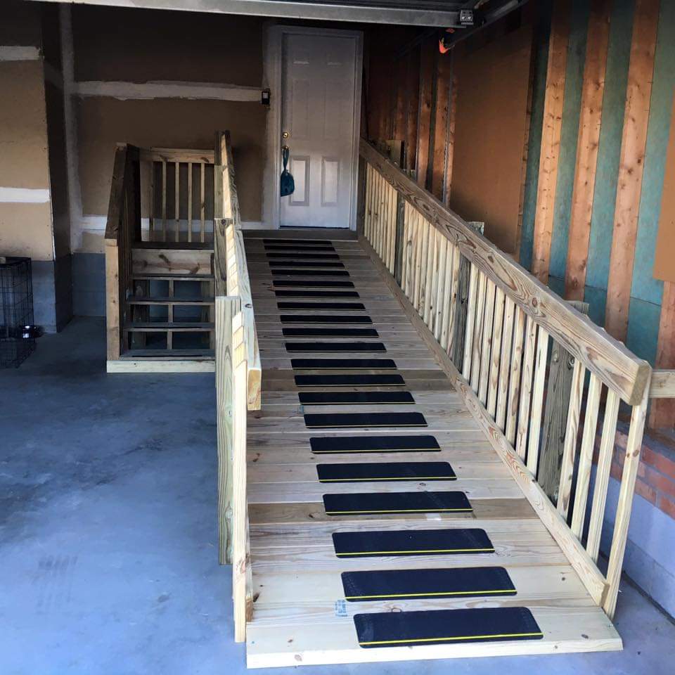

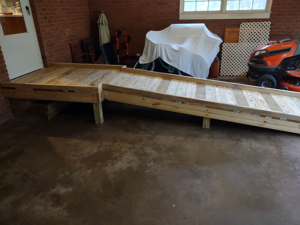

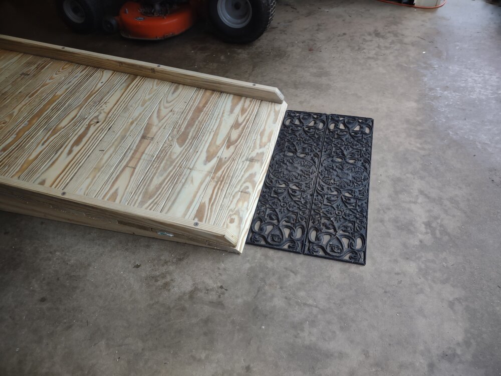

I built this one in Feb 2019 because my dad either had to use a walker, or sometimes have someone push him in a wheelchair, and he was getting worse. It covered 2 steps. I made it as long as I practically could within their garage, and it is steeper than what the ADA would recommend.
My dad passed away in May 2019, and my mom has kept the ramp ever since then. She won’t let me remove it - says it is easier for her than those few steps. So your mom may like to keep a ramp for a longer time than you’d expect.
Even tho this is steeper than ADA, my mom could push my dad up it in his wheelchair, no prob.

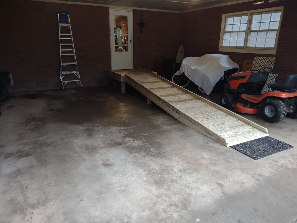

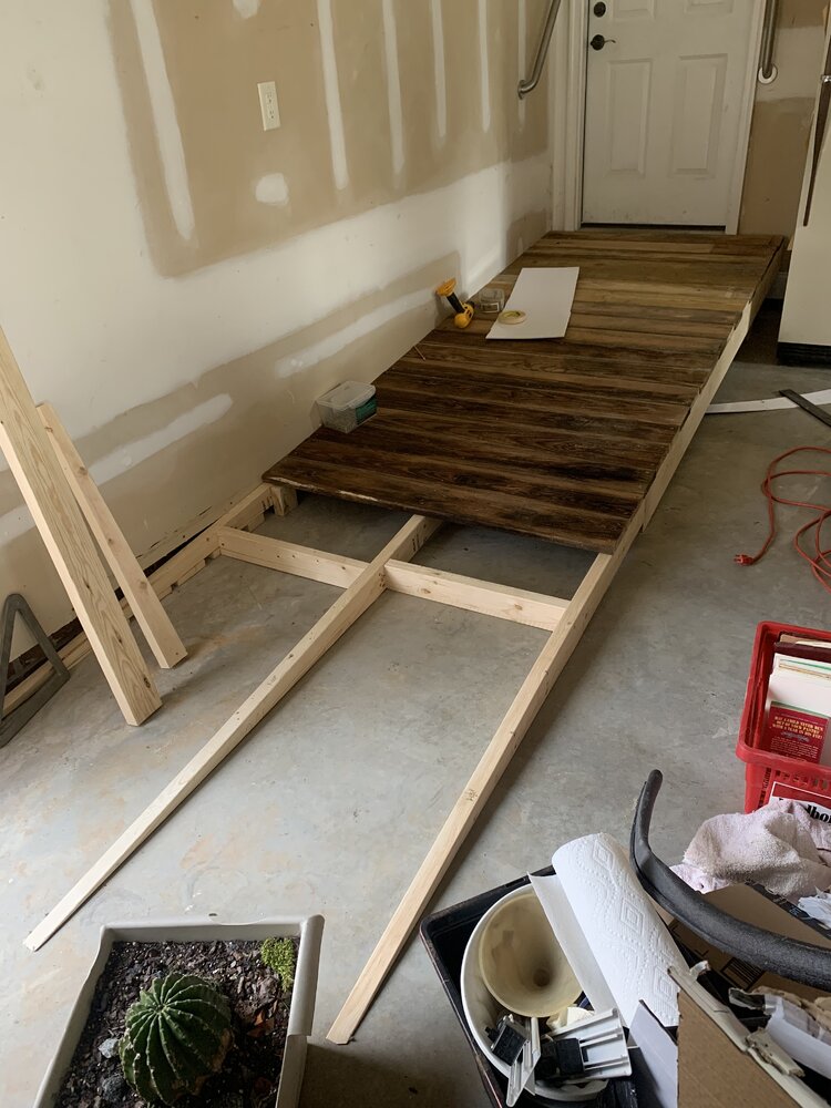

I made one like above but the landing was 4feet tall. Went all the way out to garage door.
Worked great with no issues
Something like this would cut down on how far it extends from the house ....

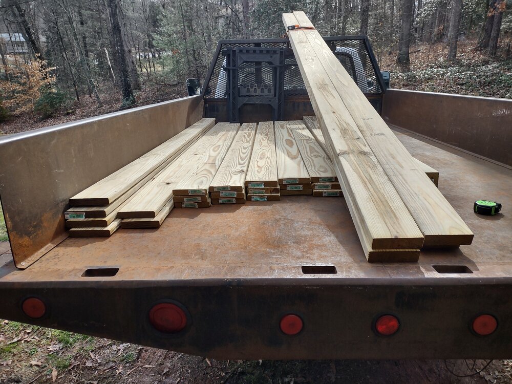

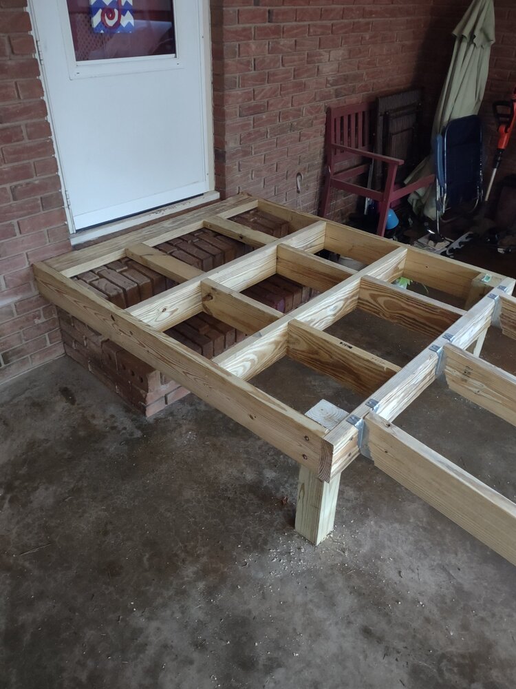

I have waffled back and forth over steel vs. wood after seeing all the damp water in the carport this week. I am leaning toward wood because of the ease of construction even though I'm a metal guy.
Thoughts included a landing and a run of 16 feet. I need to overcome about 22 inches of rise.
Now I typically build like a hurricane is coming.
Thoughts included this being the place any and all appliances or related get carted in and out of the need arises.
So band the landing and use 2 x 4 lumber throughout or 2 x 6 like a staircase landing?
Also for post 2 x 4 or 4 x 4.
Ramp will be hung with joist hangers at landing with vertical supports as needed.
Plywood for a surface is also not where my mind is headed. Thinking 5/4 decking and aluminum tread plate with grippy holes.
Worst case this thing lands in the woods somewhere to launch a bicycle or motorbike off off in the long future, lol!
We got several able bodied young folk and enough stubborn middle aged fellas to get it done
Too self: "Really you said that? What was you thinking? You know your gonna end up doing this solo?"🤣🙂

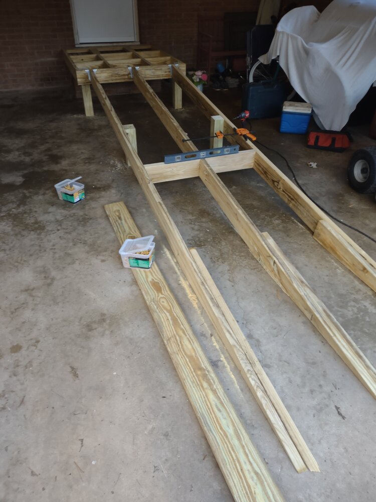

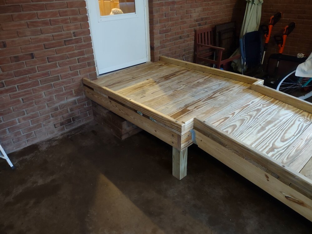

So I did my best carpenter imitation.
No electrodes burned....but I did manage to use a flap disk on a grinder once.
Family hasn't decided on the hand rail option yet. Gonna flag the let corner so it doesn't play tag with her truck. You can swing the driver doors open but the front passenger is a no go.
