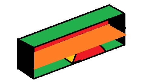

Now I comprehend the solution you are looking for.. a compact compartment to use presently unusable space, as opposed to creating a larger space for tool/parts storage. Likely easiest would be a bin with a hinged lid/front, with a bottom and access from above for the length of it, with fold down doors/drawers for space fore/aft of the well... Into mspaint cad (Computer Aiding Drawing...yeah..).. five minutes later I think this is what you are envisioning.... simplified a little bit, but you could do a bin type lid at the top and cabinet type doors under the shelf. Most likely it would be easiest to build it onto the truck permanently, and if you don't extend beyond the wheel well into the center, you won't really lose any space that wasn't really useable to begin with. if you do the top lid, then you could add dividers to customize how you want it..

Since this is custom, you could cut out the inner body wall and extend the box into the body shell and gain ~4" or whatever the depth of the body is behind the panel since you will be welding/riveting it in anyway so it won't be as if you were just cutting the panel out and not reinforcing it. just a thought.
