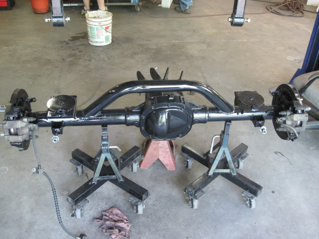

Here is the 8.8 all ready to bolt up

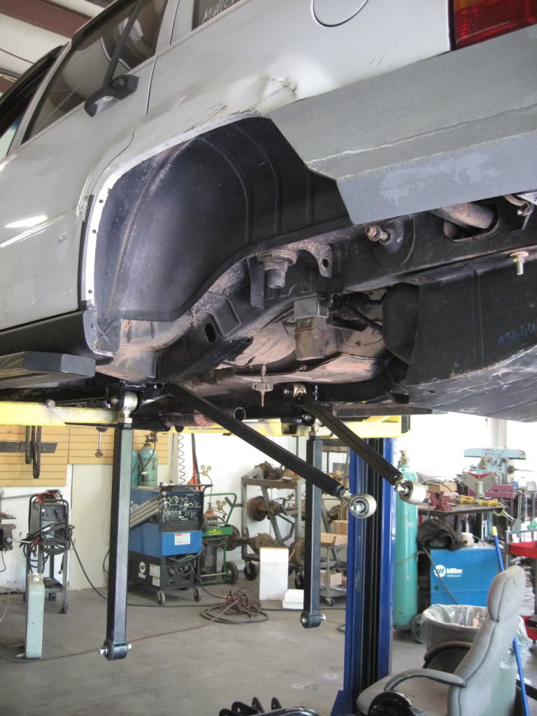

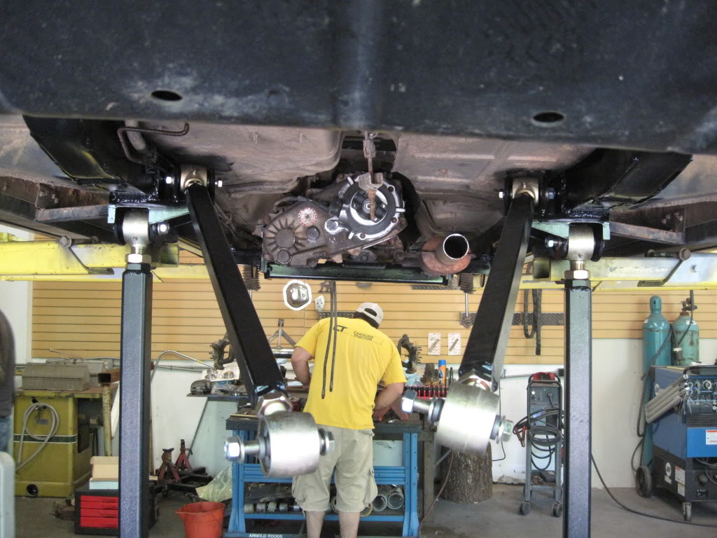

Here are a couple shots of the rear long arms

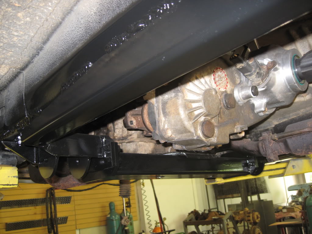

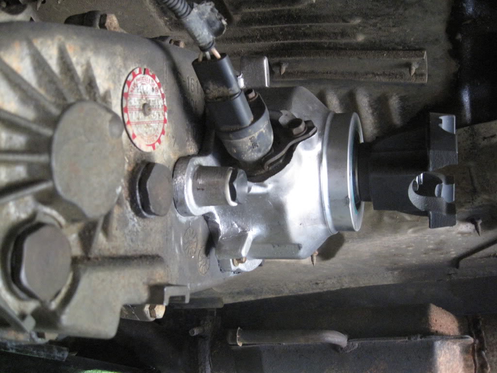

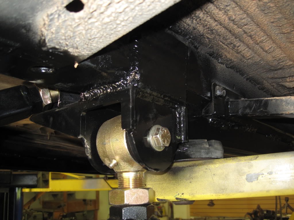

SYE bolted up
Clayton's rear triangulated shock mount

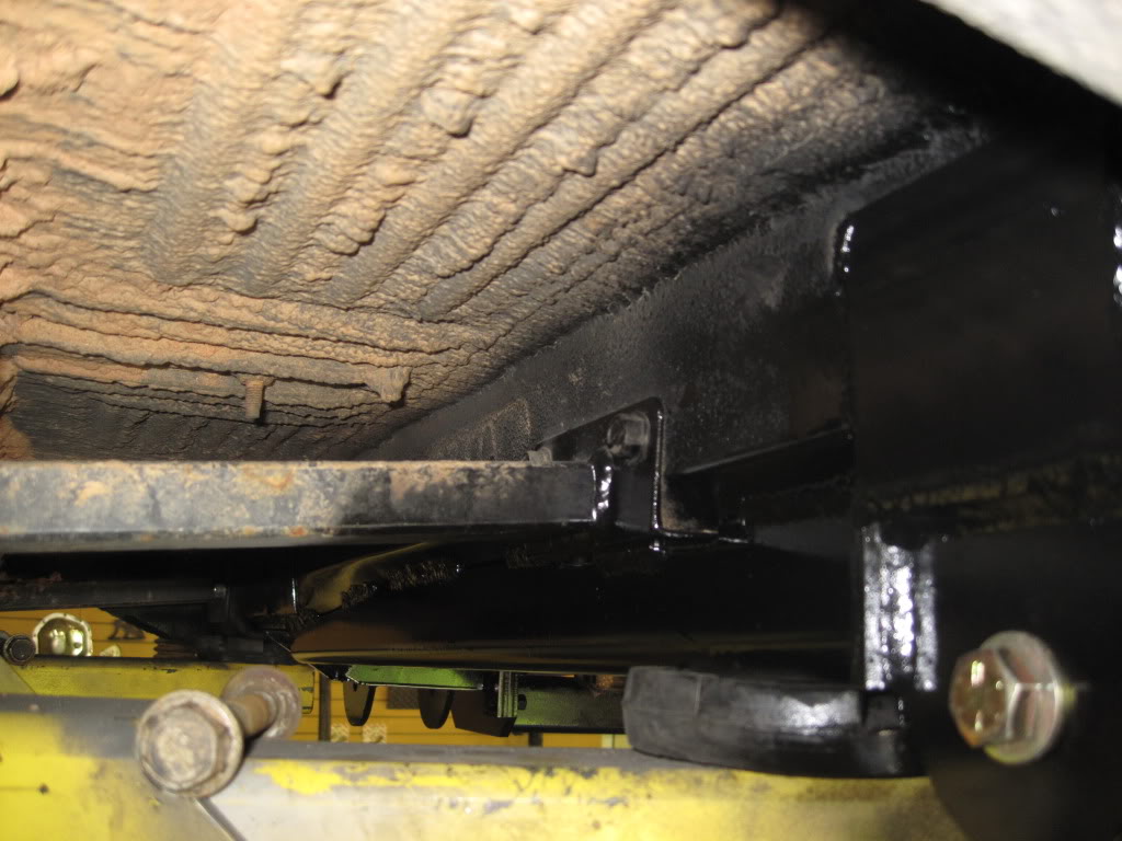

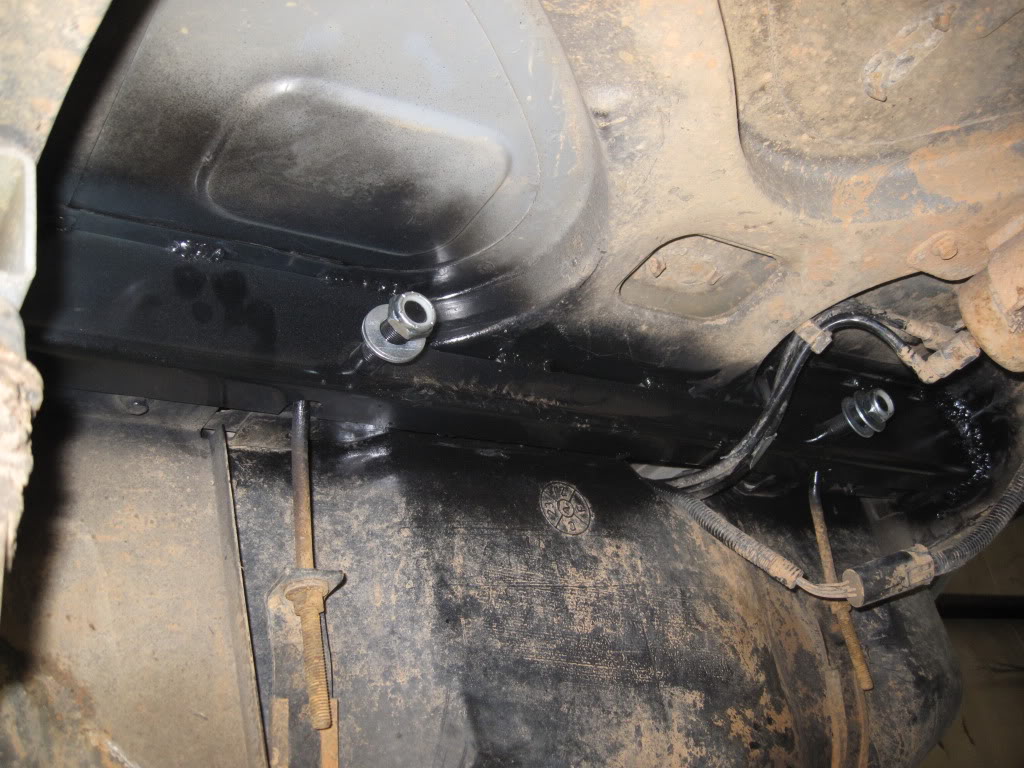

A couple shots of the unibody stiffiners welded up

progress is looking good Clay. let me know how those triangulated shocks work out for you
A lot of people love the triagulated shock setup mainly because it gets them out of harms way; but I will let you know what I think about them once I get the jeep on the trail.

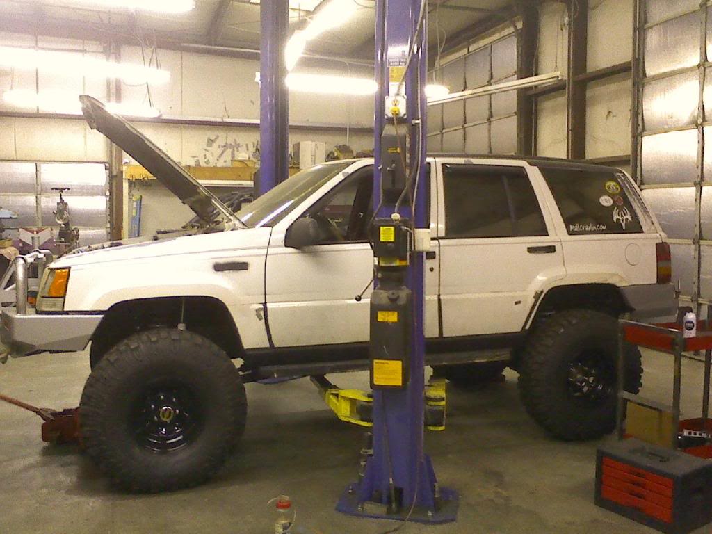

Talked to the guys last night, the jeep is now sitting on its axles! Just ordered the rear drive shaft, and the front is being lengthened right now.
Quick cell phone teaser pic. Should be driving her home this weekend.
