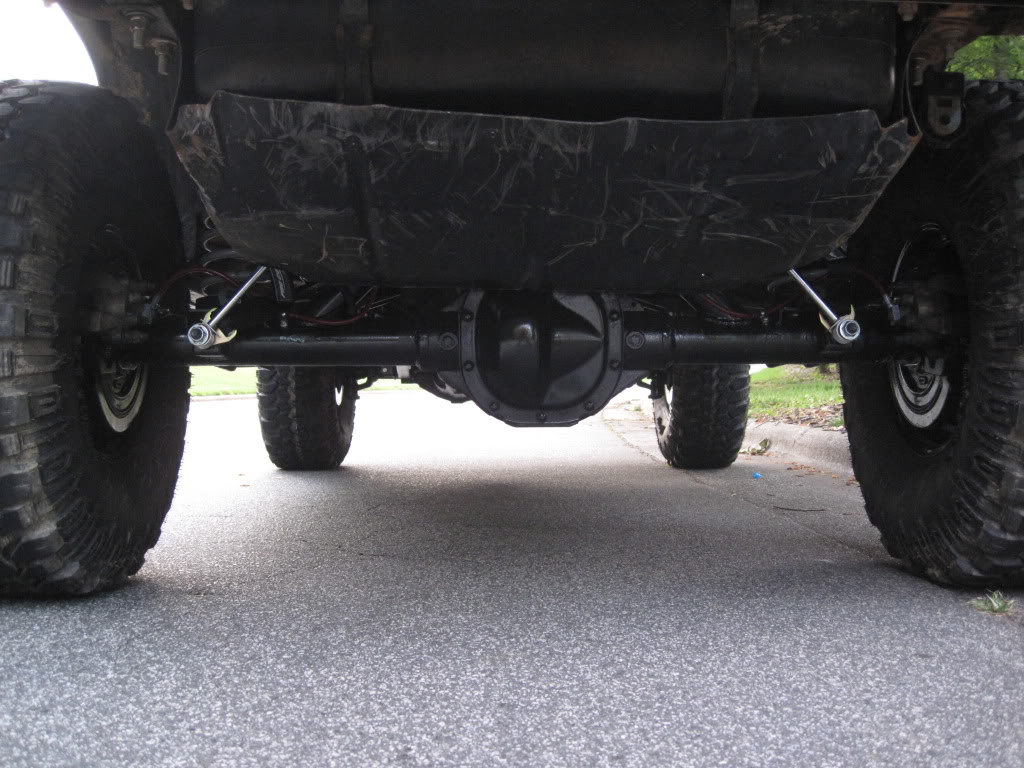

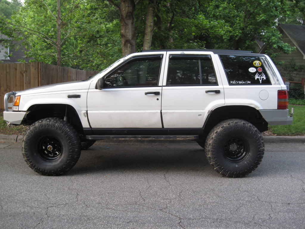

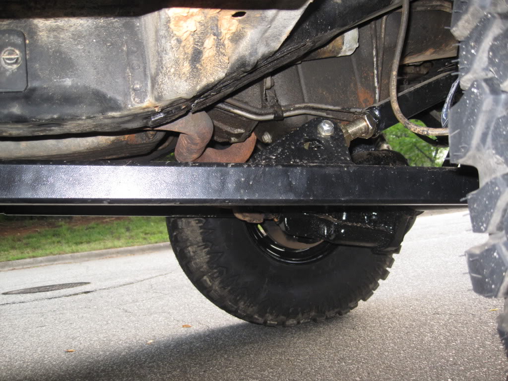

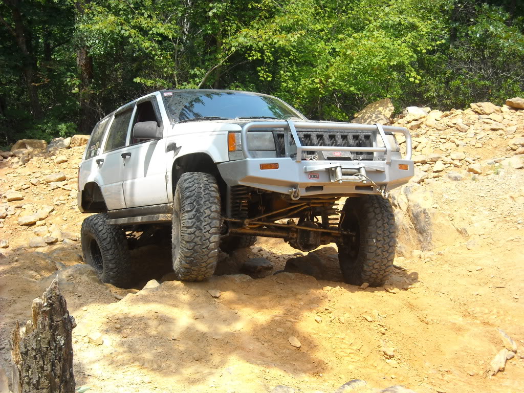

FINALLY, here is the brand new ZJ! :)

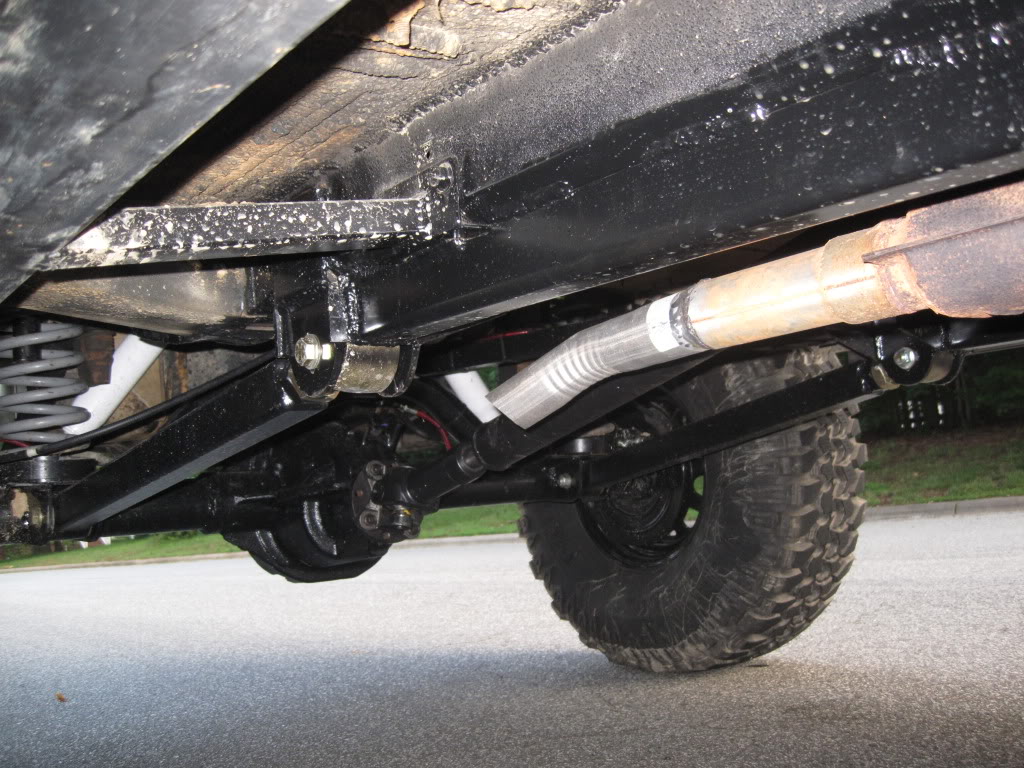

Specs:
- waggy 44 front, aussie locker, chromos, 300m joints, hydro assist, warn premium hubs
- explorer 8.8, aussie locker, dutchamn shafts with 6x5.5 bolt pattern to match the front
- Clayton long arm suspension with 4.5" RE springs
- Advance adapters SYE and Tom Woods rear drive shaft
- limit straps

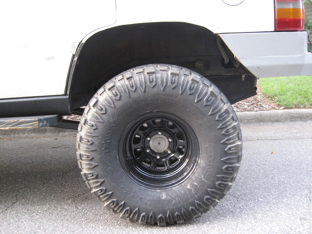

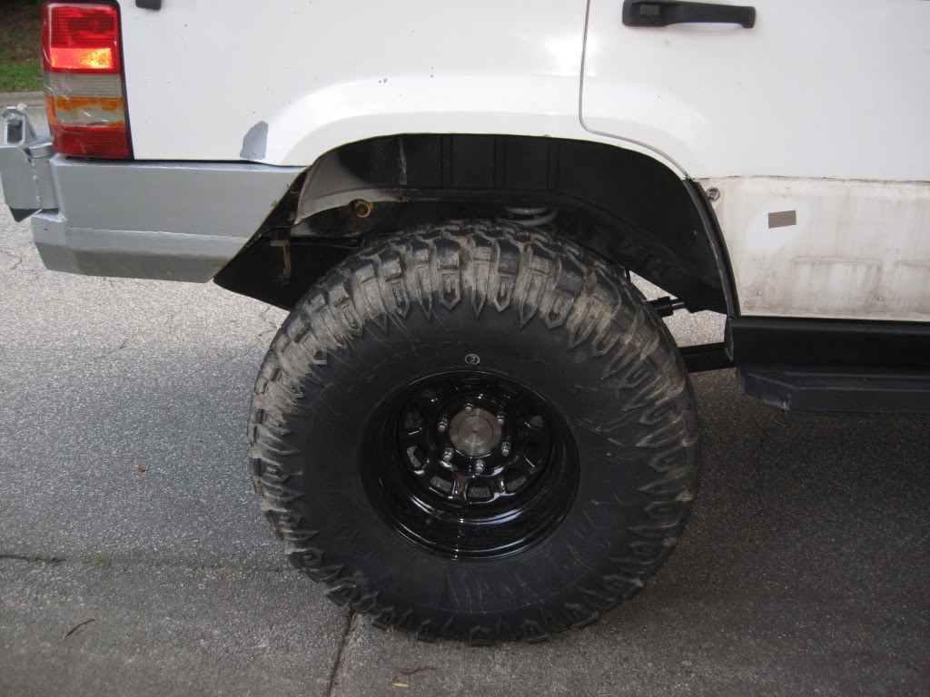

- 35" Trxus MTs on steel wheels with 2.5" of backspacing to clear the springs
On to the pictures:

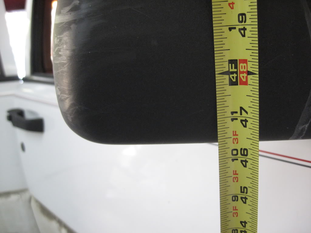

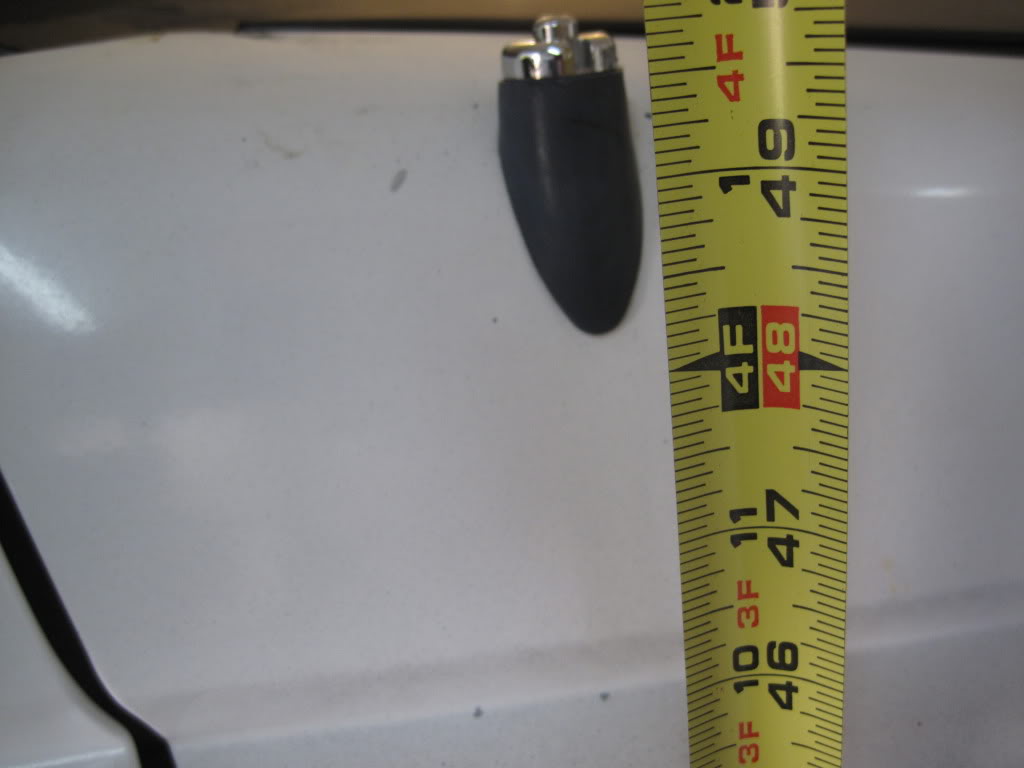

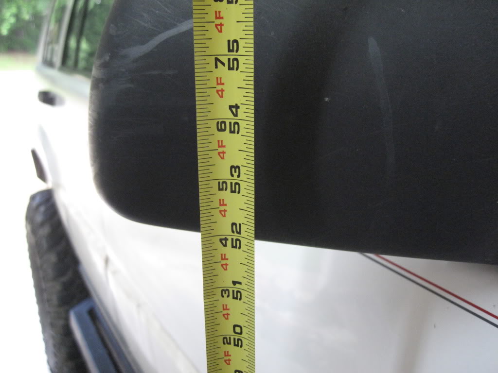

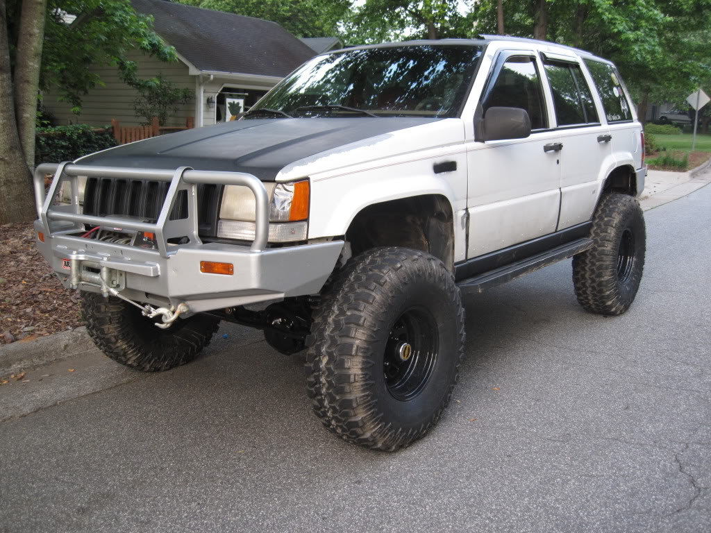

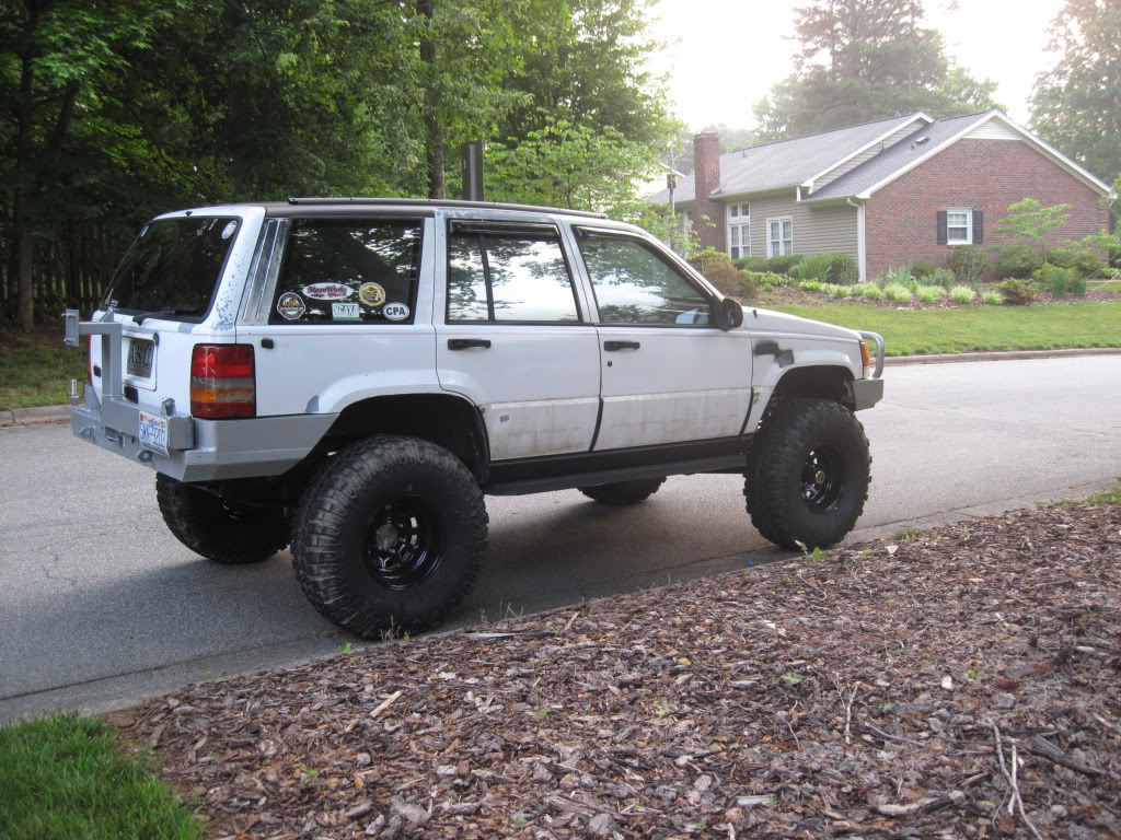

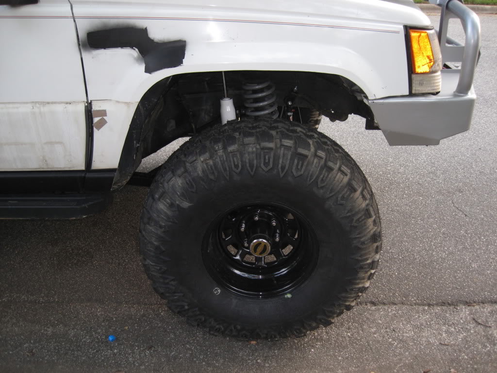

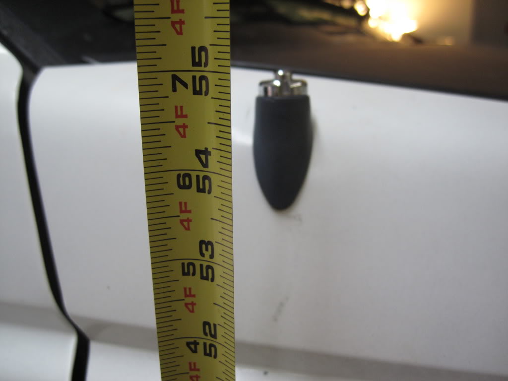

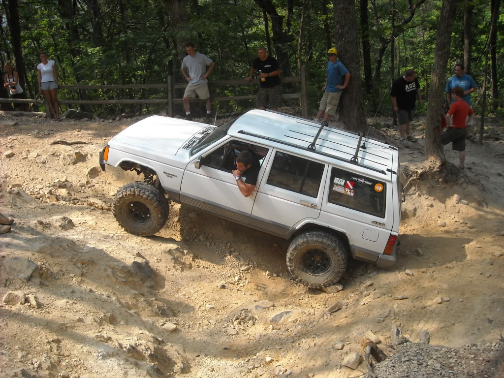

Well here are some before and after pictures showing the change in height.
Before
After
Before
After
Before
After

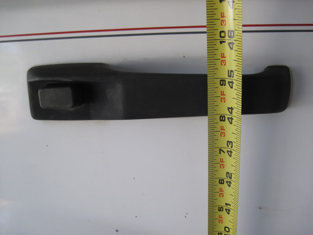

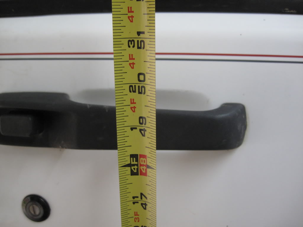

I took some measurements when I had the 1" OME lift on the ZJ and the middle of the door handle on the passenger side was 42" so a 7" increase over that lift/tire combo. Also an increase of 4.5" over the RE 3.5" superflex lift/tire combo.
Looking good! You need to have 5-7deg of castor for your jeep to ride right with that waggy dana 44. Does your steering wheel return to center at least?
The steering wheel does return to center.

I have put about 200 miles on it since the new install, next on the list is changing the diff fluid, putting on the new diff covers, then installing the power steering cooler. After that she is done for a while so I can actually get to enjoy her on the trail :D
Power steering cooler is installed; however, the ram has been taken off. I was having a horrible time keeping the jeep between the lines on the road. Took the ram off and had the tapped hole sin the steering box plugged, and the steering is great now.

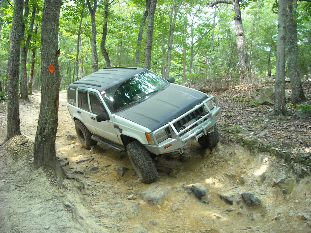

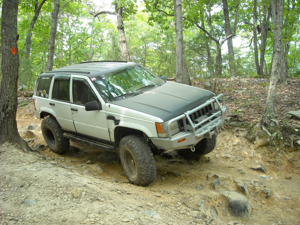

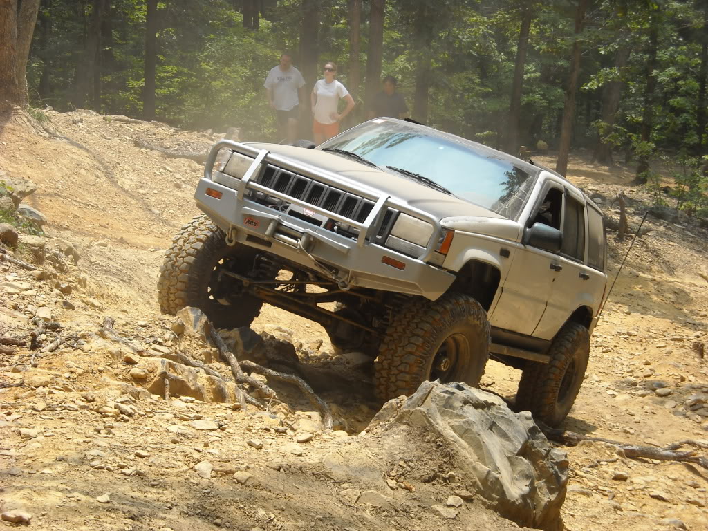

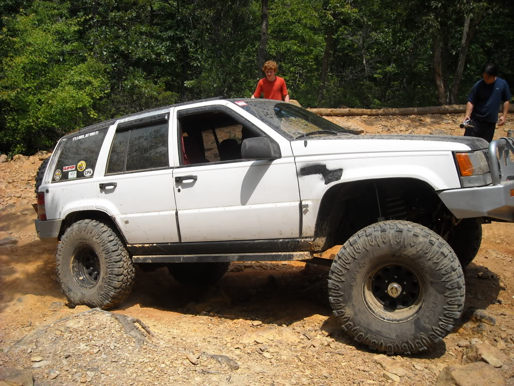

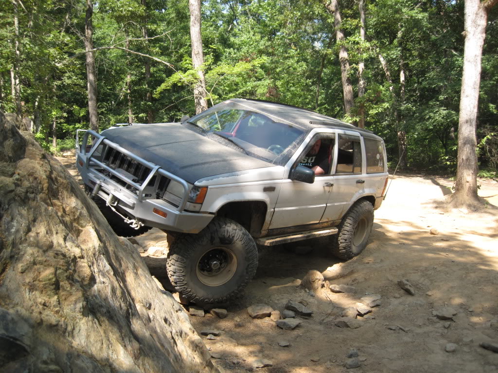

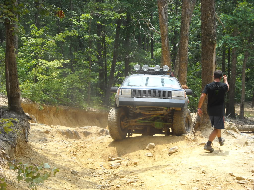

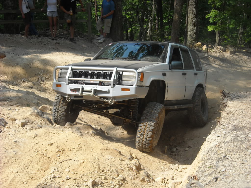

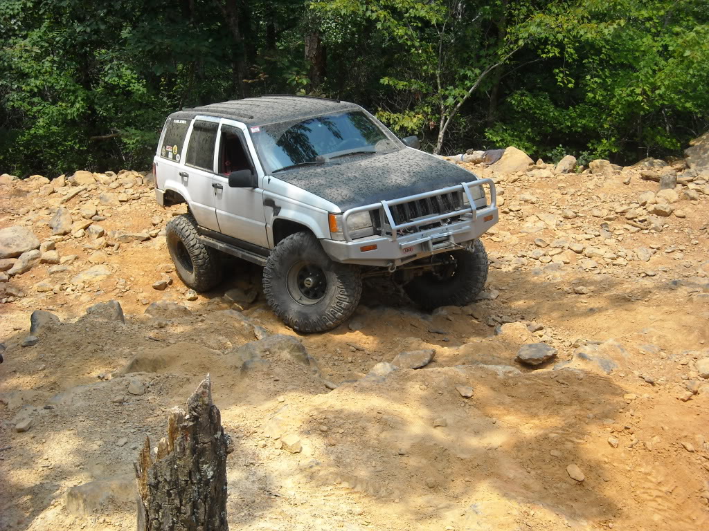

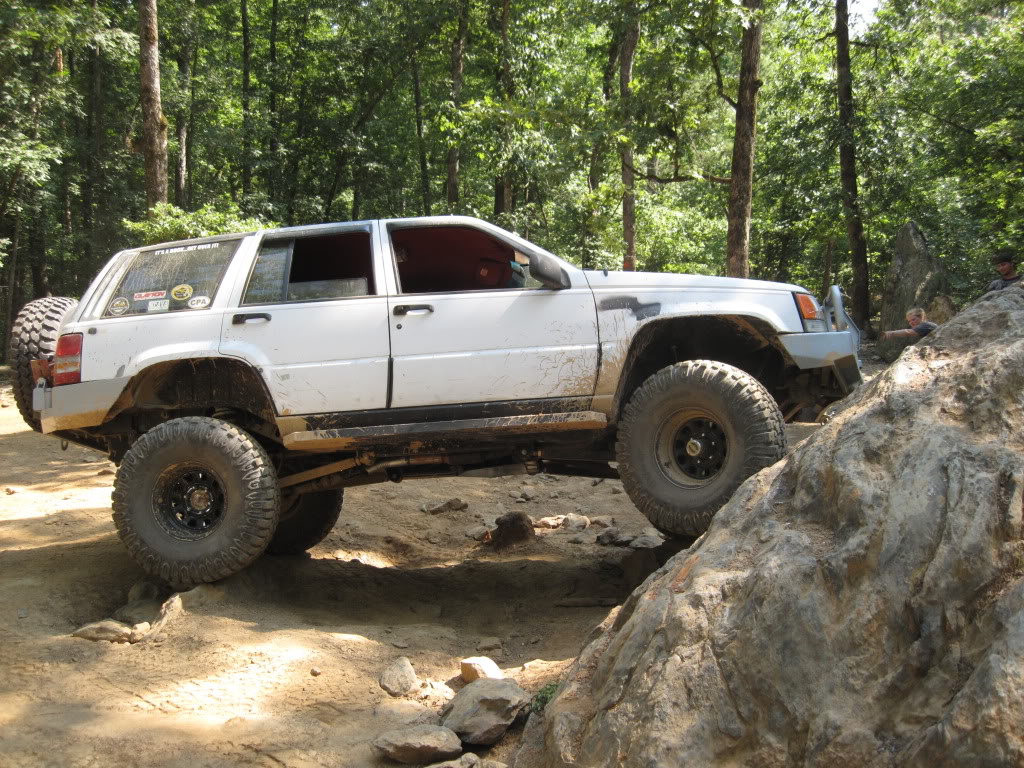

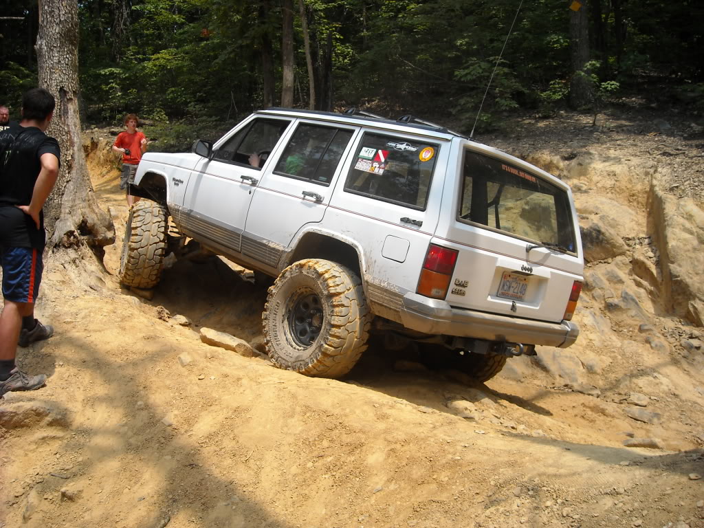

Went to URE today, the jeep is a beast! Have a real sqeaky front end when in 4wd and turning, going to have to figure that out.

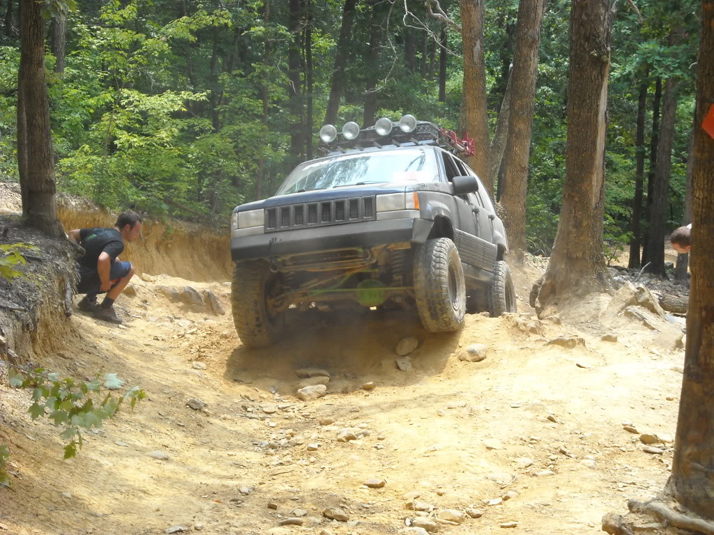

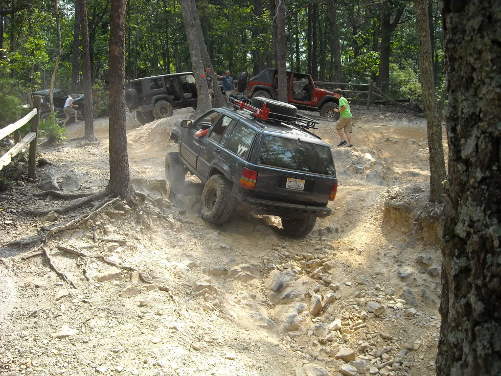

A few of 95GrandZJ and OleBlue

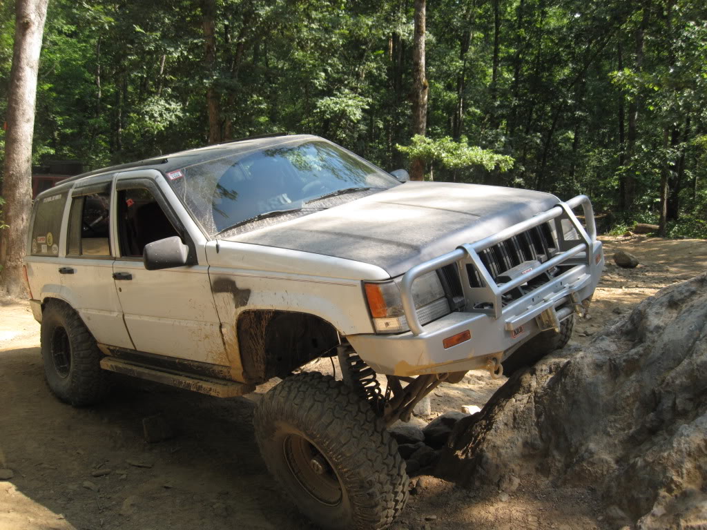

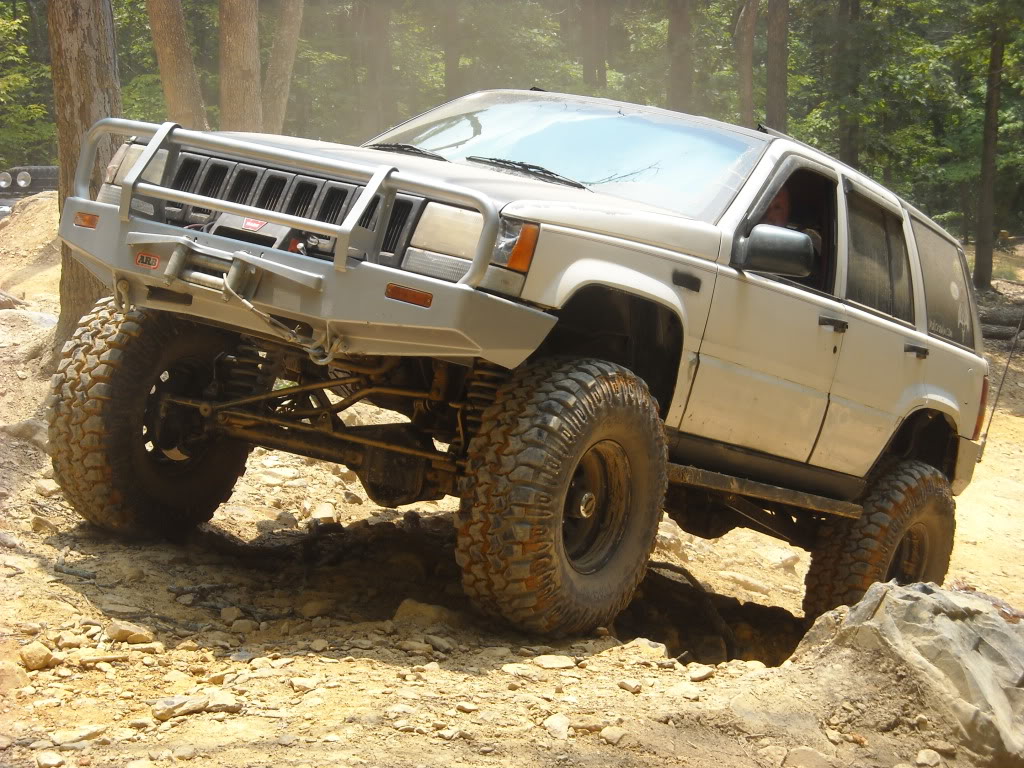

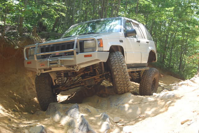

A few more from yesterday
Cleaning off the jeep today I notcied the passenger side is sagging a little. I am going to install some 1" spacers just on the pass side and see if that helps.

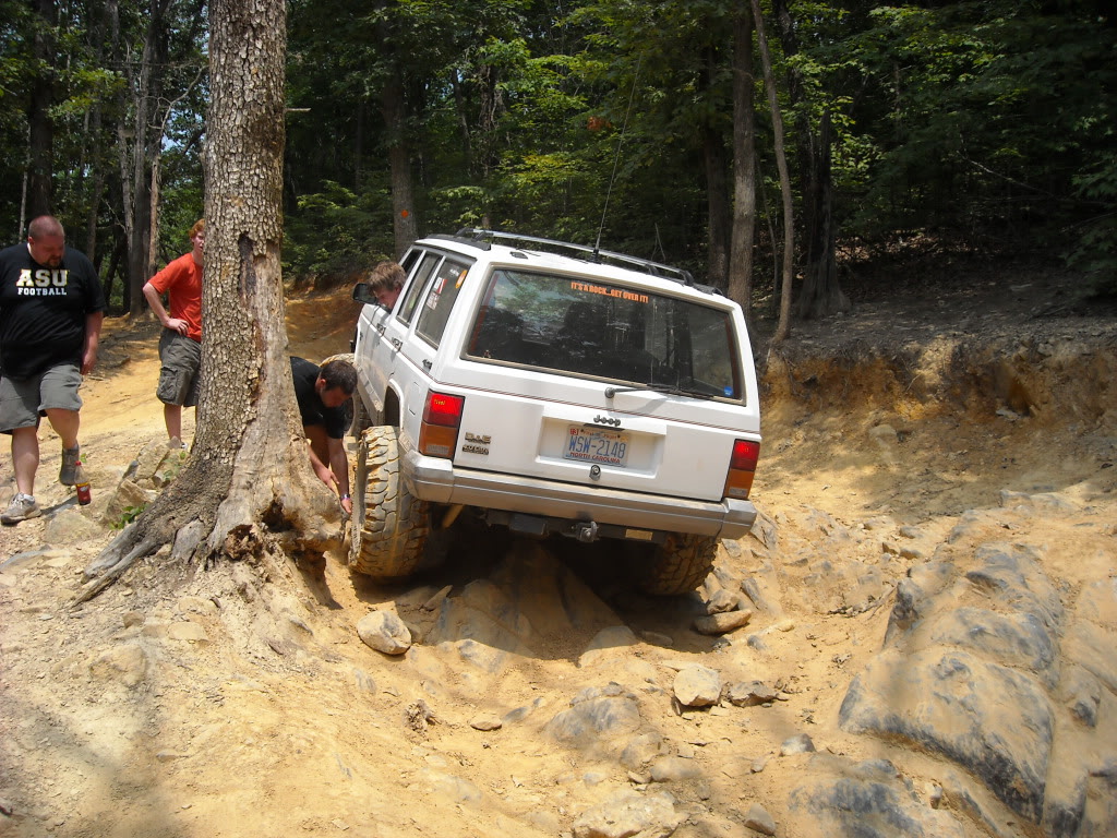

also your tires were rubbing in the wheel well pretty good...you may have not heard them since your windows were closed but i heard it. may want to experiment with flex and scope out any thing that sticks out and terminate it with an angle grinder.....give me a shout if you need any help
I love how you're "Apped out" in pretty every picture in the thread.
Yeah, when I was washing off the mud yesterday, I noticed I was really hitting the rear pass tire as well.
When you saw me on the side of the road as we were leaving, I was re-connecting my sway bars, but I had to adjust the driver side down about an inch and a half. I was puzzled, but then I saw the lean, so I guess the jeep settled to the passenger side.
