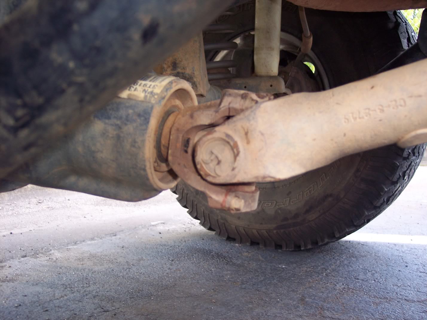

I think were all arguing here about different stuff, When Chris said that the lift didn't change the proper angle at the front u joint he was correct due to his adjustable arm. He has reset the pinion angle at the front to were it was at stock or at least pretty dang close to it, so the arguement from the dealer saying that the angle causing the ujoint failure at the front axle is incorrect in that sense. Yes the angle at the Tcase front and rear have changed, but the angle at the front axle has not due to his adjustable arms being set in the proper angle, thus being no different from stock.
depends on what you think is the proper angle, if he used his arms to adjust caster properly after a lift, then his ujoint WILL see a different angle, since the pinion is at the approximately the same angle as before
if he used his adjustable arms to set pinion to driveshaft angle to pre-lift specs by adding more pinion angle until they lined up, i would hate to see what his caster numbers are, and i hope that this isnt the criteria he used to adjust them?

i agree completely, that is what i was pointing out, that it was kinda stupid for jrraw to be saying that the angle hadnt changed, as he was claiming the adjustable arms solved the problem, but i showed him the two possible situations, and the arms didnt completely solve either
i took the u joint out and the bearings have a lot of grit in them, therefore the cause of the failure was grit getting into the bearings, not the angle of the drive shaft.

Umm don't know how I coulda been more clear man :flipoff2: Nah lol, I was just sayin the angle at the axle, or pinion, wont change if you were to set the adjustable arms at the right setting to make it the same as the stock angle. Never said anything bout the caster. Yea that will throw your caster off a little bit but thats not what failed it was the ujoint so I was just sayin that if you were to set your arms to make the ujoint or angle that the axle points at the tcase to be the same than nah it hasnt changed from stock. And i'm just refering to the angle factor, not the other factors that could have caused u joint failure like larger tire, grit in the u joint, etc.

If you move the axle away from the transfer case, you can adjust one angle, but not both. Mathematically impossible. (geometry)

without cutting and turning knuckles, he could have either set the caster properly and had a bad pinion angle, causing the ujoint to fail, or he could have set the pinion angle correctly and had the caster be way off, you cant have it both ways without cutting and turning, i have no idea what he did, but if i had to guess i would bet that the set the caster to make the car driveable and said forget about the pinion angle
either way, his setup WAS NOT the same as stock, and THIS HELPED LEAD TO THE JOINT PREMATURELY FAILING, maybe there was grit, but either way, i think everyone here knows that when you modify a new vehicle with a warranty, you are taking the risk that that warranty will be voided by the manufacturer, suck it up
ok look i have already had two different mechanics tell me that the u-joint did not fail because of the pinion angle.

Once again man, I think you are missing what I was saying, lol. You just repeated what I was saying again, lol. Yes you can set the angle at the axle (pinoin angle) but you mess with the caster. Thats what I've been sayinag all along I was just saying it is possible to get the angle at the pinion back to stock I never said that it wouldnt affect the caster angle when you did that I was just saying the hypothetical situation that one might do that weather its bad or not.

:D what do yall think about this angle :D
