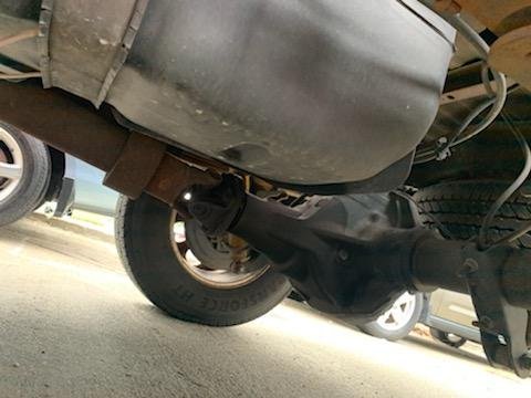

Love the vinyl floors. Also, I always look for a GN or 5th wheel connection in the bed when shopping used trucks. Not a instant no go but may give an idea to what it has done in a previous life.

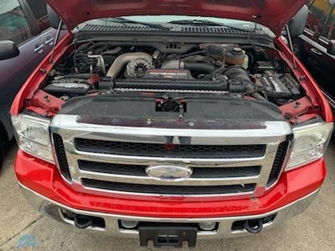

More photos for your inspection.
Sent from a device I own.
I was always concerned with one pulling a lot with GN or 5th wheel. My truck has a GN was owned by some sort of contractor at some point, figured it towed a lot but when I went to use the GN the flip ball had rusted in place and had to beat it out. Still had original grease dried up on it and the ball hadn’t even been used or didn’t show that it had, and it has now but I’ve only used the GN 5-6 times in 4 years

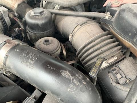

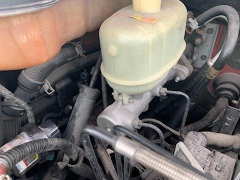

Now that it’s been pointed out, it does appear to have red overspray in the dense wells, on the brake master cylinder and in the intake boot. Def looks to have been painted recently.
