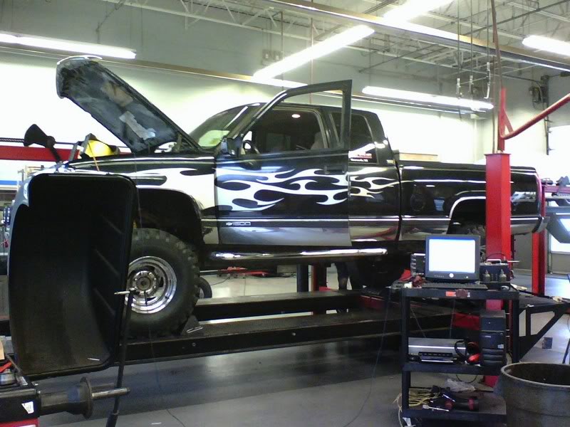

Yes this is at the rear wheels with those 36" hummer tires bent steel rims (yea I can watch them all wobble :shaking: ) 4.88's 14 bolt and a tranny that is bout shot runnin on lucas stop slip and the tc lockup doesn't work.

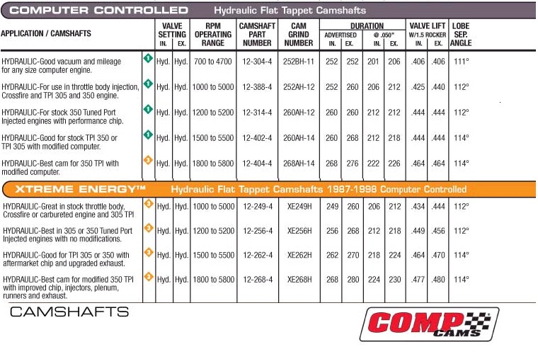

Cam I have is 12-402-4 from the chart below, and I have 1.6 roller rockers comes out to .473/.473 max vortec heads can take is .488 I think . . . . stock cam is 350/350 lift - very sucky

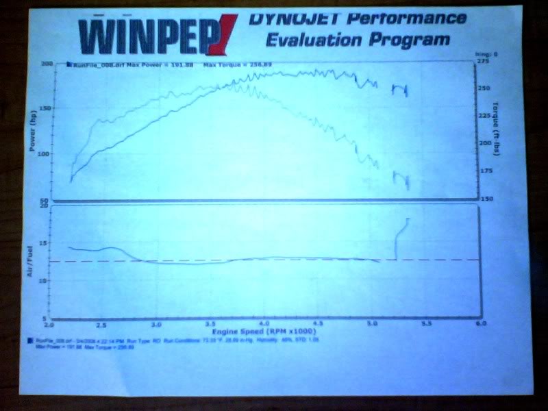

We dyno'd it like 7 times, the reason it was on there in the first place was to tune it, we never could get it right thou because we got what you see in the chart below everything running great but it wouldn't run like that on the road at all. I have to go Back again and try and get it tuned even they guy who does this everyday for a living can't figure out why it won't tune quite right. For some reason right at 2000 rpm's it stumbles(among other things but thats the main problem) unfortunatly 2000 rpm is right where most of the driving I do is. Plus I have no idea what the deal is with my tranny, if it were up to me I'd just throw the whole damn truck in the scrap pile, i made a guestimate from all the stuff I bought over the years pretty sure i've spent over 27,000 on this truck (6 years time)

and whats the story with the gap in the graph?

Wow your graph looks terrible. The graph should not be that rough, it should be a lot smoother ,what smoothing is the dyno graph set to? Your air/fuel looks pretty steady (except at the end of the run) so I bet the tranny issues you mentioned are causing a lot of the roughness and power loss. The gap in the curve is most likely slipping in the tranny ( the dyno has a coefficient of engine rpm / rear wheel speed if it gets too high is shows a gap since the drivetrain has slip).
It also appears they are using non corrected power numbers. If you want to compare numbers to anyone else or the factory use SAE corrected values to negate weather conditions.

the graph looks ok, but your air fuel ratio is trash. It leans way the hell outright at 2.5-3k RPM. Get that right and you will pick up some power.
IDK, the lockup used to be bad was locking/unlocking all the time so I replaced the Lockup solenoid and now it doesn't work at all.
The gap was random, it didn't happen on the last 6 pulls

smoothing was turned off, it was set to standard
haha, you should have seen it before, it was a huge hill lookin thing right there, then he turned the fuel spray all the way up to get it where it was, unfortunately it won't run on the road like that, at all.
Looks to me like it falls right on stoich at that range :confused:
