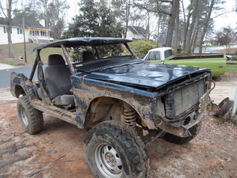

To start things off my friend gave me his trail beater so I could have something I could beat along the trails with. here are the spec's on it
3.54 axles welded front and rear "because open diff's and lockers are for wussies "
rear suspension bastard packs with shackles
Front suspension JK rear lowers with Rubicon express 6 inch spring and custom chassis mounts , boxed and welded uppers
Home brew steering and custom cage
How I got it pic's

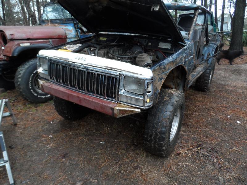

After building a bumper and picking up a header panel

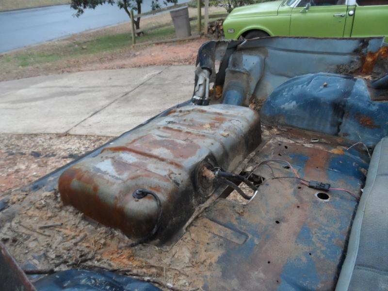

The best part of this build is so far I am in it for a valve cover gasket , battery terminal end and scrap steel I had laying around plus a trade of a free tire for a header panel. I did clean up the wiring to the back to only be for the fuel pump and I cleaned all of the mud out of it.

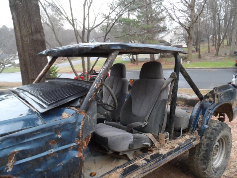

(whistle). That looks unsafe. Are you planning on adding to that cage?
I am planning some door bars but that cage is pretty strong and the body is ridged the cage drops 12 inches into the A pillar and is actually 2 CJ roll bar welded together. I will also add some more to the roof
