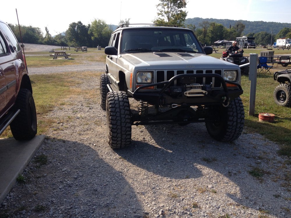

Living in SC I'm hoping either route I can keep tags on it. I know there is a lot of legal issues varying state to state on what I can drive down the street. Just like the legality of full hydro steering and beadlocks on the street. As it is now I drive the XJ to work once every two weeks or so and the rest of the time she sits waiting to go wheeling.
The biggest things holding me back from a full tube buggy is I havent found a truck yet to haul with yet. (Not for lack of looking) and I would have to start selling off parts off the XJ. Which would stop my wheeling for a good while. Picture is from Windrock last year.
