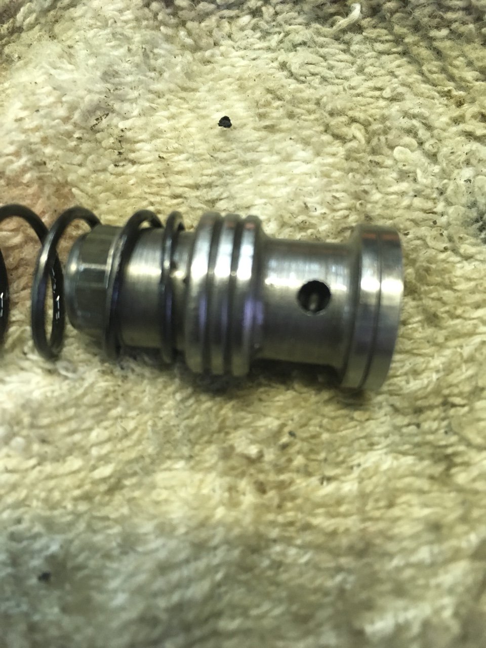

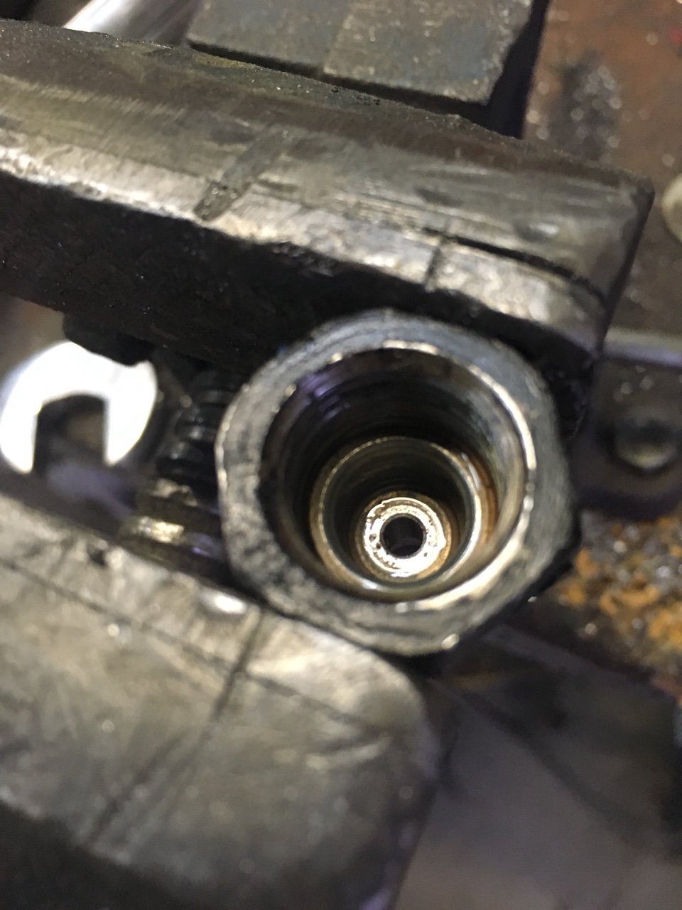

The Yjs use a regular saginaw pump right? If so, just pull the fitting, take all the shims out and drill the fitting orifice to 5/32" That will solve your issue. You shouldn't need to worry about a ported pump or anything crazy yet.
Yep just a regular remote reservoir TC pump. Same as krc, Psc, trail gear etc
Yeah, parts store rebuilders like to throw any relief valves they find lying around into the pumps. One will have no shims and a large orifice meant for hydroboost and the next will have 8 shims on the valve and an orifice that was dropped and run over by a forklift...
x2. I would check your current pump when you remove it. I bet that you can mod the valve to allow better flow and bypass pressure.
Having large diameter lines that are as straight as possible, throughout the system, will help keep the pressure and heat down, and flow up.
Factory pressure line to the box, 3/8 lines to the ram, 3/8 lines for return and coolers.
I’m going to compare both pumps when I take the current one off and before I install the acdelco.
My current pump orfice is 1/8” thinking of drilling to 3/16 and trying that just to note the difference.
I left the acdelco pump and underdrive pulley at home so I’ll check those out tomorrow.
Drill it to 1/4 and shim that spring with some washers. Plumb a gauge in line and bottom out your steering to see what it's relieving at. Add washers to achieve higher relief.
