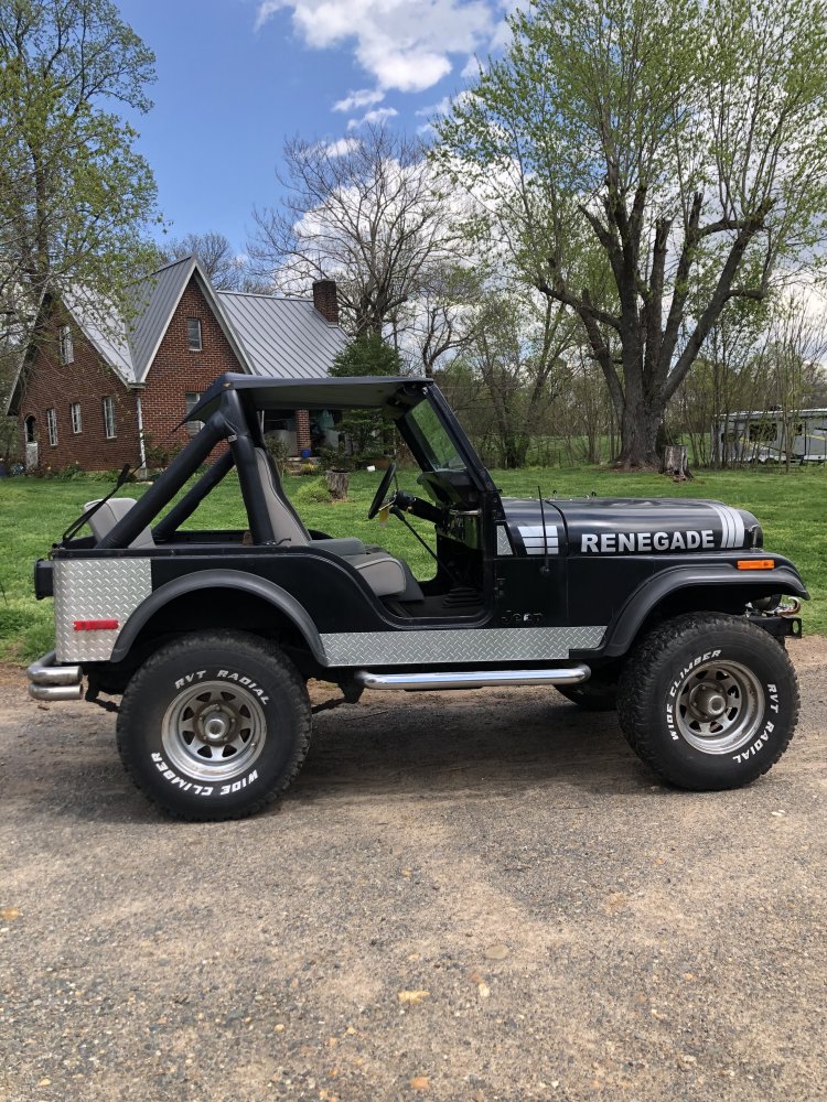

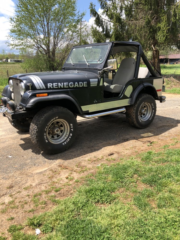

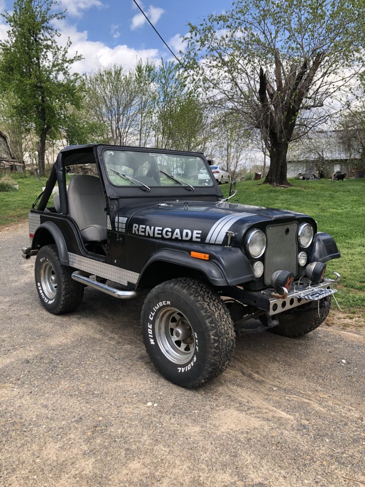

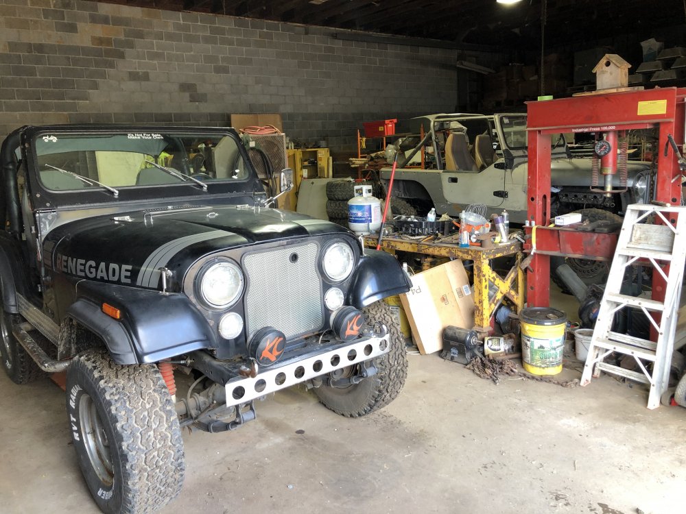

While waiting a long time for the Atlas for the CYJ, we stumbled upon this survivor of a 79 CJ5 at an auction this weekend after the machines we went to look at were shitbeat with absurd reserves. Long story short, like the machines, it had a Gas Monkey’ish reserve didn’t sell. I chatted up the owner for a bit and gave him my info and an offer. He slept on it and we brought it home Sunday.
Overall it’s a solid 10 footer. It’a got some rot in the rockers hidden by the diamond plate but the fenders and floors are pretty solid. The 258 runs well with just a small miss at idle and some smoking which has gotten better the more I’ve run it. Maybe valve stem seals. Maybe just needs to be run, we will see. It did sit for a while as the owner was “too fat to drive it” his words not mine. The gauges work intermittently, and based on the wiring mess behind the dash it’s expected.

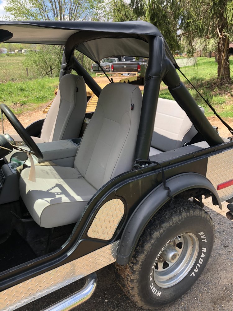

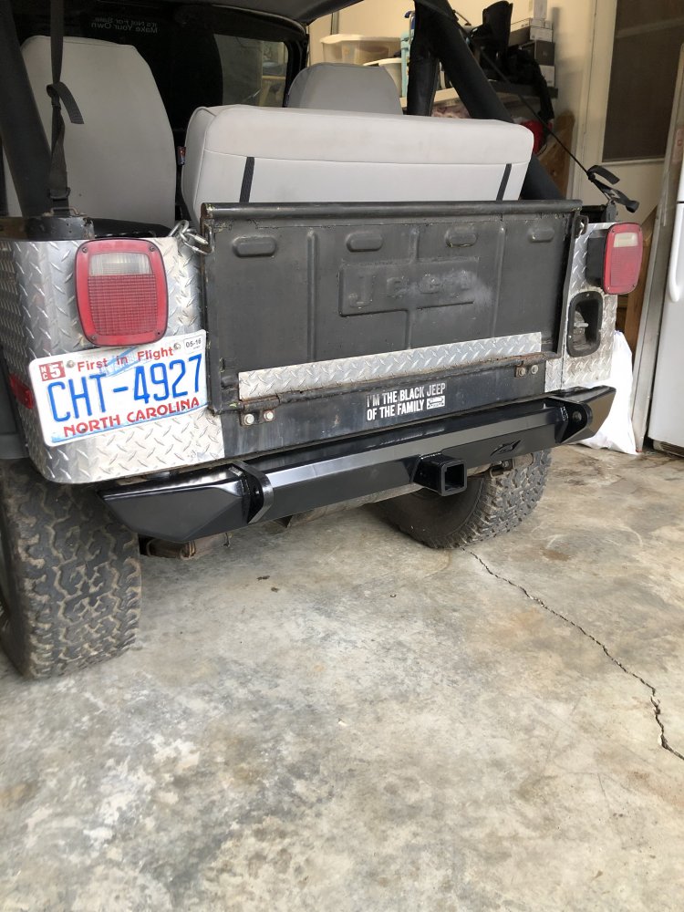

The interior is fairly new Rugged Ridge seats front and console that the PO installed. It had a very worn Besttop bikini top on it and a new one in the box in the back. The period correct chrome nerf bars were welded onto the frame. KC Daylighters don’t work but look cool. Front bumper was poorly trimmed down with a cutoff wheel and the chrome tube rear bumper is flaking and rusting a bit. The diamond plate is all held on with self tappers and all seems to be homemade.
It’s lifted a bit but we can’t find any markings on the springs to tell what brand helping it clear the 32x11.50 DryRotAT’s with ease.

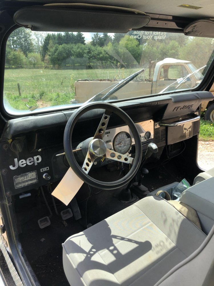

(1) Every gauge except the speedo is dead and even that one bounces around pretty inconsistently. Wires are all there and hooked up, sending units are there and I could not find any frayed wires causing a short or bad connection. Oil Pressure gauge is stuck around 20psi and doesn't move. The rest stay on 0.

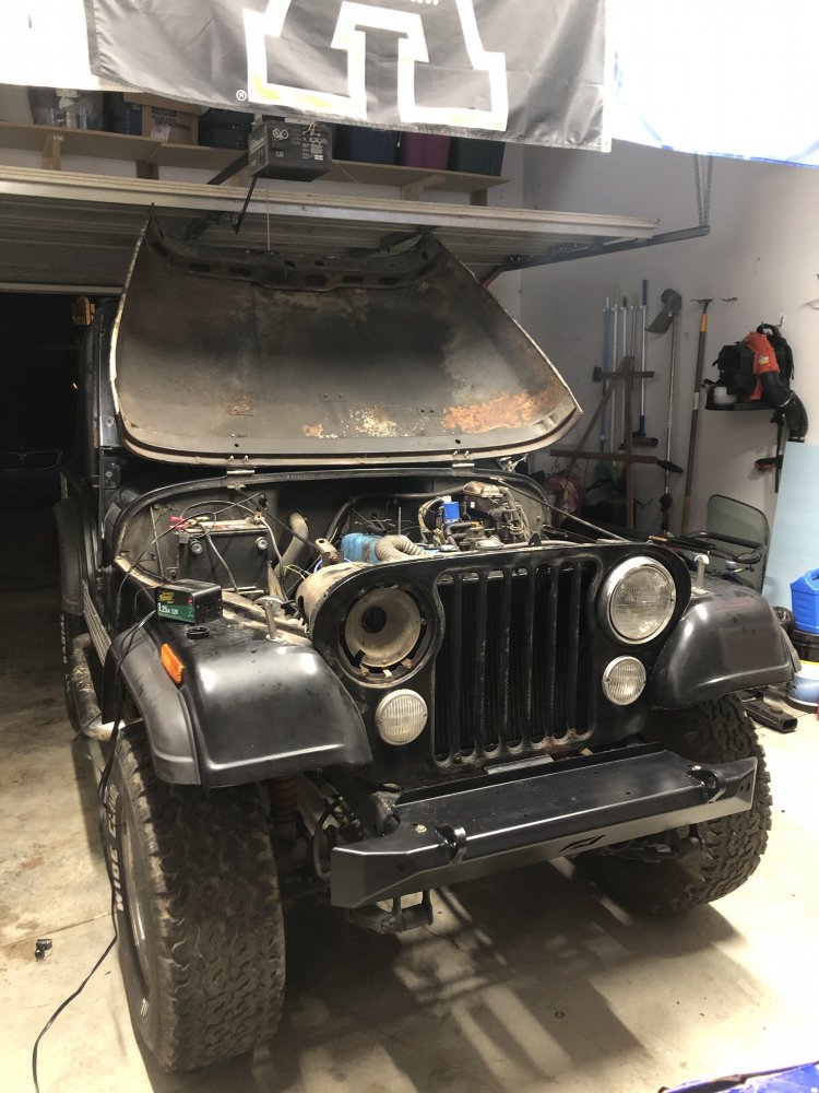

Big thanks to @tobaccoroad4wd for the loaner trailer this weekend to do some vehicle shuffling. Brought this one back to the house and got it in the garage last night. Should make a lot more progress not having to drive 2 hours to work on it.

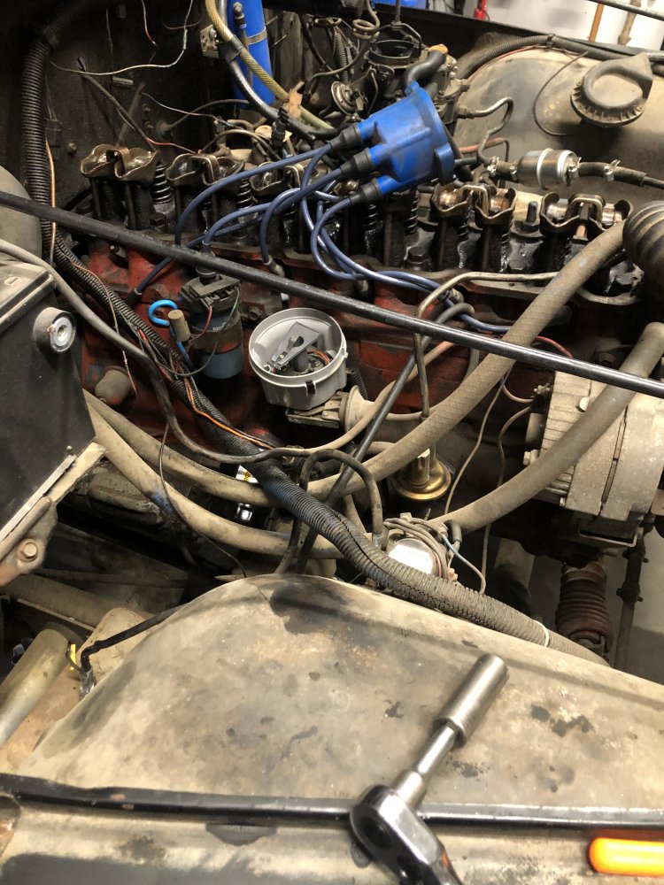

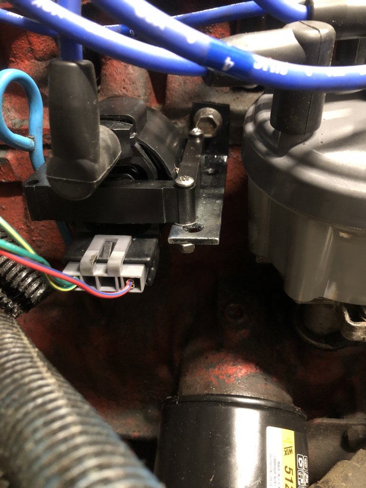

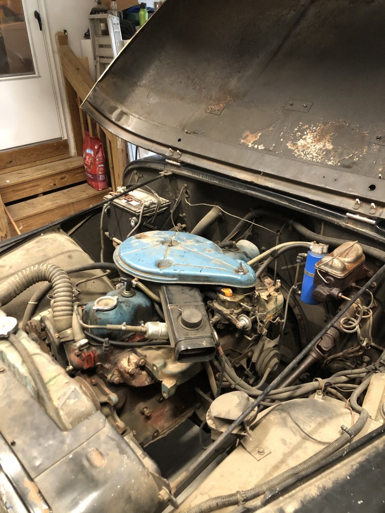

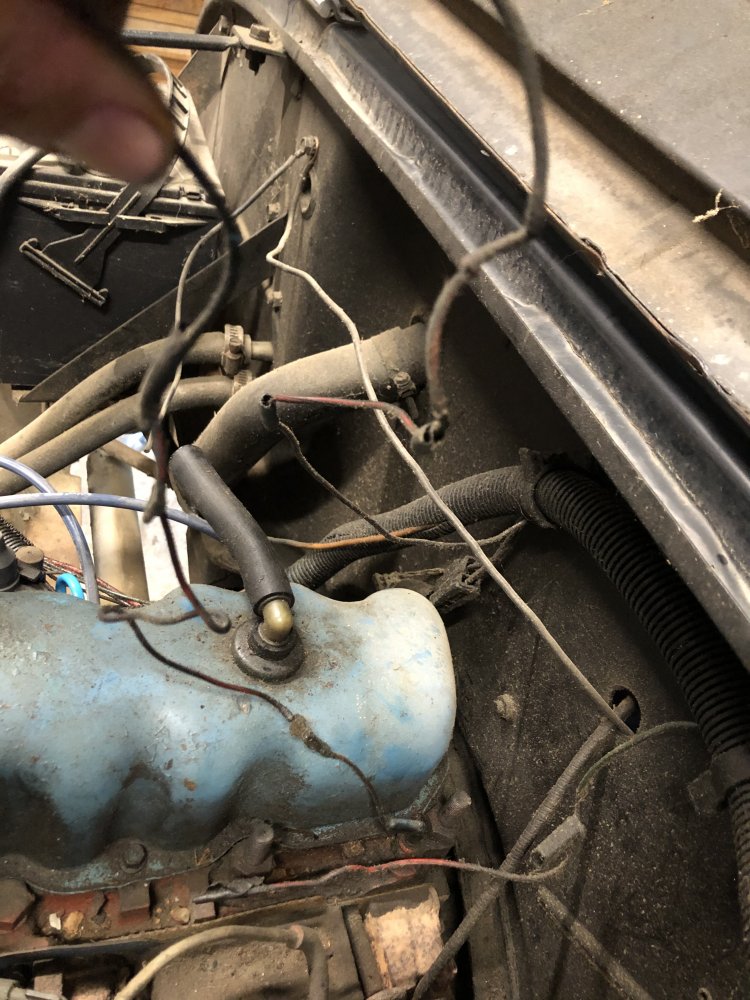

Got started tonight by pulling things apart for a tuneup and ignition upgrade with the Ford TFI parts. Once I pulled the air cleaner and went to replace the coolant temp sensor I found the issue there. About 4 butt connectors and frayed wires in a few spots going to the sensor. The gasket between the air cleaner and carb was missing and there are still a few vacuum lines either cracked, missing or not capped off so I’ll have to revisit that.

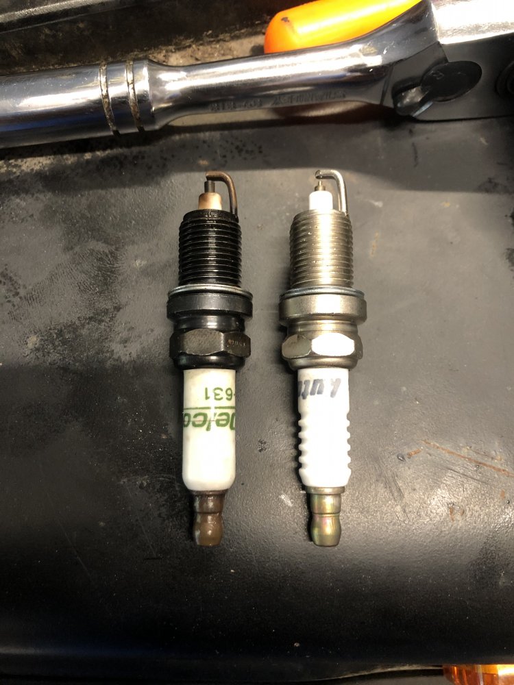

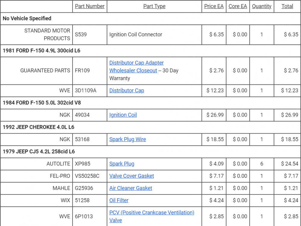

Swapped out the plugs. Wires. Rotor. Cap and cap spacer. The rotor and inside of the cap were pretty corroded. The plugs were pretty fresh but I swapped them out anyway. I need to get some L brackets to finish fabbing up the coil mount and it will be ready to fire back up.

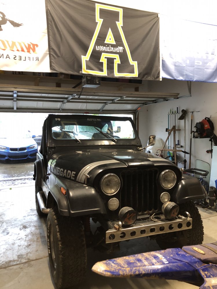

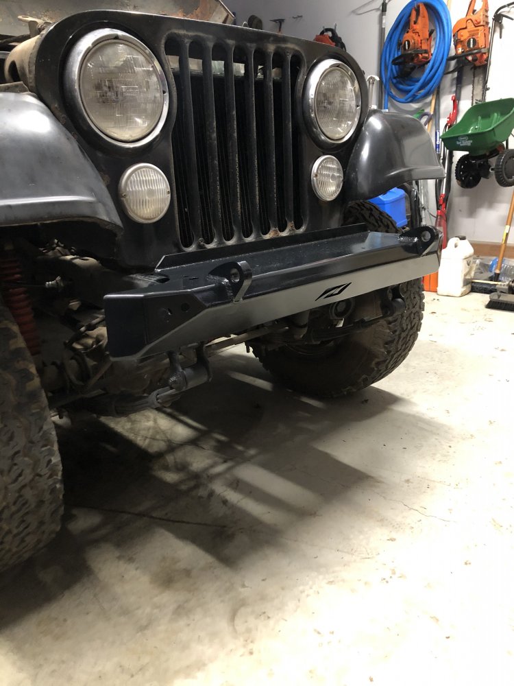

In the meantime I pulled the front bumper and mocked up its replacement.
