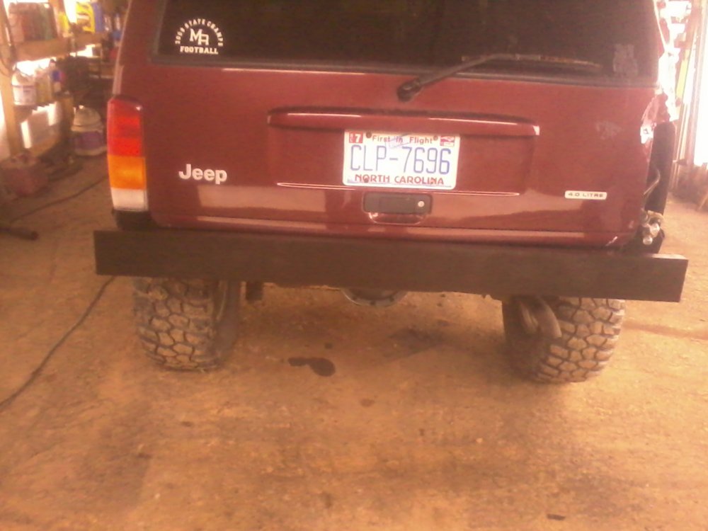

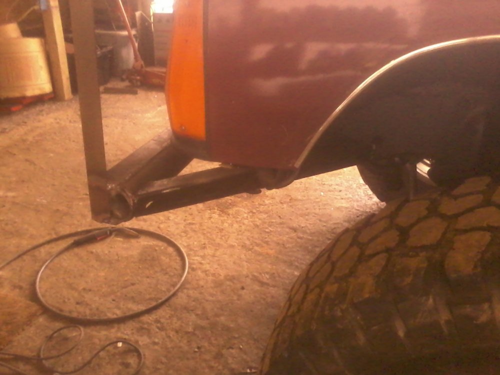

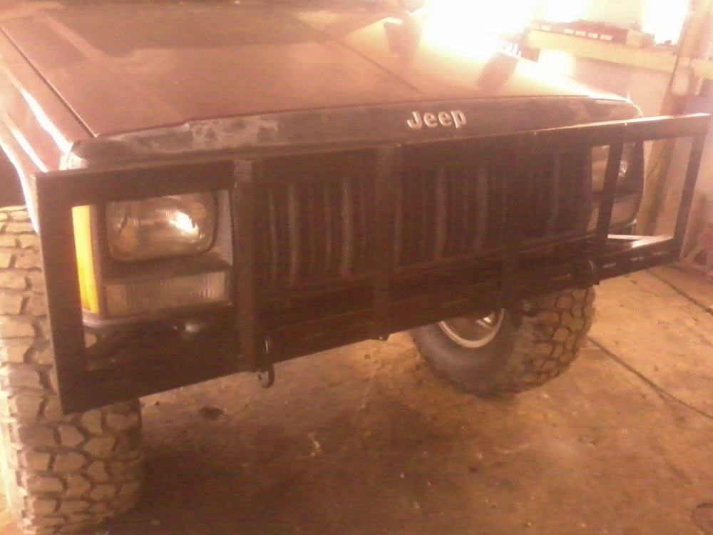

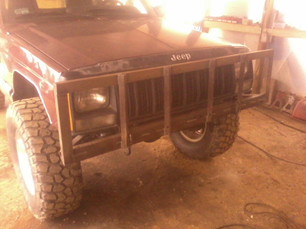

so here's my jeep for those actually interested in my current build..finished bumpers today front and rear and i like em...they will do the job i need em to!!

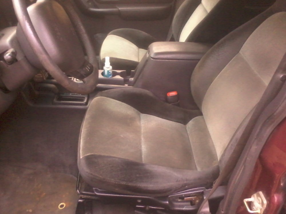

I like it. It's got kind off an executioner look to it. What kind off seats ya got there?
You welded the bumper to the unibody? Can't say I've ever done that, can't say its right or wrong but as long as you know that that whole bumper is only as strong as what its welded to (sheet metal). The front bumper looks OK but huge. A cucv comes to mind.
have no idea..bought the jeep for 400 with them in it already so i was pretty stoked about that..very comfortable
yeah..i went like waay bigger (didn't mean to but I'm all about some body armor and since i tore the front end up i thought to make sure it gets protected this time and eventually will tie in to the rest of body armor that will come later on. And for my personal jeep...i like to weld and bolt everything for added strength and stuff..eventually the whole left and right unibody rails will be plated with 5" C-channel like the back bumper is
I gotta give it to ya, you have the right idea there! Keep up the good work sir.

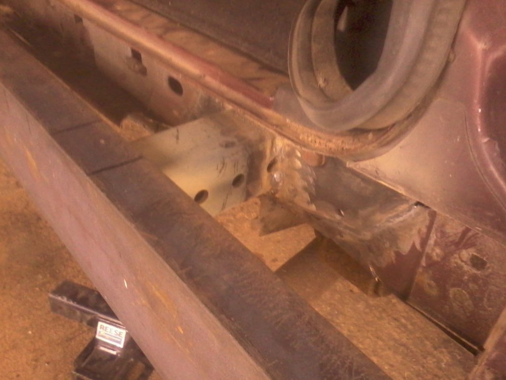

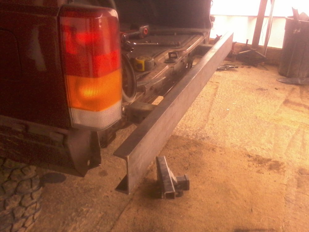

to explain and hope i was right for thinking this way...u know the rear xj has the square hole at the rear of the rails and the stock bumper mounts 2 holes on each side of the square hole...well i put a 5/16 plate, u can see it i think, on both sides covering the square hole and the 4 original bumper mount holes and bolted it and welded it all the way along and then mounted the bumper to that with those 1/4 steel sqares from hitch so i think it will be strong enough...
Yeah man that thing is on there!
this is my first time actually trying to do bumpers and plating for them the right way so I'm happy with it...structure strength speaking is the rear plate/mount sturdy enough for what someone else would want for like winch pulling, rock crawling. i ask because couple customers like the turn out of the back that saw it today and are intersted in one for theirs so is this rear setup something good enough to install/sell to someone or no...for me ok but customers i need some input...open to any/all opinions/advise

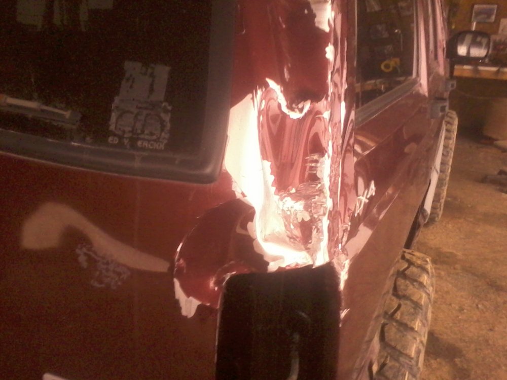

should've seen the front clip...way worse than this...that's what inspired the bumper build in front and rear. and btw, mounting pre97 front clip to post 97 front end was little more involved than what i was thinking...i did it but kinda pain in the u know what

Yeah, well that is not the most sturdy, safe or most ideal way to attach thick material to thin material.
You need to make plates that go into the frame rails that then attach to the bumper. You need to use bolts as a means of attaching the bumper to the unibody.
Look at how every other unibody bumper is held on and try to replicate that general idea.
Close up pic of the welds and we'll go from there. I can see its flux core, not knocking that, I use it too.
well i figured that..i just don't do brackets because of time and materials so for my jeeps it's easier to just weld it all together. when i drop the gas tank down i will plate that hole area and weld it in to the plates that the bumper is welded to so that should be plenty strong for anything this unibody would ever see or do...as far as welds>>that one picture is the closest i got for now.
Jody>>could you or someone please school me on why this bumper setup would be considered "not the most safe or sturdy" as you stated. i'm just looking at stock bumper is very thin material with 4 cheap bolts going in square pattern on each side of the unibody frame rails so plating that whole area with 1/4" or so all around it and then welding the thick square tube to that surely that has to be like 10 times stronger than what factory design is?? not arguing but just trying to figure out the logistics of the not sturdy or safe part...i know not ideal way but the other 2 i'm kinda confused
that's closest picture i have right now of my welds..flux core Lincoln 140.
those plates and square tubes are right in the center of the unibody rails on both sides so in order for the thinnest metal to give...which would be the rails...then both unibody rails would have to give quite a bit cause i know that plate and square isn't going anywhere so i figured would take a hell of a impact for that to happen
