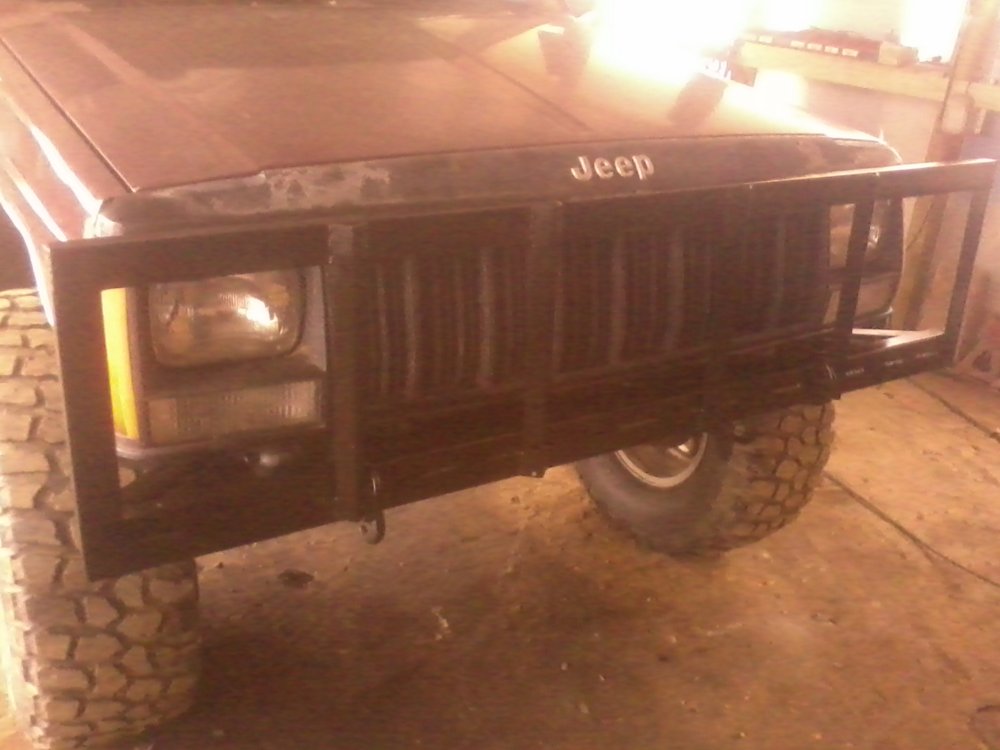

ha ha ha very funny!! but in seriousness though...someone or couple critique me on my rear bumper build..good or bad cause it kinda affects future builds for others or not. thanks
No. I refuse to give any advice relating to fabrication. If your prior responses were less like rants, and more like an adult accepting constructive criticism, I would be glad to offer advice.
Until you prove you can ask a question and not have a meltdown at the response, I will keep my advice directed towards your actions on the forum.
One last thing. You take everyone's suggestions like no one else in the history of off-roading has ever wheeled a semi-stock rig and pushed the limits to the breaking points. You are not the first to try to make it work and/or prove a point. Most of the responses and suggestions on here are to try to help you in the long run one way or another, either financially or by saving time/heartache/broke parts/stress, or a combination of those.

Be careful when backing up in a tight spot with the front bumper. Had a buddy with a wide bumper like that to protect the front. On a tight trail he pushed a small broken tree off to the side and attempted to drove around it. He had to back up and the tree was then hooked between the bumper/grill guard and tire. Completely smashing the fender, grill shell and headlight/marker lens.
Just a heads up when you are out wheeling.
ohh and another novice question and probably dumb one too...can you do body exo cage for armor purposes with stuff like square tubing, angle iron type stuff, C-channel stuff...seems to be way cheaper for that stuff...at least angle and c channel stuff is pretty darn cheap i just found out
yeah i know...it's alittle wide but i'm going to add some kind of C channel or tube/square long pieces to tie in to the roof and fender pillars eventually to where the side of the fenders won't be exposed like that. next thing i'm doing is a exo cage to complete the bumper tie in for body protection so front bumper won't be like that on the sides when complete.

dammit...i've been staring at my bumper for like 30 minutes now and well........now i want to shorten it some. at least the same length of body and probably couple inches shorter. one reason i don't like fabbing stuff...takes 10 times longer to draw it up and "like" what you draw and make than it does to actually put it together. I spent like 2hrs lining up/measuring/deciding/planning for the rear bumper and when i decided for it....took like 6 minutes to weld the darn thing on and done. so back to drawing board in the am to chop down this front. will put pictures tomorrow if i finish it of the new final product
I have read every thread you have been involved in...mostly for entertainment.
I do have 1 question. How well do you know Captain hook at the TN Line ? You've dropped his name a couple times, but for the life of me, I cant imagine him endorsing, or condoning this type of fab work. Not talking about a doubler or anything, just wondering how well you know him is all.
