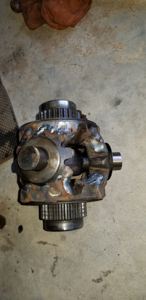

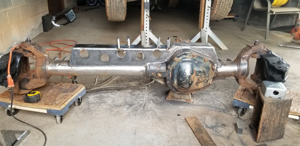

Axles: 2008 Superduty 60 front, Sterling 10.5 Rear 3:73 factory geared, welded carriers

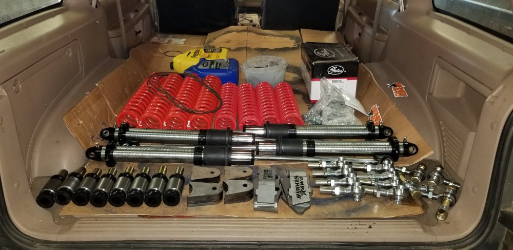

Suspension: Triangulated Rear 42" Lower Links, 38" Upper links 7/8" Barnes chromolly joints all around
Triangulated Front 42" Lower links, 32-36" uppers (hard to say until I really get in there and figure out exhaust headers)
FOA 16" Coilovers Front and Rear

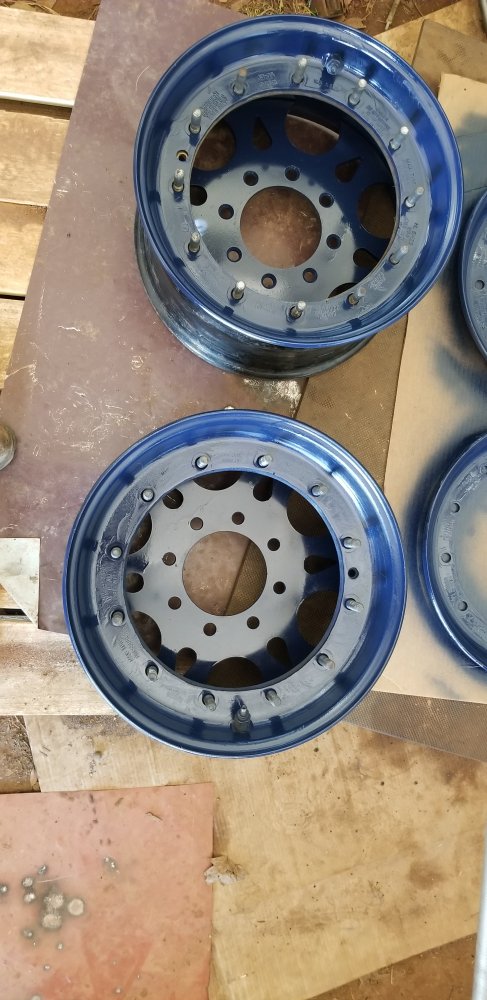

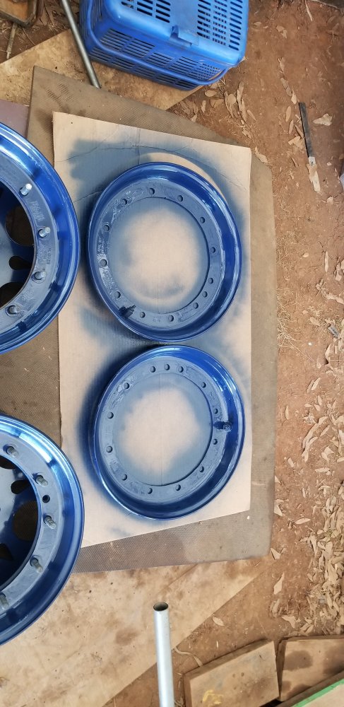

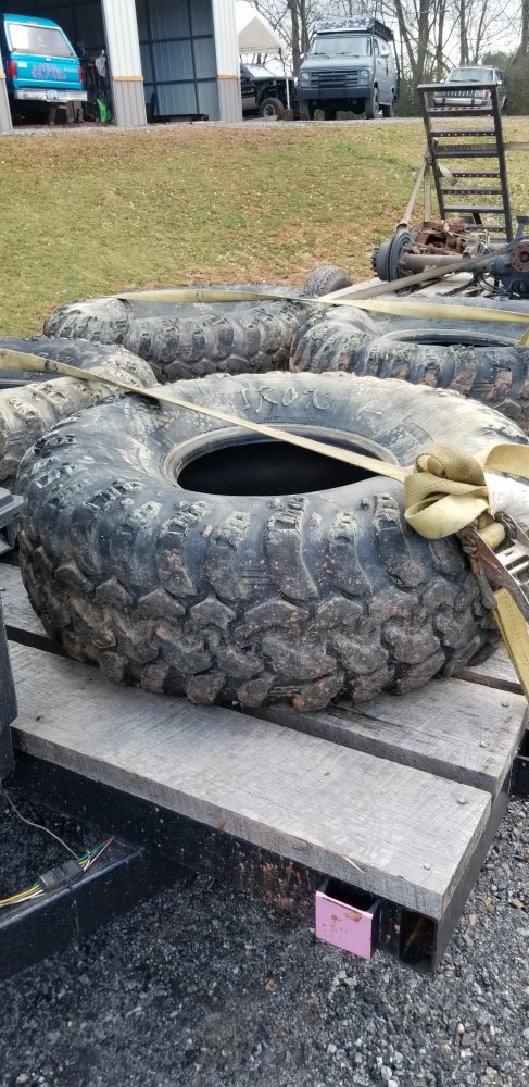

Tires and wheels: 42" Iroks on H1 recentered double beadlock wheels with some Stazworks HDPE Inserts!!

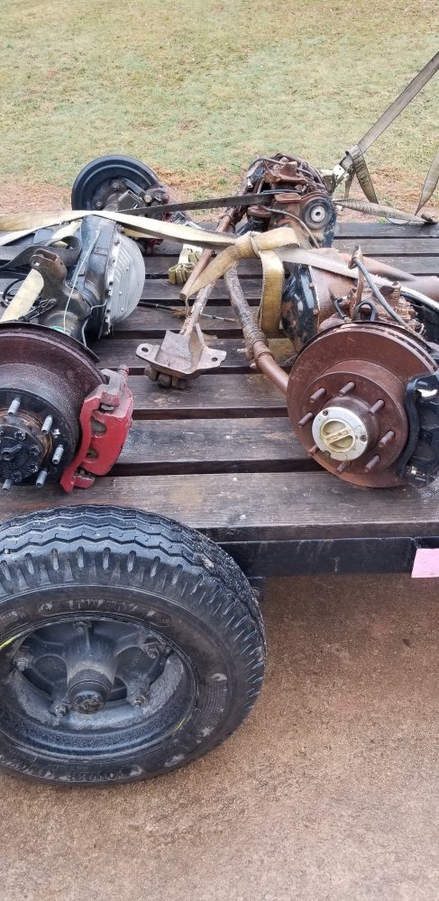

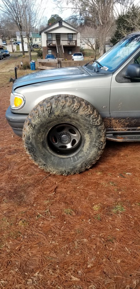

picked up xmas day

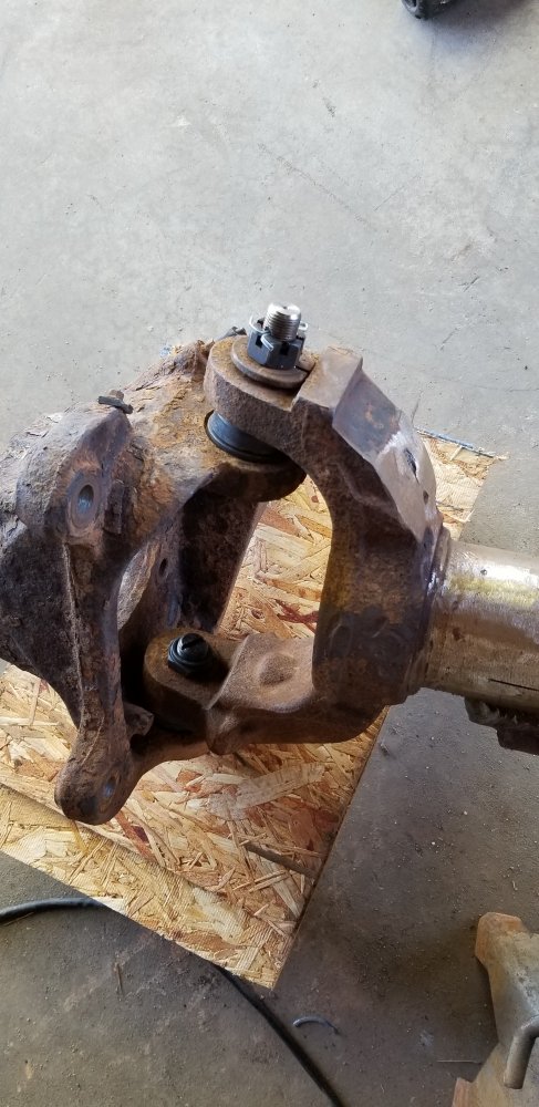

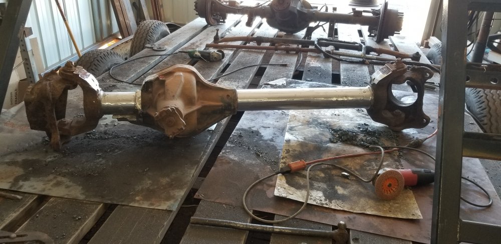

Front cleaned up..wow that's a job!

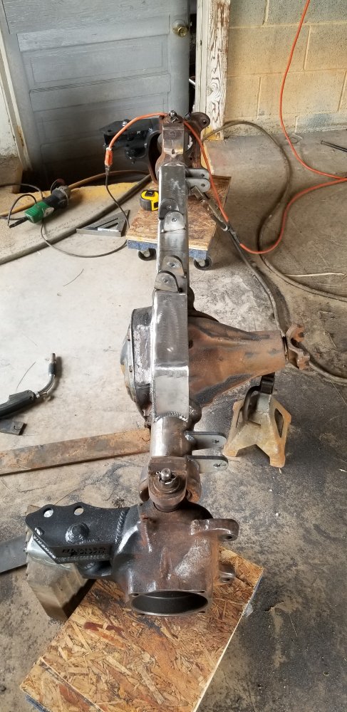

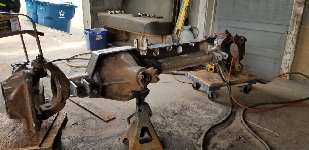

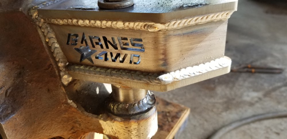

All axle work complete. New ball joints, axle joints, barnes high steer arms.

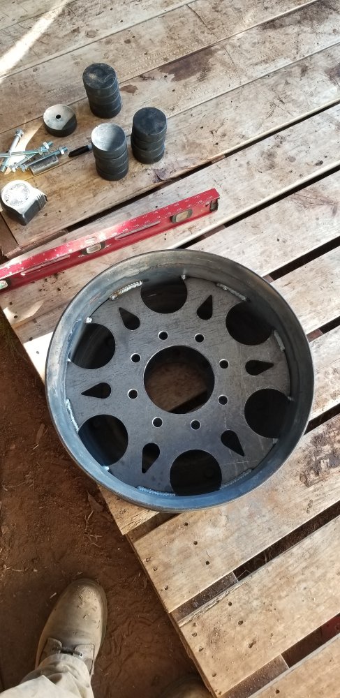

Oh yeah my wheels that I loove. 2.5" offset.

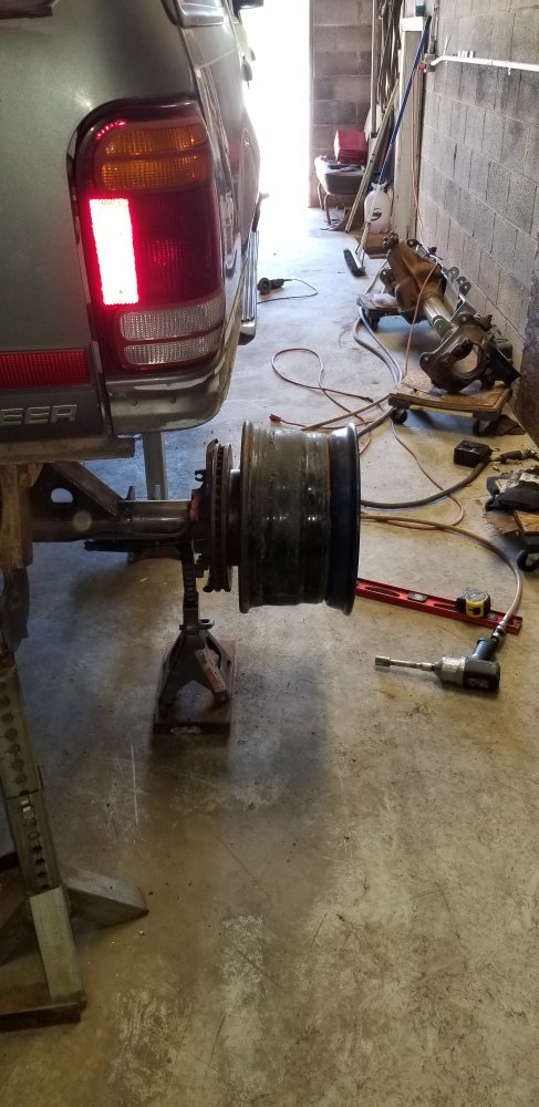

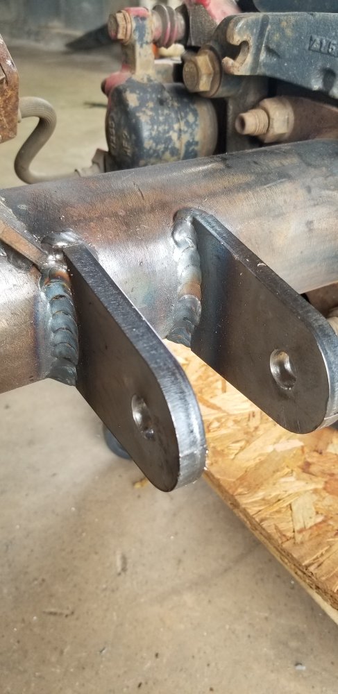

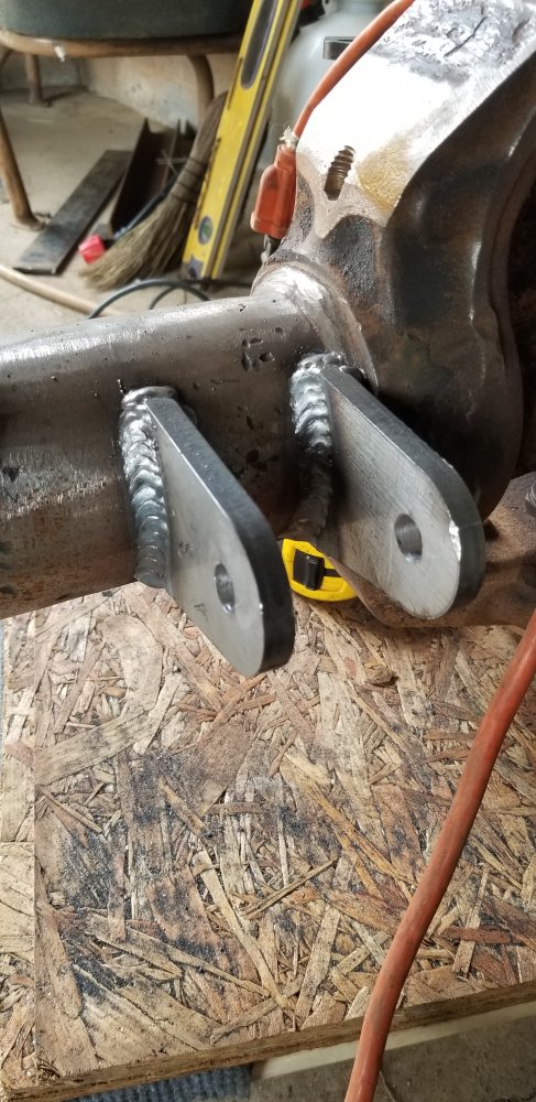

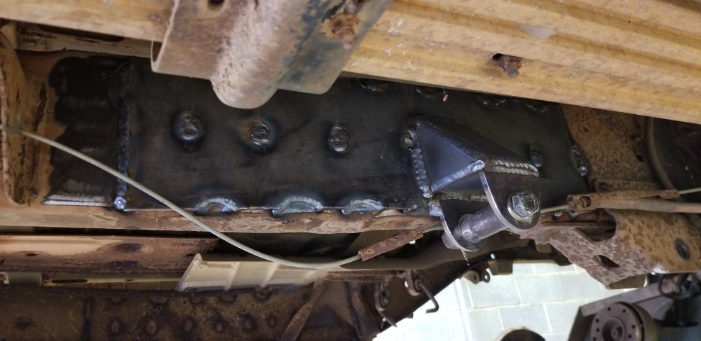

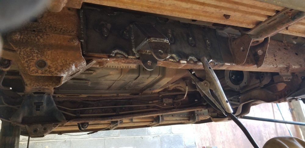

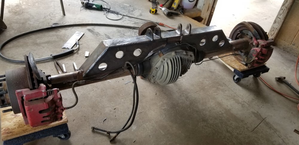

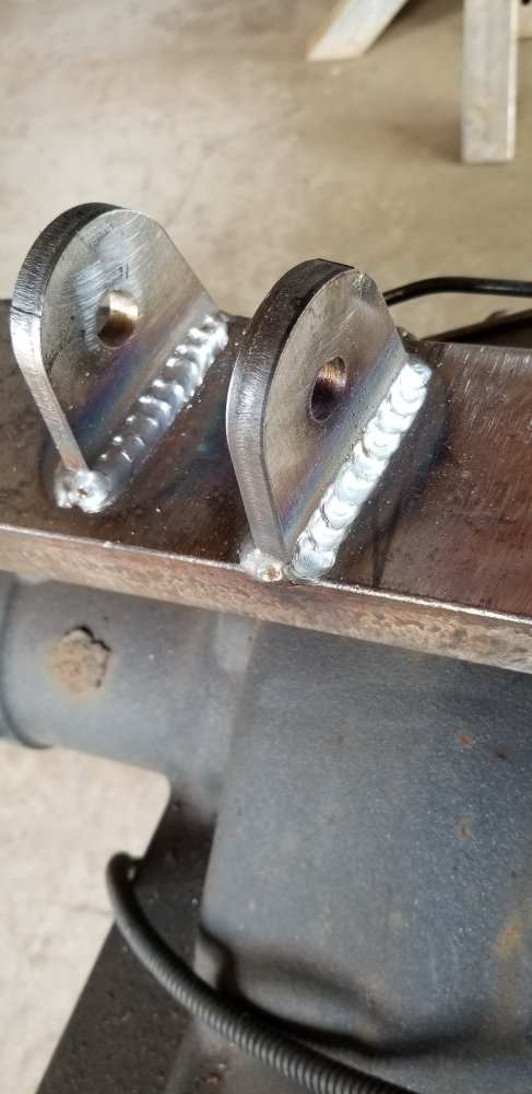

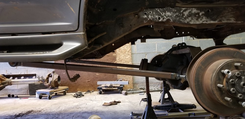

Got rear axle lined up and lower links made as of today! Had to make frame plates since this ford frame is kinda junk (disappointed about the frame on it, oh well). Decided to outboard the lower links for clearance and better stability.
Oh yeah, she gonna have a wide a** for sure. That's axle sitting centered at ride height!
it will only be 1.5" wider than my last jeep buggy I just sold so that's not as bad as it looks. On this small little full bodied mounty though it's gonna look pretty darn cool.
So far, the rear is stretched 11 inches to bring the 42s within 2" of even with the rear bumper when build so my departure angle is steep and to keep the back from "hopefully" not getting as beat up as much, haha. Yes you read that right, 11" stretch in rear!! It will be total wheelbase of 122". You get used to it!! Last jeep buggy I just sold was 120 so it's not that bad. I love the wheelbase for climbing and doing technical stuff which is what I'm after. yeah it sucks on narrow trails/tight turns but I've learned to manage!!

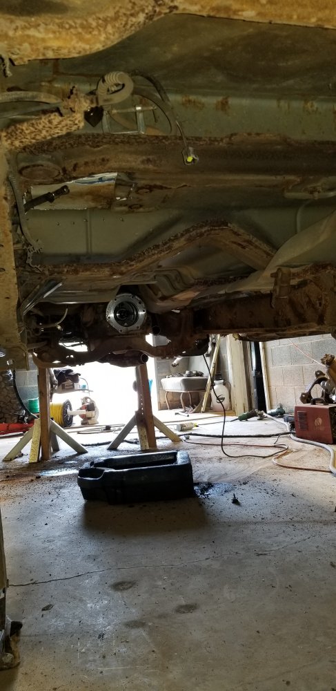

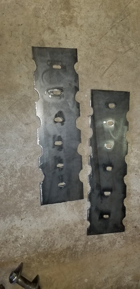

Funny I was exited to have a body on frame and not have to do so much "plating" like I've always done on XJs/ZJs but once I started tearing everything down, I realized, well this sucks, no way I'm trusting this rinky dinky frame to hold up on tons and 42s so looks like I'll be plating most if not all the frame rails front to back on this rig too.

My bit of constructive criticism... maybe add some boxing on the front of those lower link mounts. High impact area that’ll see tons of abuse. Wanna protect the heims as much as possible and minimize the chance of the tabs getting bent. I see good parts in those pics. Keep your standards high and it’ll pay off on the trail.
