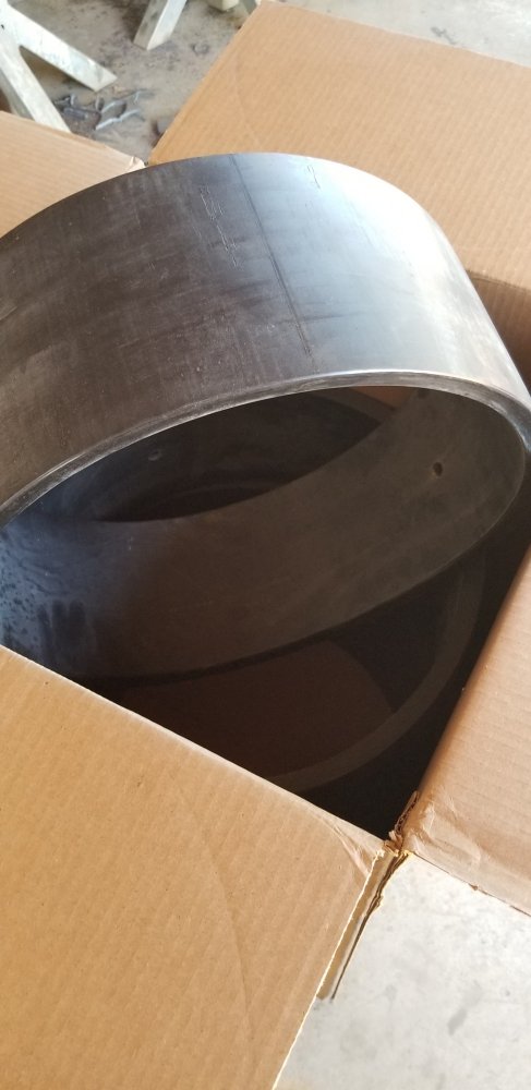

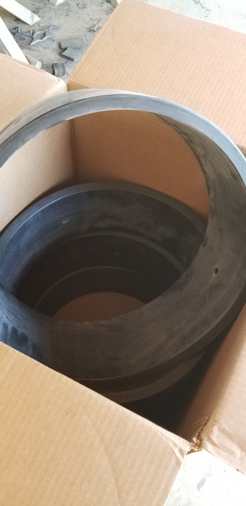

More goodies just showed up...oooweiii. mounting so tars later. Stazworx is great deal on these HDPE inserts btw for anyone interested check them out. $303 shipped!

boy these went in the tires like butter!!! couldn't be happier with how easy these are vs the PVC inserts or the stock ones I had before. gotta get some silicone to seal up the rings and I'll have my wheels finished tomorrow!

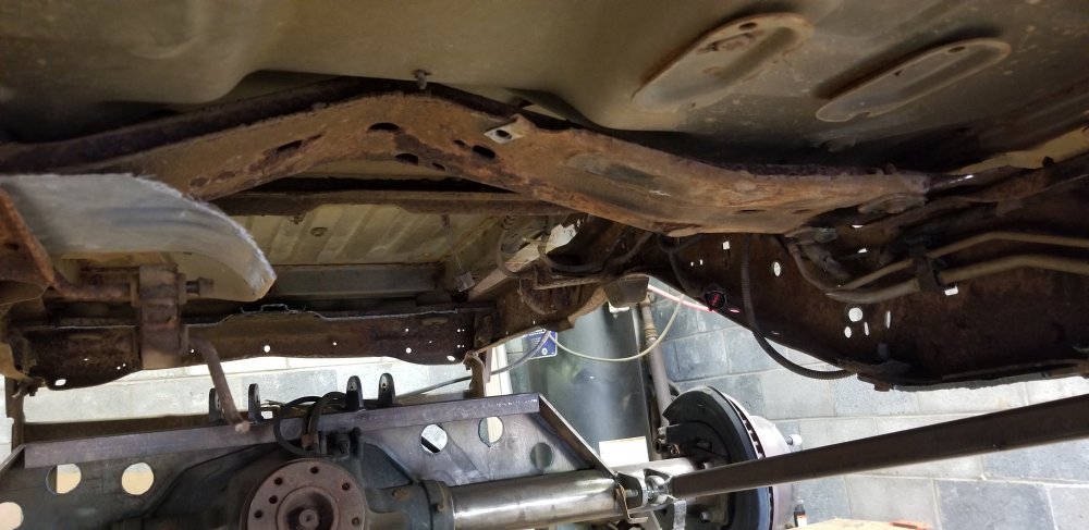

@jodyou have a ranger/explorer frame right?..
Can I cut this brace out ...its in my way of upper links. Once I build the uppers, I will add in a new brace ...or not a good idea until new one built?
@Jody Treadway for the previous picture or anyone else whose familiar with these frames...i'm on hold till I figure out if I can cut it or build around it first. Thanks
Don’t use silly cone. Use copious amounts of thick nasty axle grease to seat the o-rings for your rims. The o-ring sits in a groove on the mating surfaces of the rim. The grease keeps it in place while you torque the halves together and helps seal it up. I have built 100’s of those rims in my time.
Nasty old sticky axle grease ( the brownish tan shit that never really comes off your hands and stinks)
well dang it, I could've done it tonight then lol. thanks for the tip:beer:
It’s still “tonight” go get after it. Got good enough at one point we could break down, clean, and remount a set of 4 Good Year Mt on HMMWV rims in about 2 hrs. Of course now they come on a pallet fully assembled just zip lug nuts on and off. No character building in that!!!
