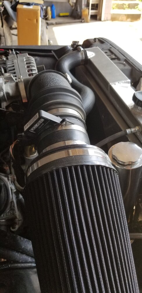

Here's the layout, no it's still giving me the same code..maf low circuit input p0102.

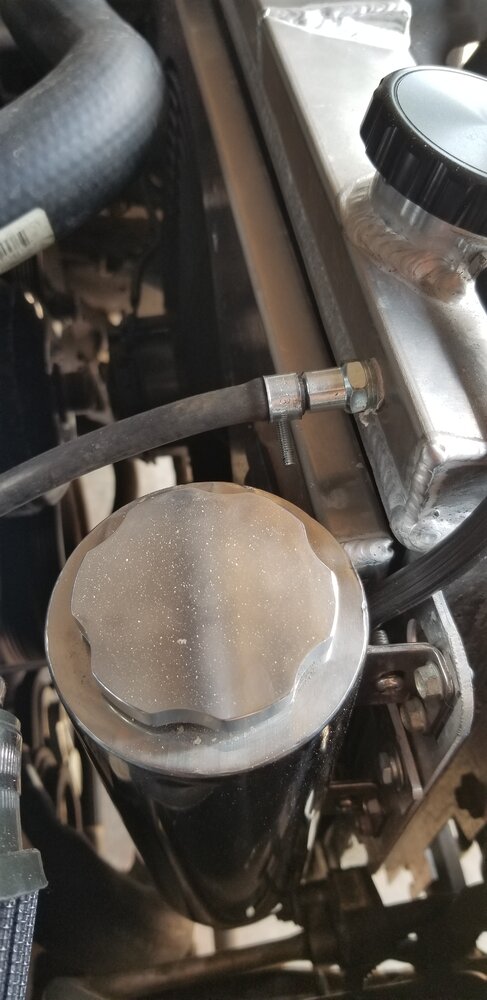

And cooling system still not quite right. It's running at 185 idling, 177 driving but upper hose is still too pressurized and lower thermostat hose still not all the way hot. Do I just assume new thermostat is janky or somehow still air in the system?
Steam port for the cooling system is here

Are you measuring cooling system pressure or just assuming it's "too pressurized?" This temps are fine, most stock truck ls stuff runs 195-210.
No but judging it by how the upper hose should feel..its too stiff for what I'm used to. Plus the thermostat lower hose should be much hotter than it feels. Idk maybe im overanalyzing
Without putting a pressure gauge on it then you're guessing. The upper hose should be hotter than the lower hose. Upper is the water pump outlet and lower is the inlet.

Try cleaning the MAF.
Did you ever get the coolant temp sensor IN the flow of coolant? How are the fans controlled and when do they turn on/off?

I'll try cleaning it tomorrow and yeah I got the coolant sensors moved to where they're straight in the head like factory now.

Since this motor runs on MAP sensor and MAF sensor together, what purpose does one or the other do...another words why have both? pretty much every car I've worked on has one or the other not 2

It uses the MAF to actually measure air flow, not calculate it based on its density. The MAF also houses the IAT sensor. You can run an LS without a MAF in a speed density tune, but there's absolutely no point in this case. It would require a tune change, a full rewrite to license it, and you'd have to wire in a separate IAT sensor.
