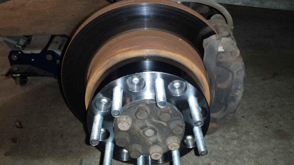

I've been doing things. The rear wheel spacers finally came in from Motorsports Tech. I bled the power steering some more and it'll turn about 1/3 of the way in either direction when you're sitting still...so it's getting a PSC power steering pump and hydro assist added since the box is already fitted for it. That means it'll probably get some sort of traction aid in the front eventually.
These are 2" steel spacers that are hubcentric. Pretty damn nice product if you ask me!

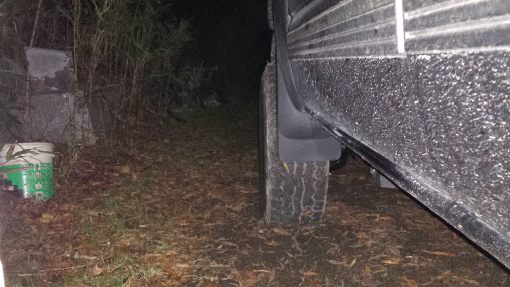

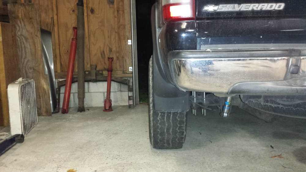

As you can (kinda) see, the front and rear are pretty much even. The corner of the tires are just past the edge of the mudflaps. It looks much better...especially in person.
