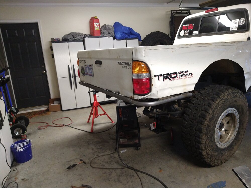

Pics of the bumper, chopped up reminants of my old one:

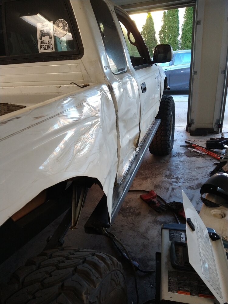

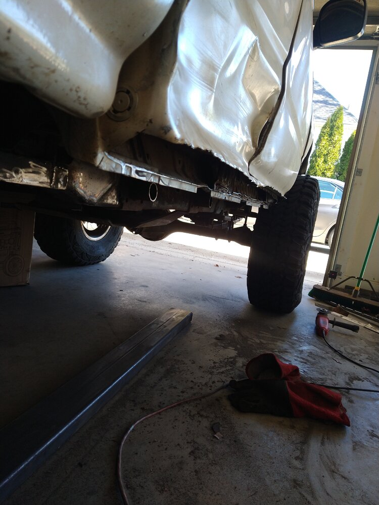

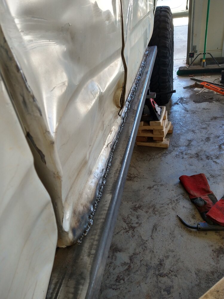

Well this beast is ready to wheel. Outside of a few punch list items, like welding on a non crucial fish plate, and some poly bumps for an upcoming trip, she's good to go! I knocked out the sliders today, goddamn that sucked. Not the rain of fire like people warned me, but it was just a tedious, dirty, nasty job.

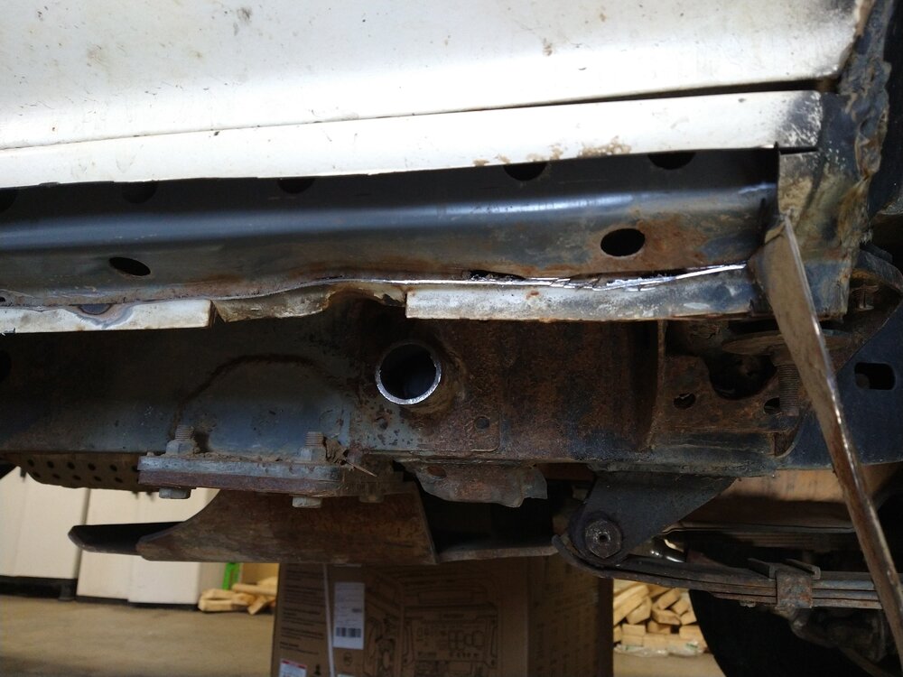

I chopped out the rockers and I found this under:
That side impact beam ATE cut off wheels, like evrey inch I moved the wheel it took off an inch of wheel. Crazy.
Welding thick steel to sheet metal and rusty body seams with a flux core welder sucks!! My objective was to finish them in one day and mission accomplished. I do have a Barnes cross member bushing kit to mount them to the frame back by the wheel in the future.

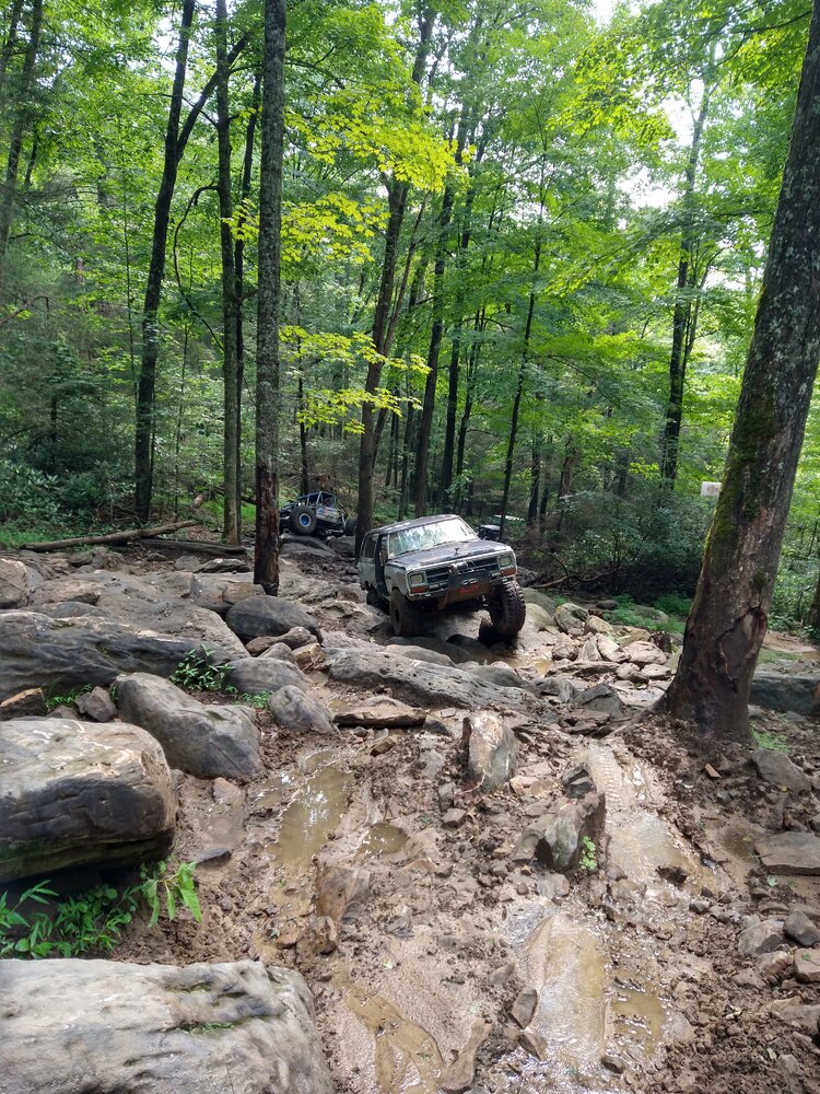

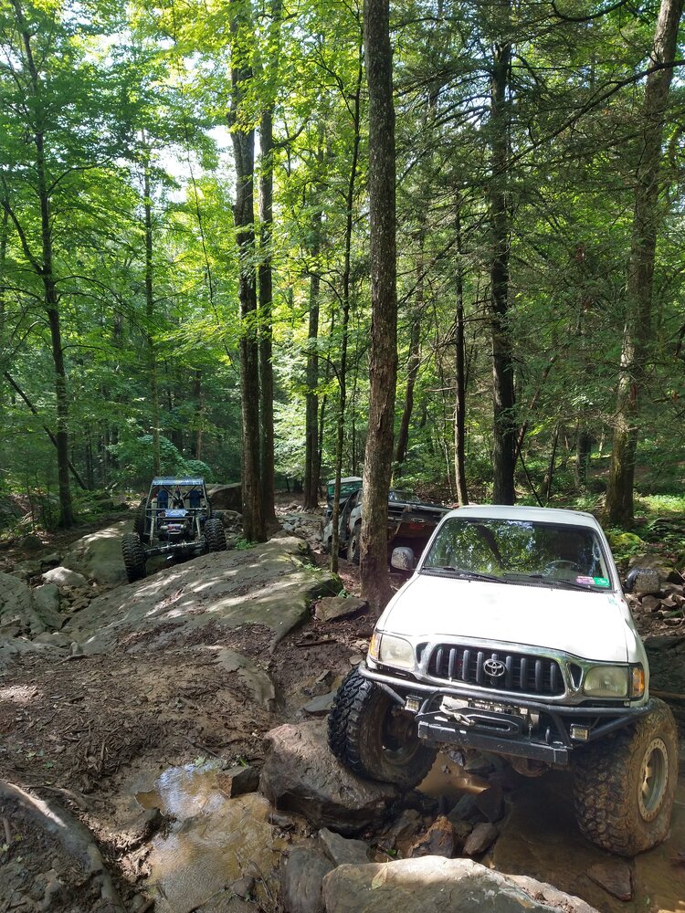

Few random pics from AOP:

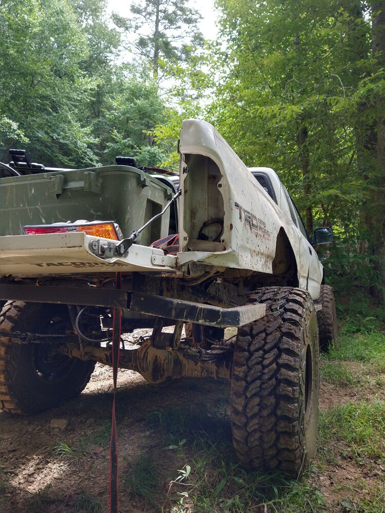

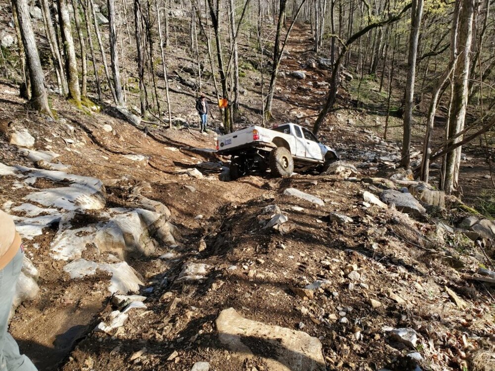

I broke my rear bumper on this obstacle, this dude broke a coilover so I shouldn't complain. Nice part is he was able to cruise down to wide-open design and got it rebuilt and was back on the trail the next day

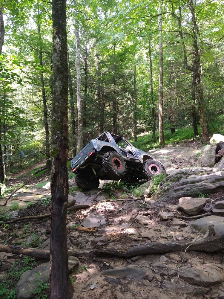

Almost flopped going down hill.

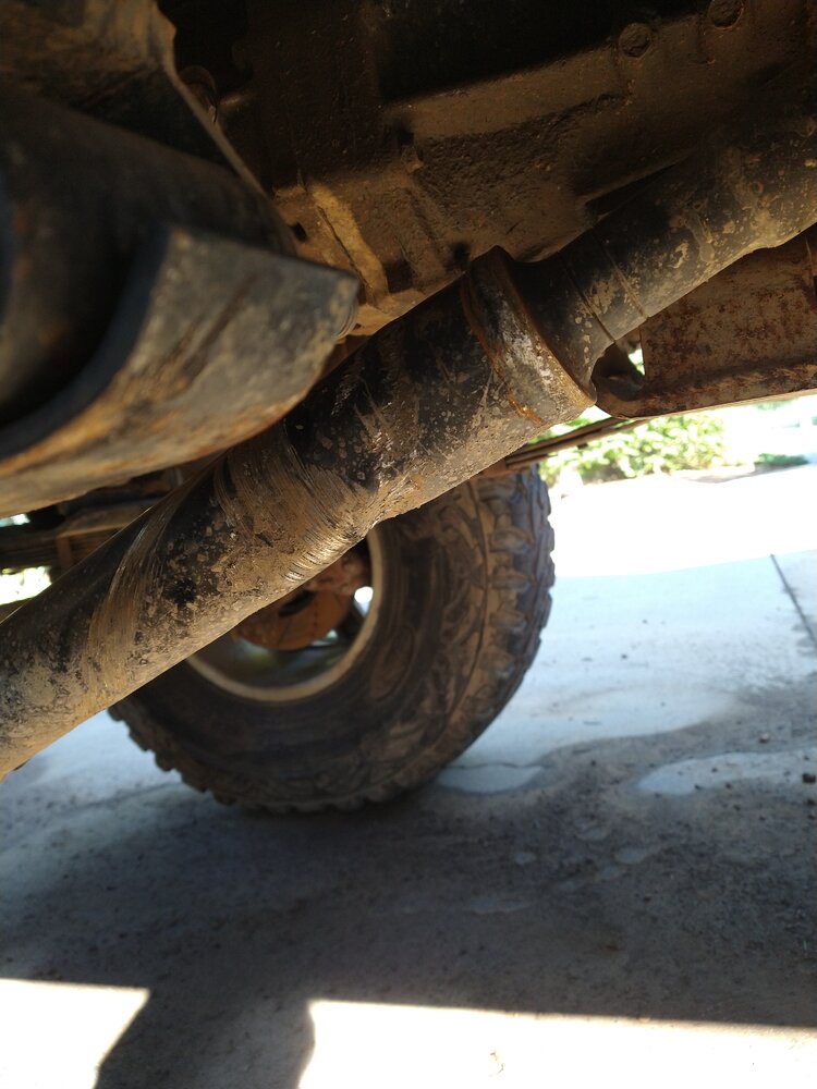

I mangled the rear driveshaft at Potts mountain of all places the last trip out. I dropped them off at Oliver's to fix that problem. I also have been living around moving some shock mounts and maybe spring mounts around on the front to gain some uptravel and get the truck up and off the air bumps so it rides better on the street and trail.

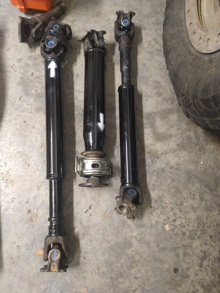

Got my retubed driveshafts swapped in from Oliver's. Nice and smooth all the way up to 80, can't wait to bang them off some rocks next week! It will be a long week of sweating my ass off in the garage knocking out a ton of little punch list items I have been kicking down the road, why wrench on the truck when it's in the mid 70s during the day and 60s at night like it was a month ago, when you can do it in 90s and humid instead??

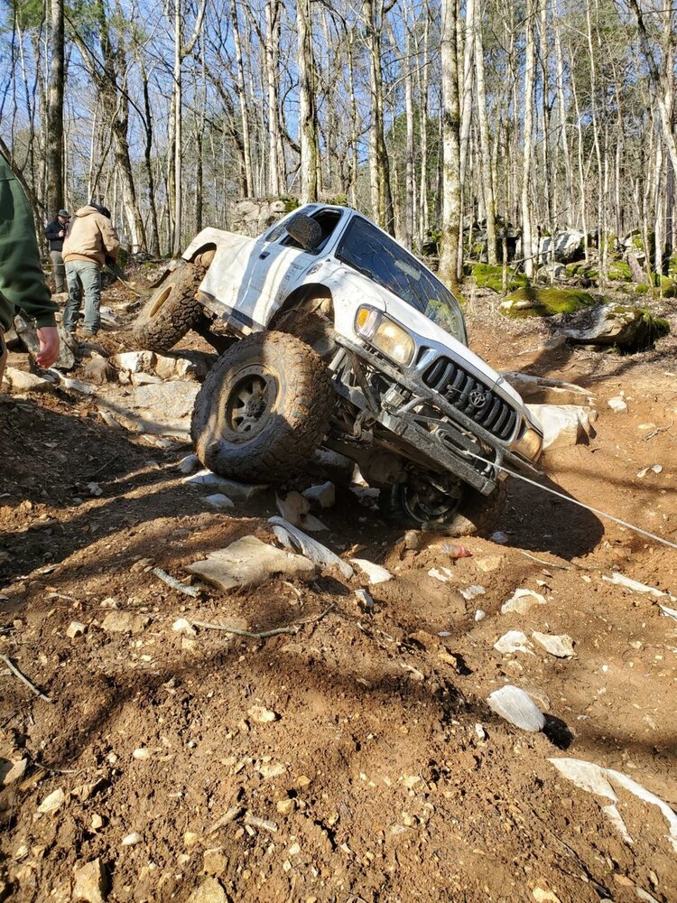

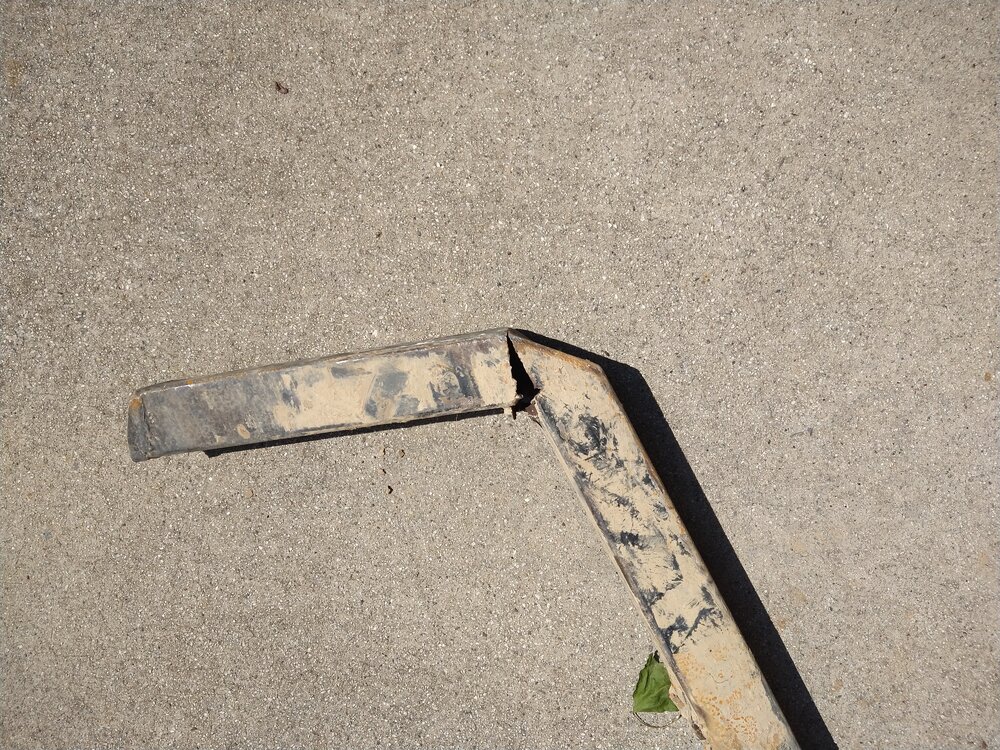

Went wheeling with some noobs at GER this weekend. Ripped off my rear bumper for the 3rd time, took out a sidewall, my rear axle hub started leaking on the way down and I now have a deflated airbump. Awesome weekend of wheeling overall!!
Good times were had, I really needed that trip!! Thanks for letting me tag along Joe, Justin, Cody, Duane, and I forgot everyone else's names, been meaning to hit the trail with y'all for a while!!

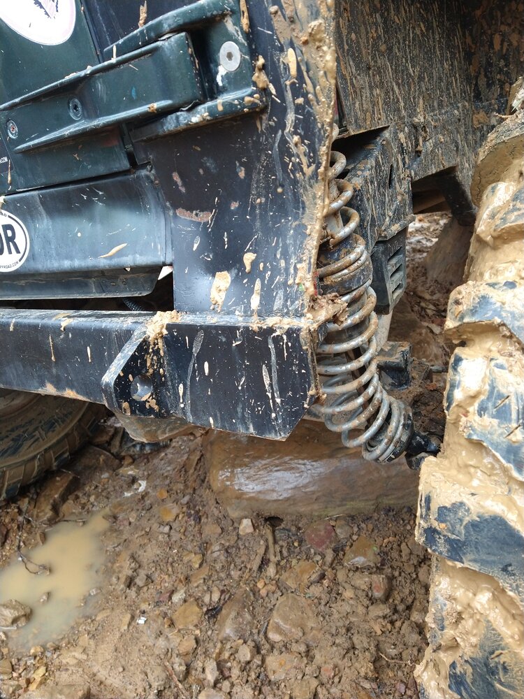

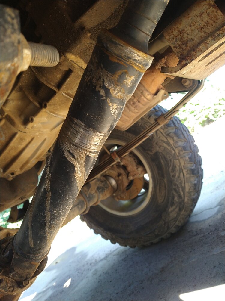

I washed the truck yesterday and did some more post ranch damage assessing. Not too happy about the front shaft as it wasn't cheap. I think I'm just going to embrace the Toyota life and build a square front shaft and not worry about it again.
Rear bumper carnage, lol

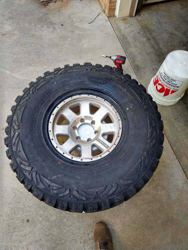

I did get the new tire mounted.

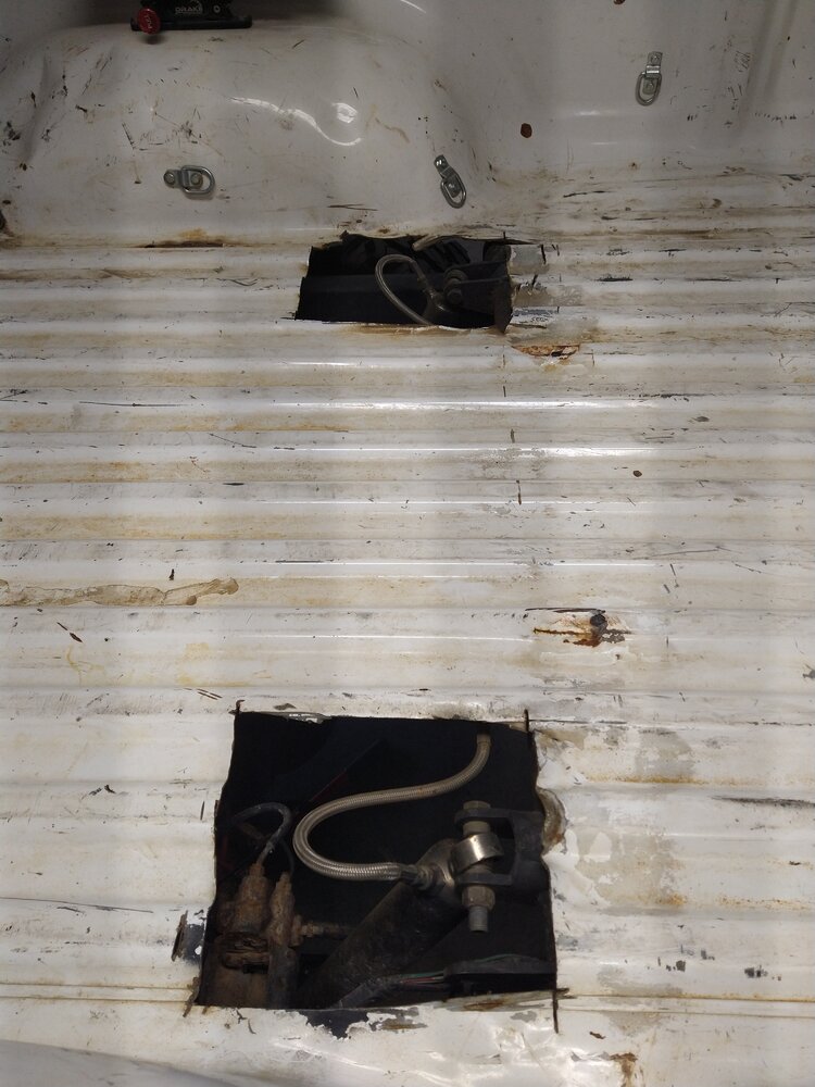

So today is the day where I reverse the dumbest mod I ever did to this truck, drunkenly hack holes in the bed because the Internet says 12" shocks don't fit unless you cut holes the bed, well they do and you don't have to lol.

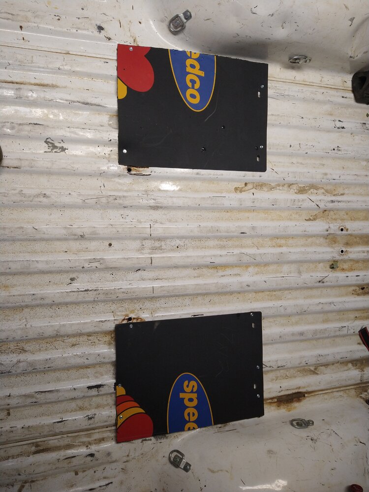

They were out of fat trucker girl and Yosemite Sam back off flaps, so that had to do. Cut that shit with the grinder, and 6ish self tappers later, not more scattering straps and garbage out of my bed all over the SE!
Words cannot express how excited I am to finally patch those holes up!!!!

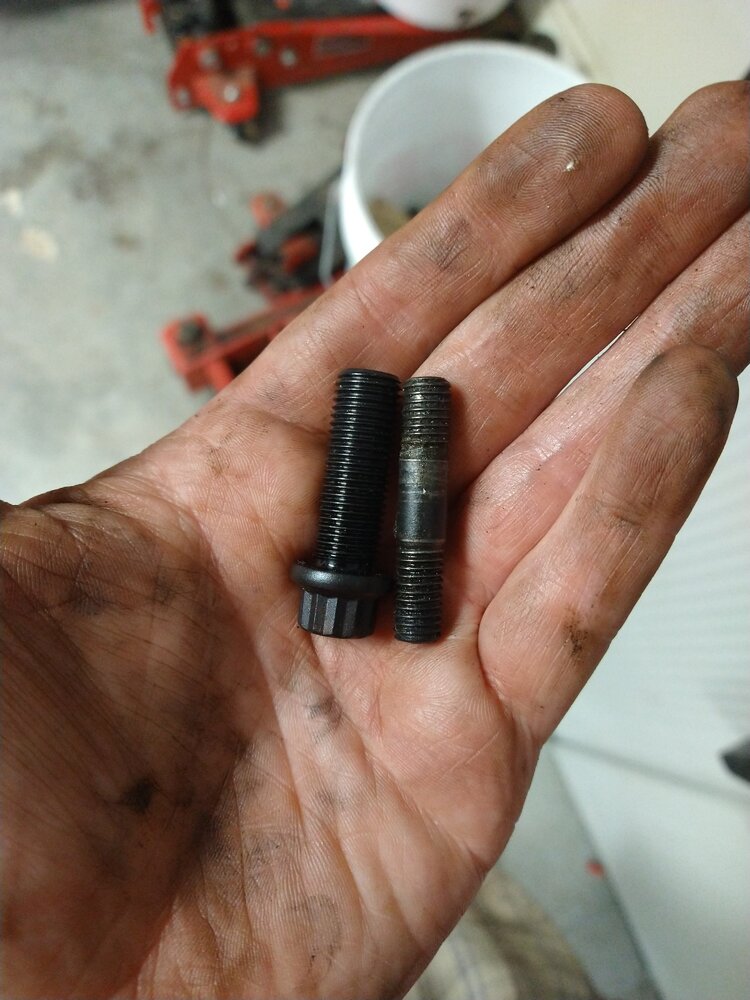

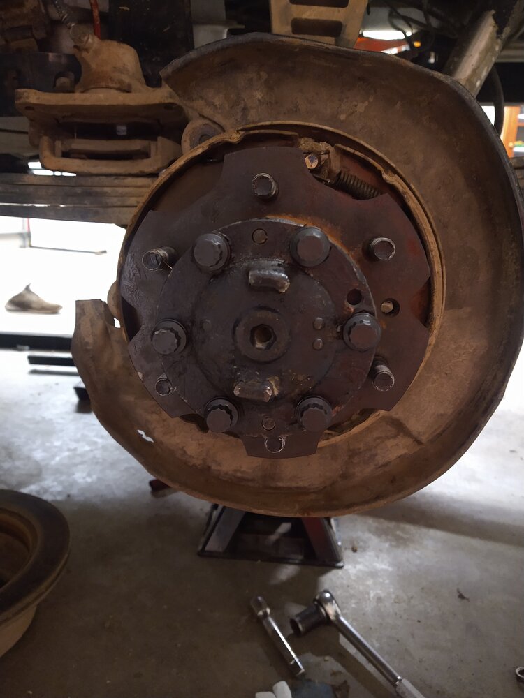

This has been one of the more annoying projects, I have been repairing a leaking rear hub for about 2 weeks now. I decided to upgrade from tiny japanese studs, to big black bolts while I "was in there anyway". Famous last words of any project. Well I smoked 2 drill bits, and broke a tap in the process. Time to do the other side :laughing: . Over under on me snapping these 7/16" bolts after never having broke a hub stud??
If you want to pull the hub off you can bring it over and use my mill or drill press
Ill probably take you up on that for the pax side hub! Amazing I still have intact wrists doing this with a hand drill lol!!
