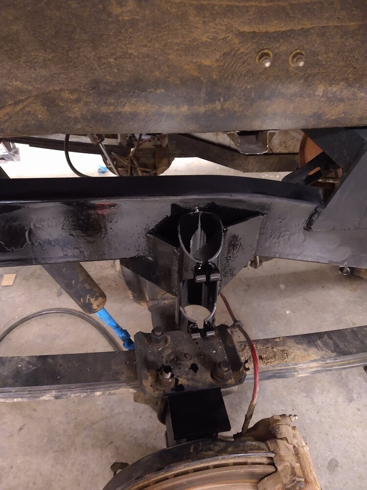

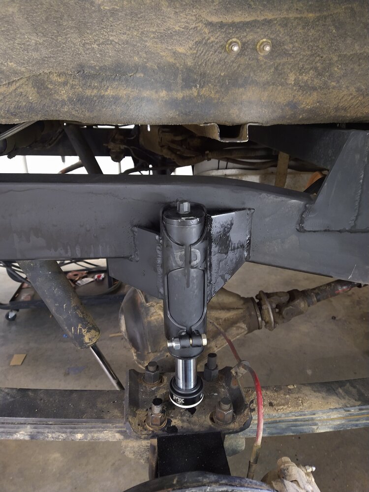

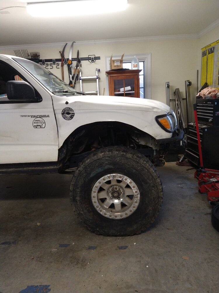

I should finally have this thing back on the road. Air bumps are done and charged up, just need to slap some tires on it and see if I fixed the leak.
Driver's side
Pax side.

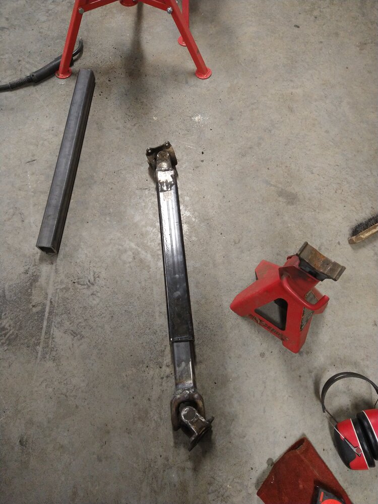

Next up is a square front shaft this week and I'll be ready to wheel at the end of the month!!

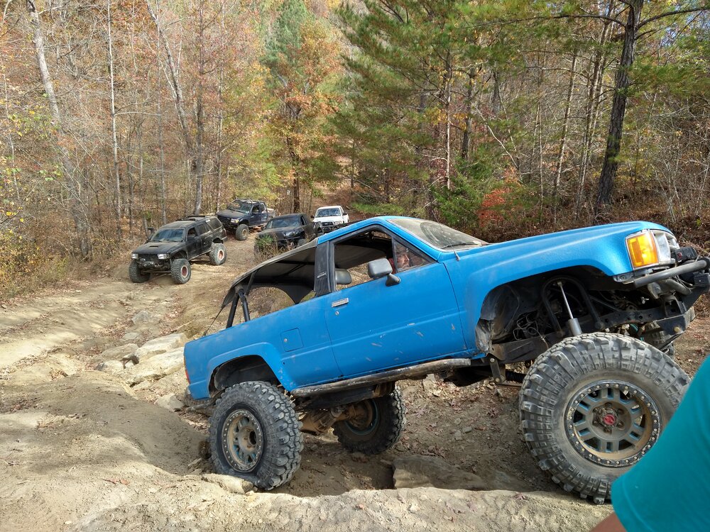

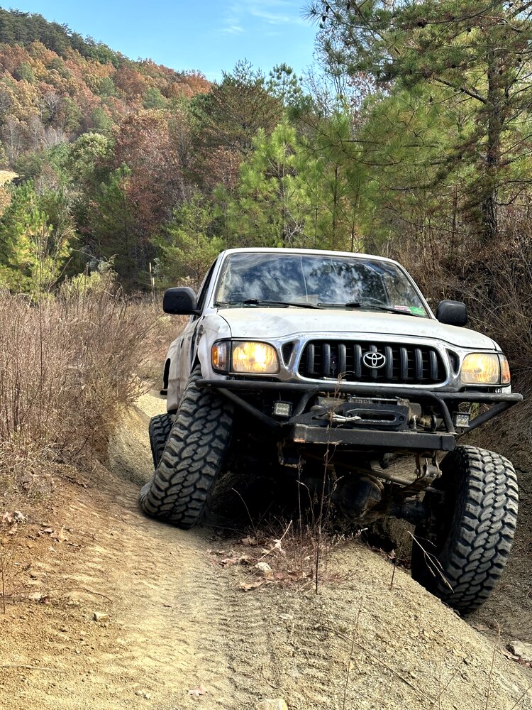

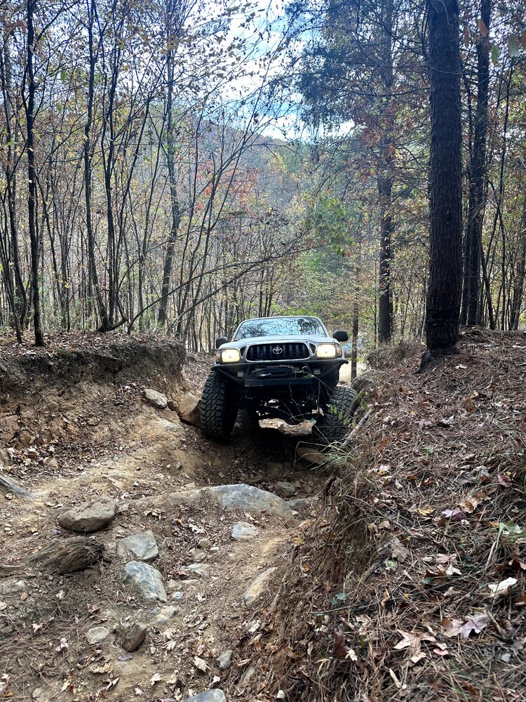

Just got back from wheeling Hawk Pride. Badass weekend of wheeling, truck did fine, only "issue" was I blew the alt-s fuse randomly dropping hard off a ledge. I busted out a tail light on a rock repositioning the truck to get my seat belt to lock so that was dumb lol! I really need to push the front axle forward and get it off the bumps. The rear rides awesome, where the front just pogos off the bumps as I am sitting on them. Also got to play with the trail welder twice, not on my own truck, so good weekend overall!
The trucks overall dialed and I love it! It goes almost anywhere I point it and does 80mph to and from the trails with the AC cranked and cruise control on and all my shit piled in it.
I have been kicking around building an exo cage or re doing the front suspension this winter. Considering my steering sucks, 2 of my 4 TRE are seized in their respective rods, and I have zero up travel and it rides like shit I may do that fab work and find a place to farm out the cage to. What's the new hotness these days for SOA leafs? I prefer to get away from Toyota leafs as they are $$$ and hard to find. I'm currently running some fj62 rears up front, and they work fine, but I'm thinking of swapping over to a yj leaf for easier to find options

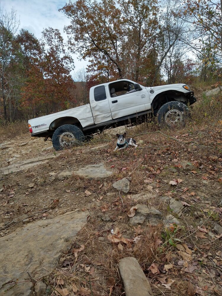

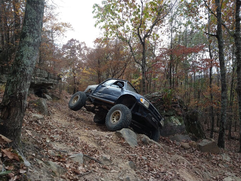

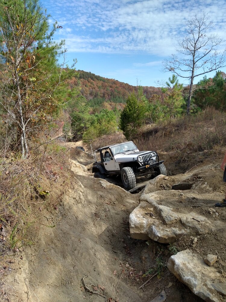

Them damn things are hateful! We both fought with them at GER. Sounds like seats and harnesses need to be in the winter plans too haha.
Duane
Duane

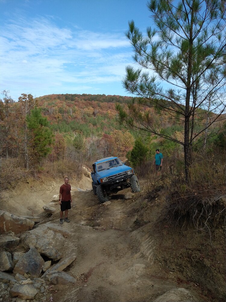

It was of course going down the obstacle in my above pics with the blue Tacoma lifting a tire. I don't think I ended up lifting one, but wanted to be buckled in. I need to see if I can buy those clips they have on semi seat belts to keep the shoulder strap loose.

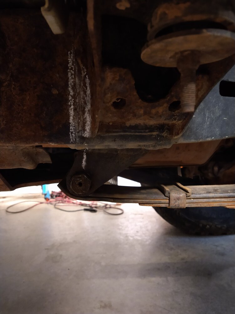

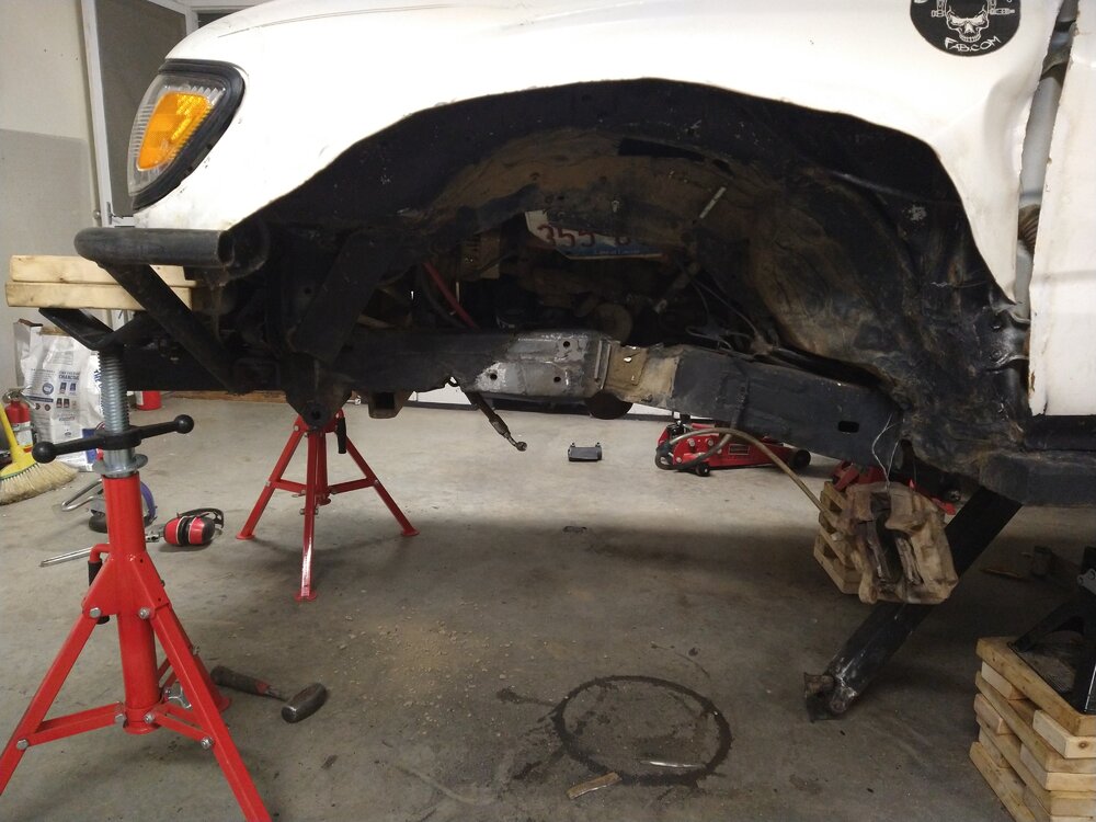

I have no idea why I did this with the rear shackle hangar, I plan of flipping that around 180* and that will move the front axle forward 4.5". I assume I'm going to find out why I did that after I get balls deep into this.

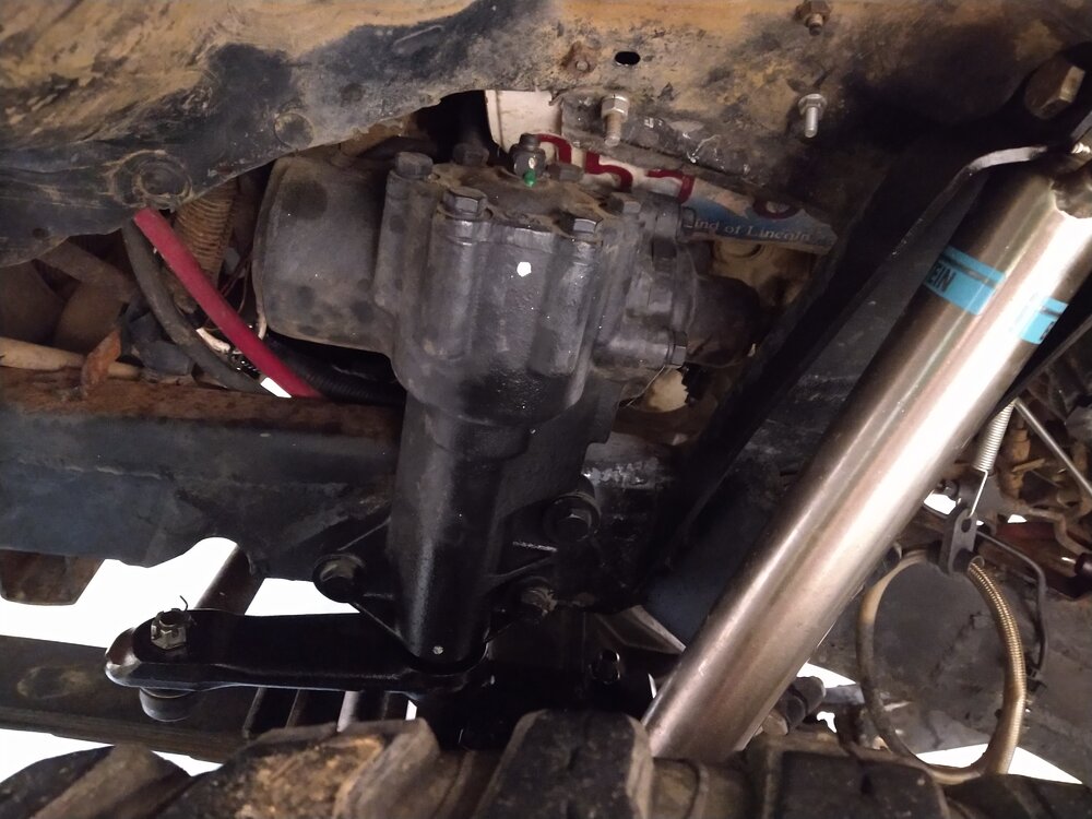

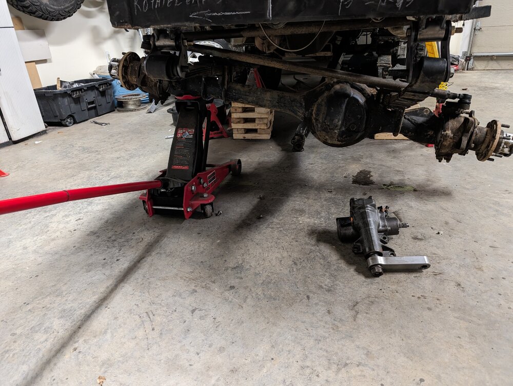

I hated installing this Ford box, I hated.making the mount for it, I hated building around it and it constantly overheating, but damn did it steer nice on the street LOL!! So this big bastard is going bye bye. I'm also going to chain the motor mount while I'm back there as shifters flopping around inside the cab gets old.

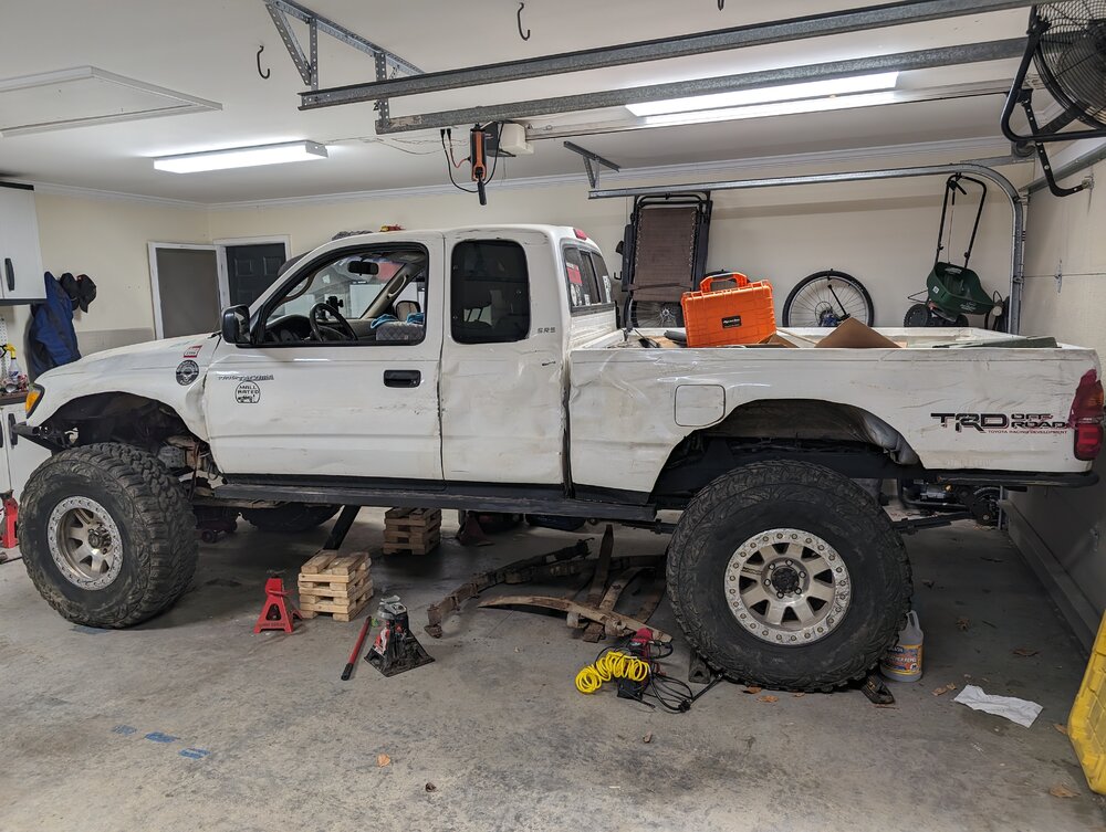

Side view of the front axle, she's too far back
The bad part about this from a pocket book perspective is the axle in the wrong spot was keeping me on a max tire size of 37s, well moving it will probably change that! :D

Yea it's basically cutting the leaf hangar off and spinning it around and that gives me 4.5" right there. Leafs for another season or two. They work, and I already have them. After wheeling with a few other full bodied toyotas, also on 37s, that were linked the performance didn't look that much different than what I have now. Granted they could bomb down the trail quicker, but whatever.

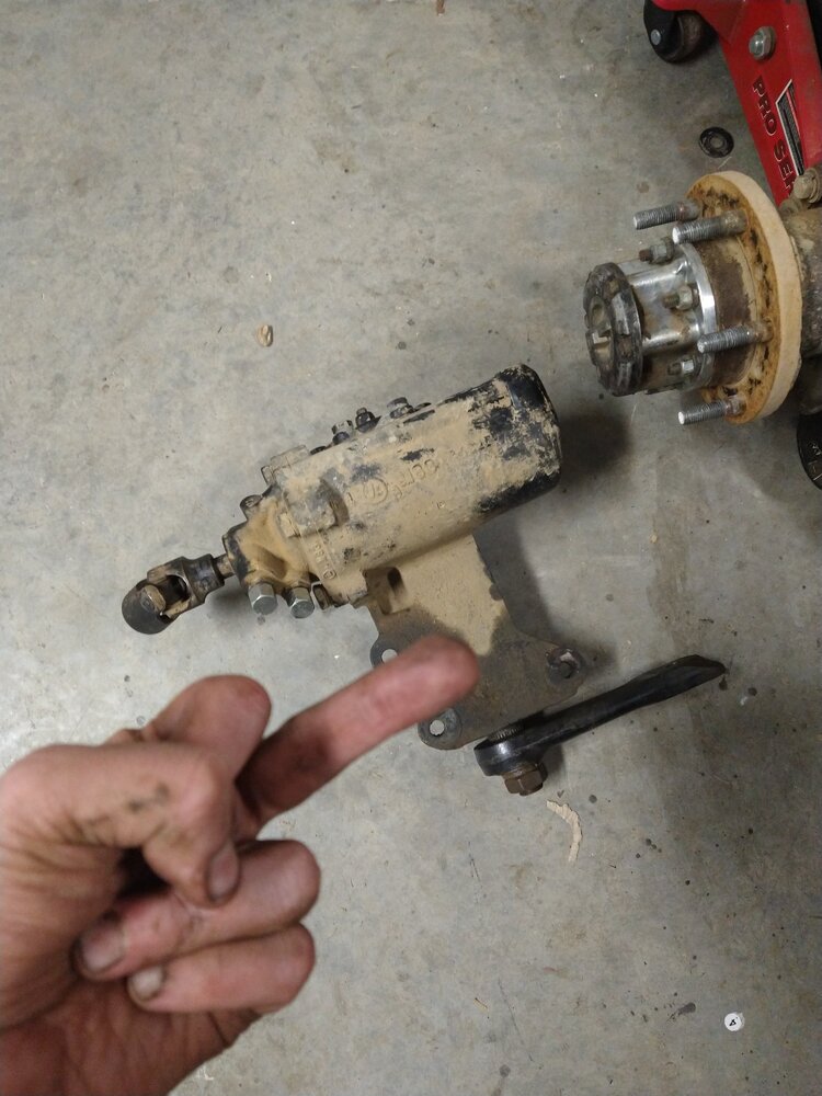

Bye bye big ass Ford box:

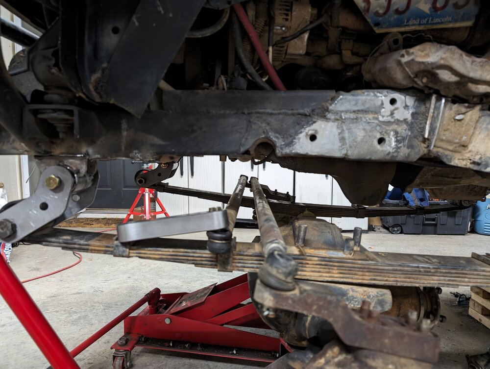

I called it quits when I got it to the point of cutting mounts off and welding stuff back on. I'll do that later in the weekend, I instead laid under it with a flashlight looking for anything that needs to be repaired, and outside of the driver's side frame rail being bent down from what I believe was the same winching on white tail crawl that bent my rear frame horribly bad a few years back, everything looks good. I did boring stuff like take measurements to get ready to start reassembling stuff.

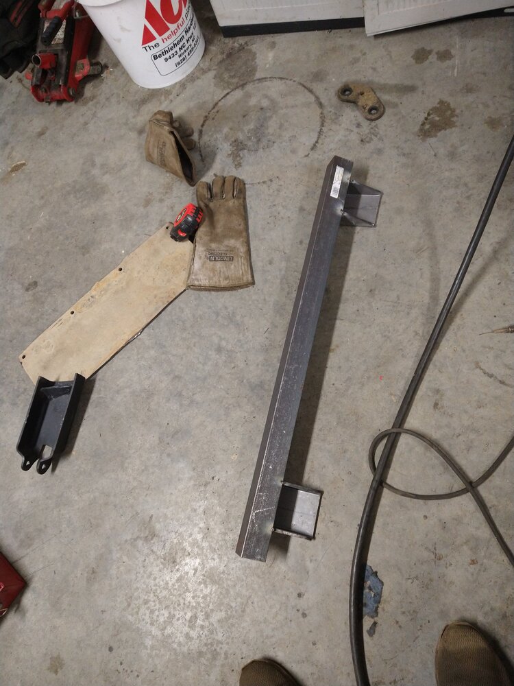

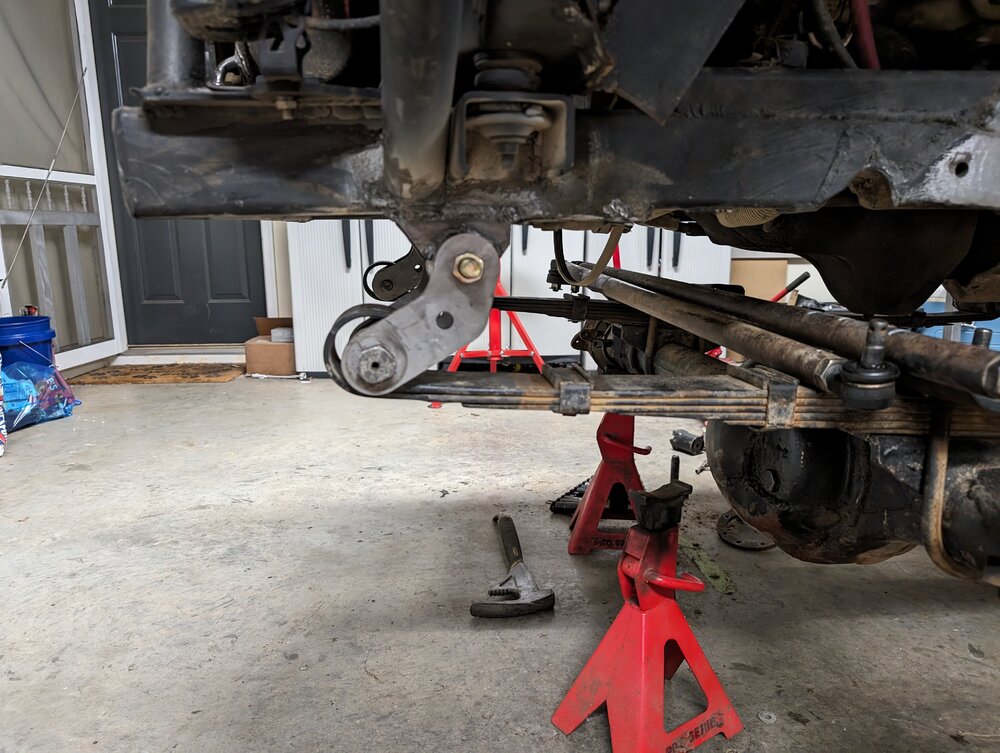

Got out in the garage today, spent most of the day showering myself in sparks and grinding disc pieces. The other half of the day was measuring stuff, I actually made a jig so the front suspension hangars are actually square this time! Probably one more crap 6hr day of cutting stuff off and grinding left then some real progress will start getting made. I really need to buy a damn plasma cutter.
Driverside shock mount and bump can gone, I way overkilled that install and paid for it today lol!
Jig for the leaf hangars, actually got it centered under the truck so that's awesome!

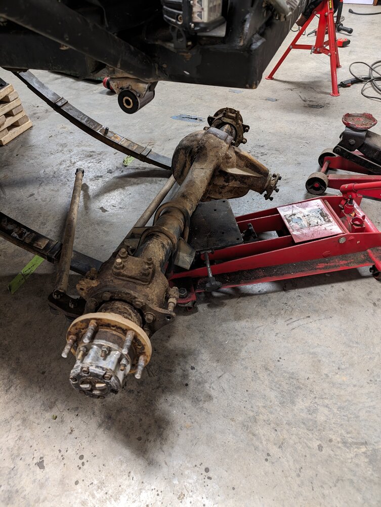

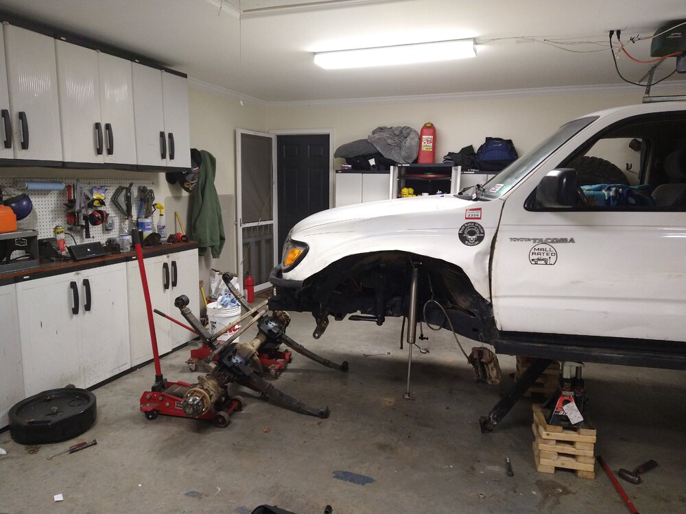

Didn't get as far as I wanted to tonight, but getting closer. Swung the axle under the truck, not without some drama first:
:laughing:
Realized one of my leaf mounts is angled outward so I need to fix that. So I gained uptravel at the oil pan, however the damn drag link is now going to not play nice with the AC idler pulley. So I need to find a solution for that problem that does not involve full hydro steering or ditch the AC.

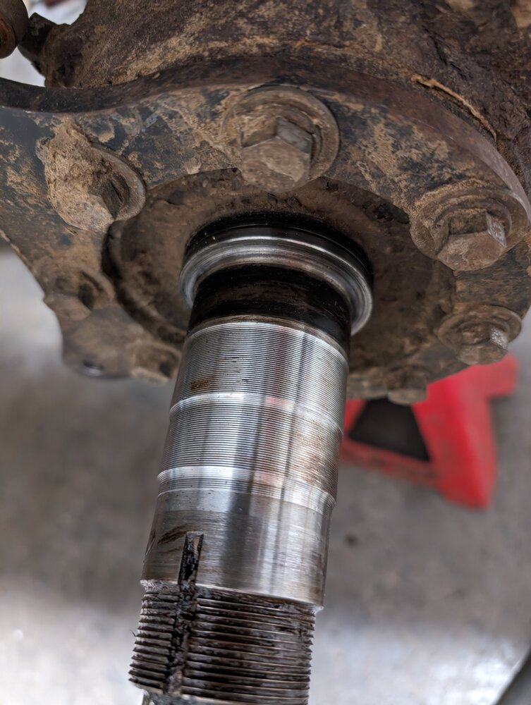

I stopped before fully welding the shackle and spring mounts. Flux core welding in a garage with the doors and windows shut sucks and it's too cold to open them, so I'll mess with that later this weekend during the day. Should start going quick after I get those burned in. I found a front wheel bearing that feels like it has gravel in it, weird because they ran cool and didn't make any noise.
:laughing:
Realized one of my leaf mounts is angle outward so I need to fix that. So I gained uptravel at the oil pan, however the damn drag link is now going to not play nice with the AC idler pulley. So I need to find a solution for that problem that does not involve full hydro steering or ditch the AC.

Burned in the hangars and shackle mounts tonight. Getting ready to actually start bolting stuff back on this thing. Need to figure out what I'm going to do with the drag link hitting the AC idler pulley. A member on another forum recommended a stretch belts, so I may try that and trim the bracket. Next big hurdle is mounting the steering box after I swing the axle under and it SHOULD be down hill aside from messing with the hydro assist.

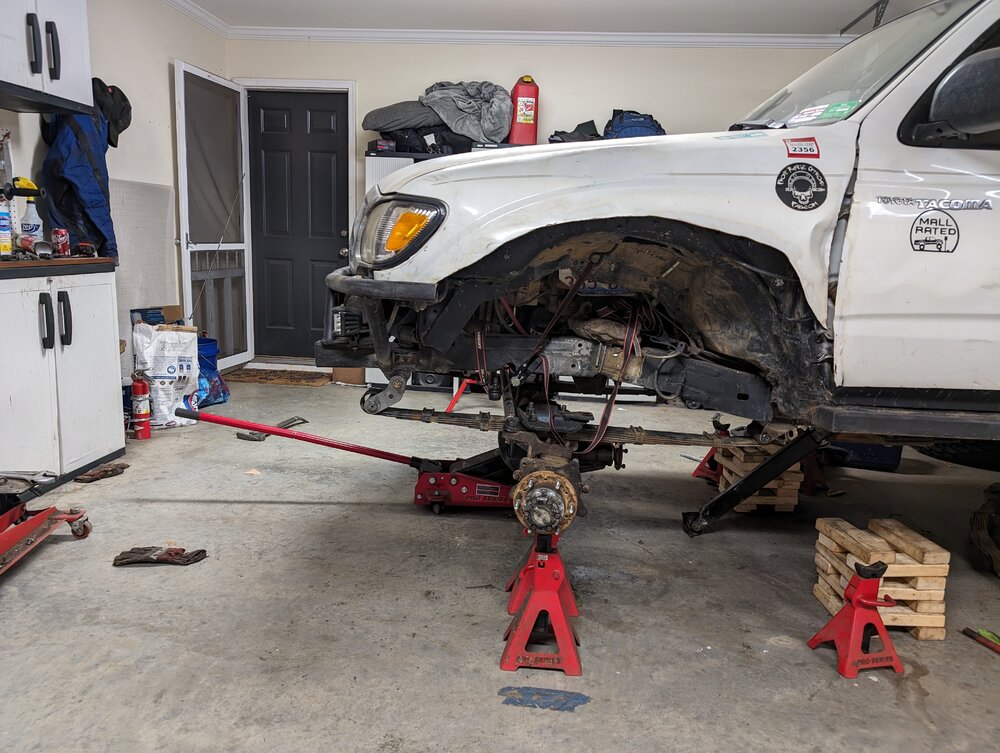

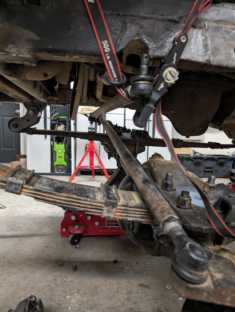

Did some wrenching tonight and swung the axle under the truck to flex it out and see what hits what.
So the draglink looks like it's going to kiss the AC idler pulley in certain situations. I still think I'm going to ditch that idler and replace it with a stretch belt and cut the bottom of the bracket off and never have to worry about it again.

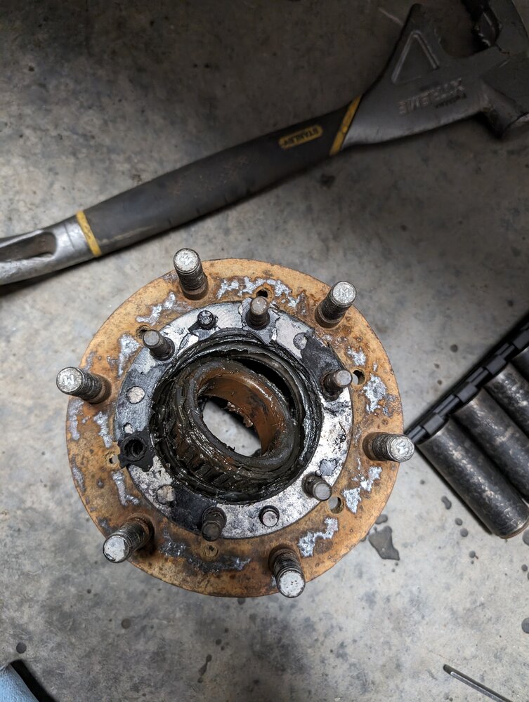

Next up I stripped the axle down, pax side wheel bearing was CRUNCHY
The RCV looked good and no leaking inner axle seals, that's a miracle as I built this axle not using a true bar and have no idea wtf I was doing in 2016.
Shackle angle looks good, just like before

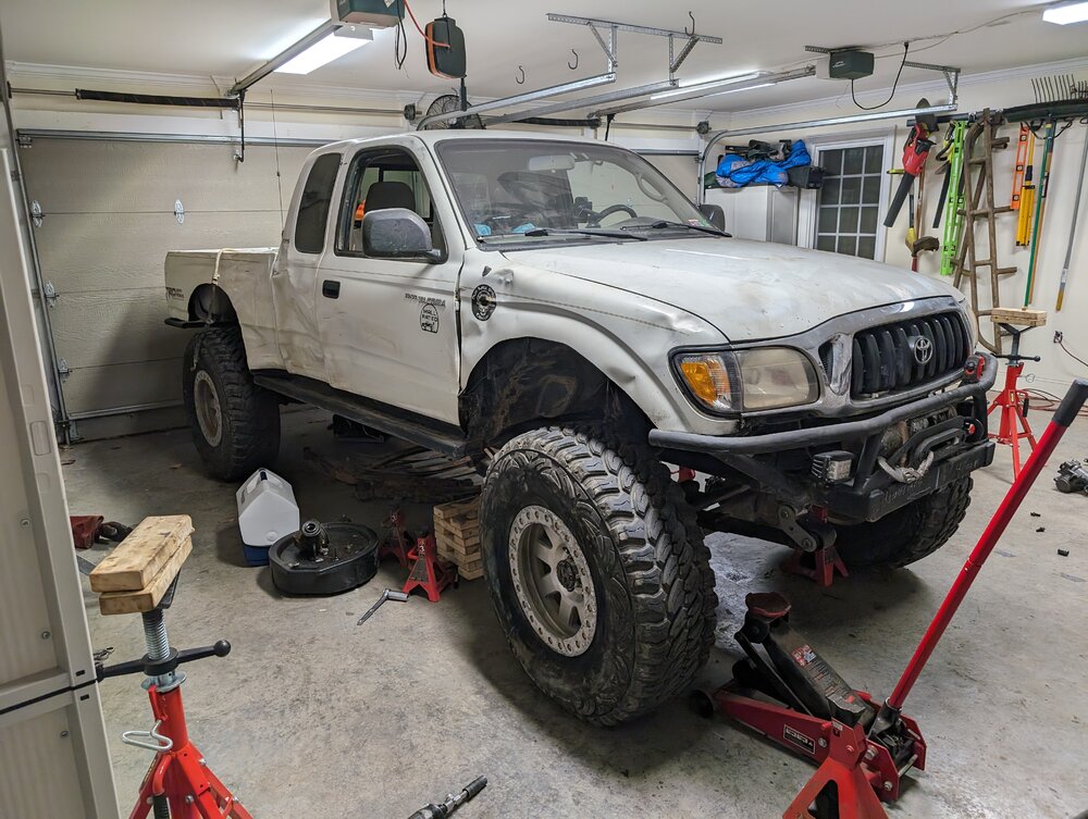

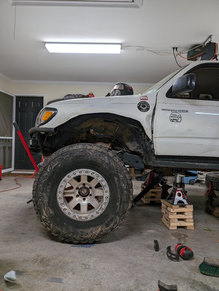

Had it back sitting on jackstands on the axle which is nice:
I had to slap the tires on it just to see again, it's been sitting for too long without a front axle under it.
So next up I have to do the 5th stud mod, clearance the knuckles some more in hopes of getting some steering angle back (only has 4.5" of total steering throw), notch the frame on both sides for steering clearance, and mount the steering box. Once that damn steering box is on, I will be over a major mental hurdle. I hated doing that with the previous box and I'm all in my head about it.
