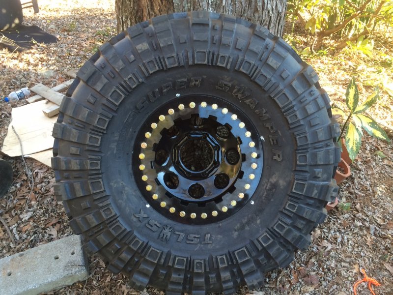

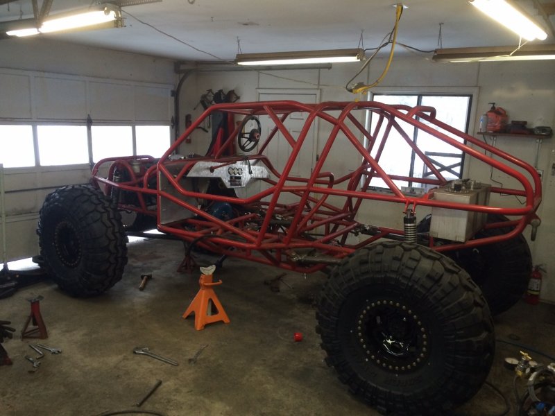

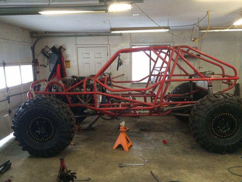

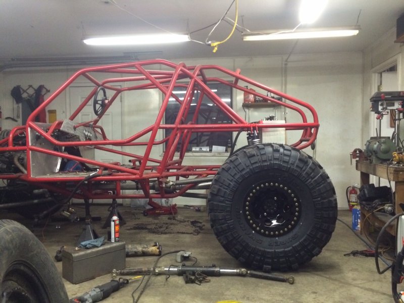

Where did the beadlock kit come from?
Total metal innovations, that's the only thing I sourced that wasn't local, I also have a 1" inner 1/4" ring for a stiffener, Tyler uses anti coning built into the weld on ring, nicest beadlocks I have seen or used
Ryan from 4wheel parts hooked me up with the rims
Man I had great customer service and fast shipping
Wish I could say the same took almost 2 weeks to get mine they have no telephone to call only email at his convenience. I have a spare set of rings from my last set been thinking about taking it somewhere local ad having my new ones cut out but it really is a lot of metal for the coin

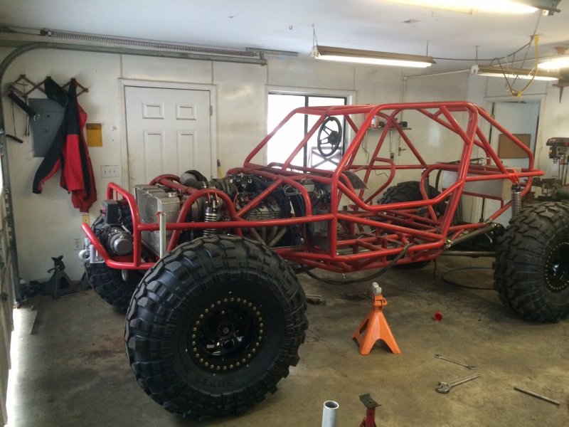

I'm just going by what the guys at Advance told me. They told me not to waste my money believe it or not. I know two people w/ 4-speeds one likes it but never uses it and the other said it was a waste of money. Both running autos.
I'm running 4.56 gears in my axles and 3.8 2-speed and am extremely happy w/ my gearing. I wheel mostly in 2nd and can really crawl in 1st. Guess the only difference in my transmission. I'm running a t-18 w/ 6.32 1st and 3.09 second. I'm guessing your running an automatic. I don't really know how the gearing and the torque converter come into play on an auto. Never have studied it.
Just passing on the info and experience I've recieved through my build.
You missed a hell of a ride today. There was a bunch of rockwell buggies there. Seen one outer broke on one.
Beadlocks look killer.
My auto will have half that first gear, I am going to get the 4 speed
Man that sucks, sorry to hear that, Tyler stayed in touch with me through private messages on Pirate4x4
I even changed my order twice, couldn't make my mind up on the outer rings
I thought they looked familiar. I looked at those, love the anti coning set up on them. How did price compare with shipping?
Link to what you got? Can't seem to find them now. I need a new 15" set.
