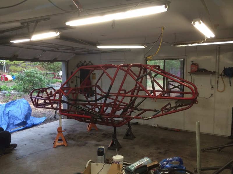

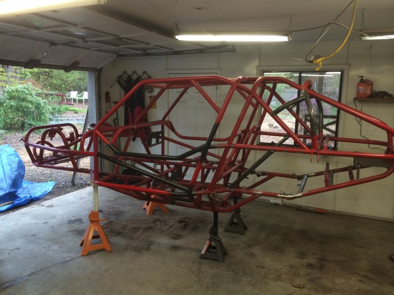

2nd chance buggy
Looking good. Things have come a long way since the yellow buggy days...
I'm getting ready to use a piece of the square tube. I wasn't talking bad about it, Just reminiscing.

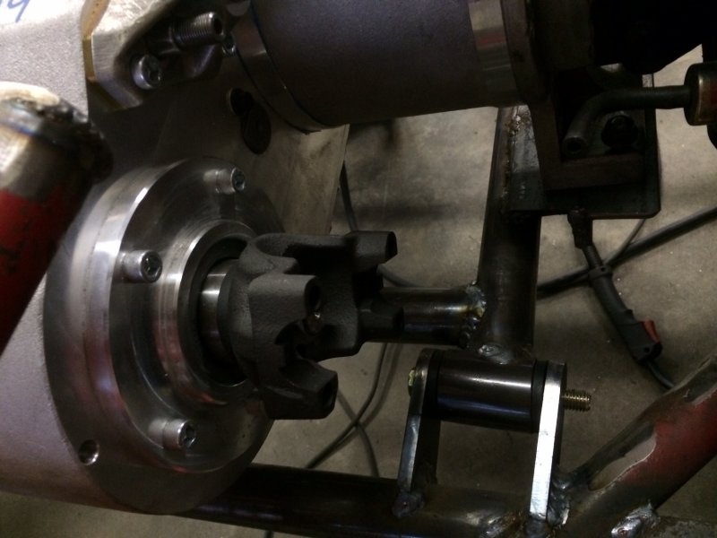

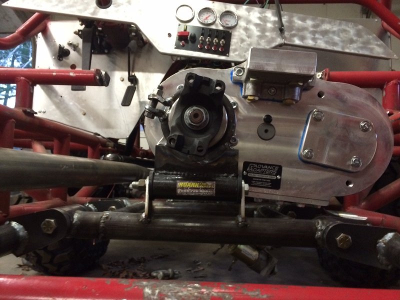

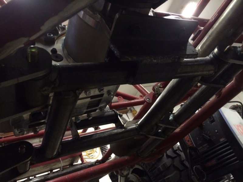

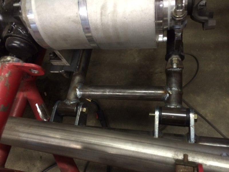

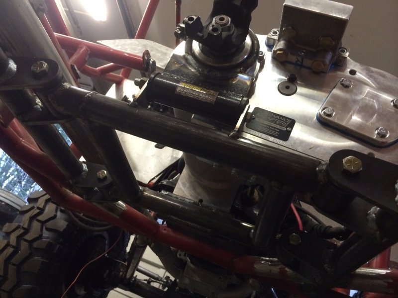

Gonna build another cross member for a atlas support ring coming this weekend
I would suggest attaching the rear support ring off the same cross member, to eliminate twisting against the adapter/tail
So I was wrong about advance adapters changing there output, appartently I got a bastard rear output that they can't reproduce

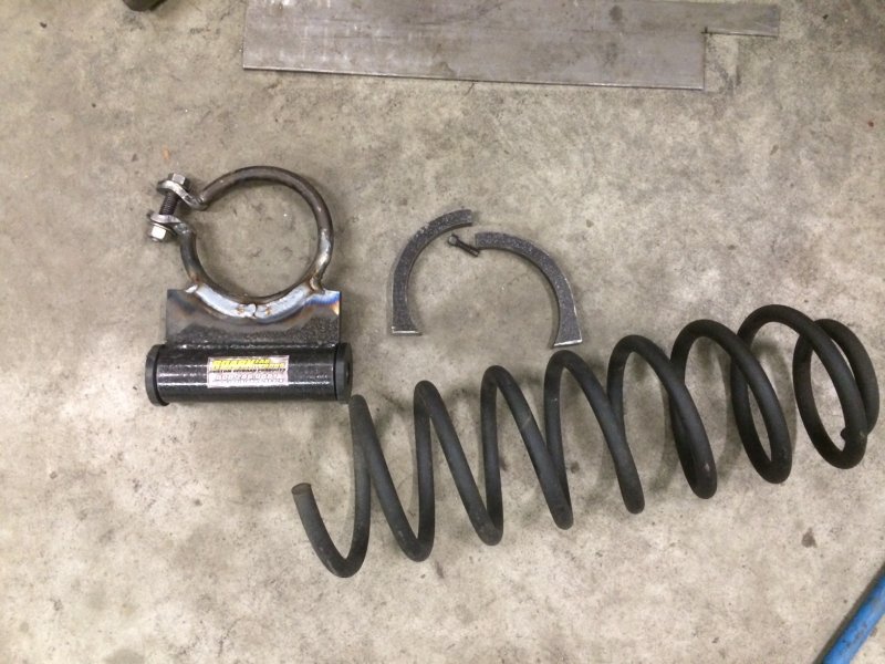

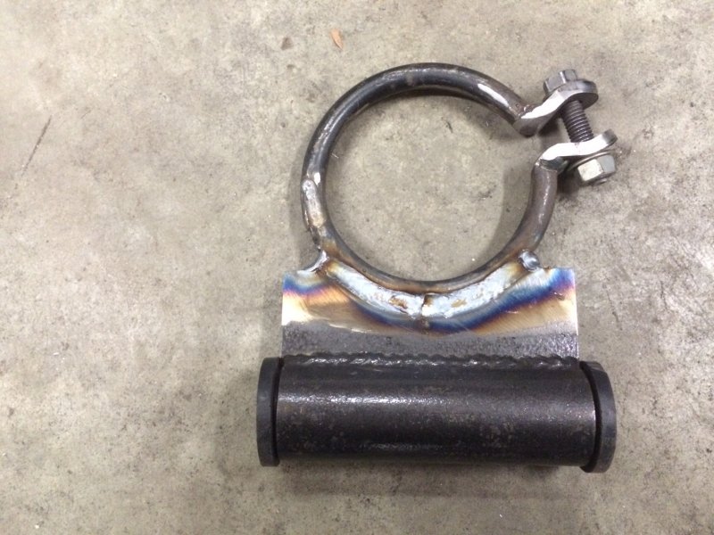

I thought about selling this support ring and having a new one made, I tossed around the idea of building one, then I saw a set of old stock TJ coils laying in the corner and had an idea, with a little work I made it work modifying the existing ring
I say that you strip it to bare metal and let it rust.
That way it matches your brothers rig!
you can't weld spring steel it will stress fracture not trying to be a ass just don't want to see that atlas or something come apart lol
