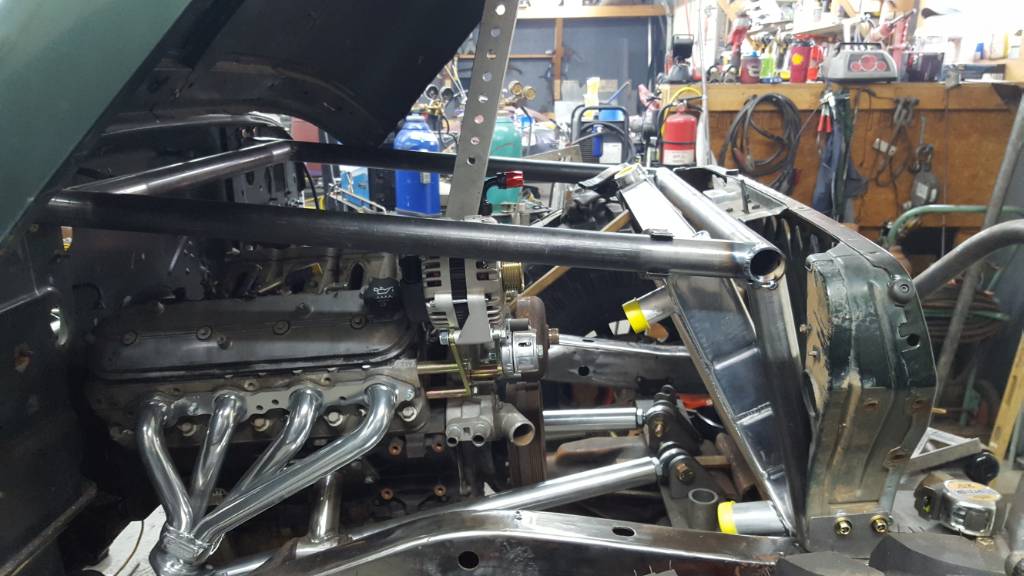

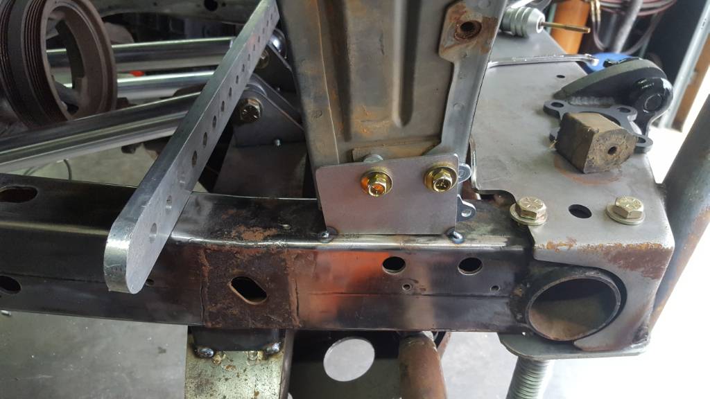

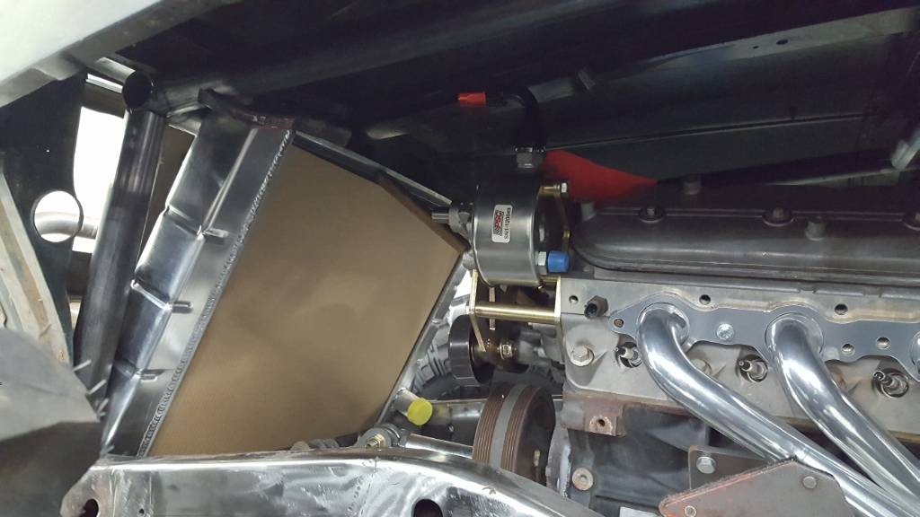

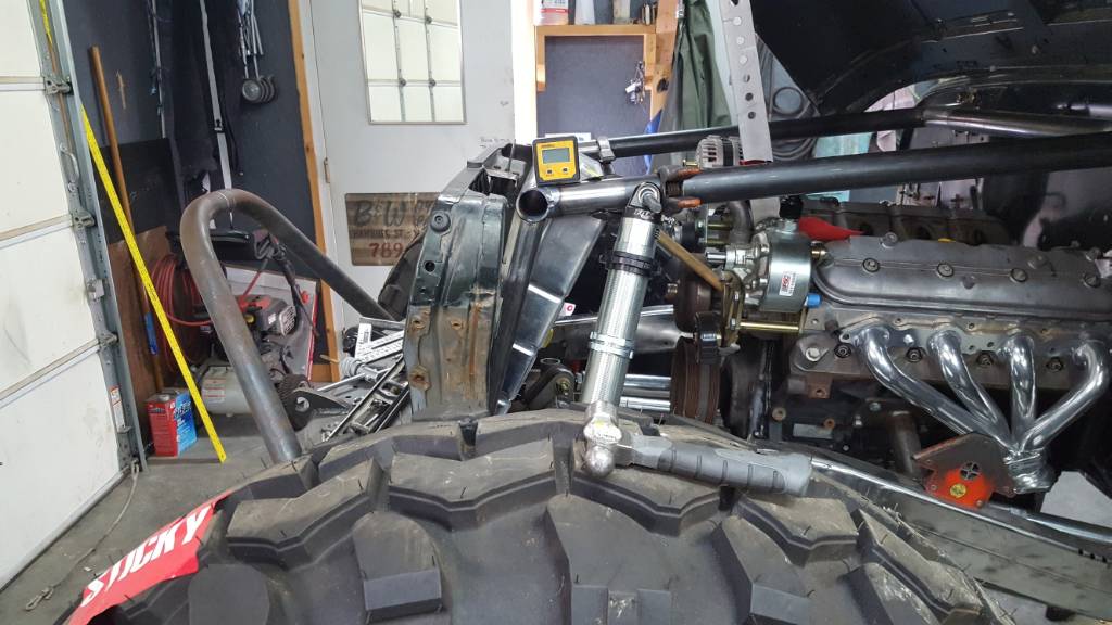

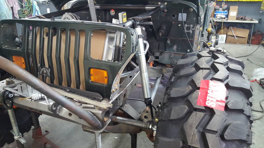

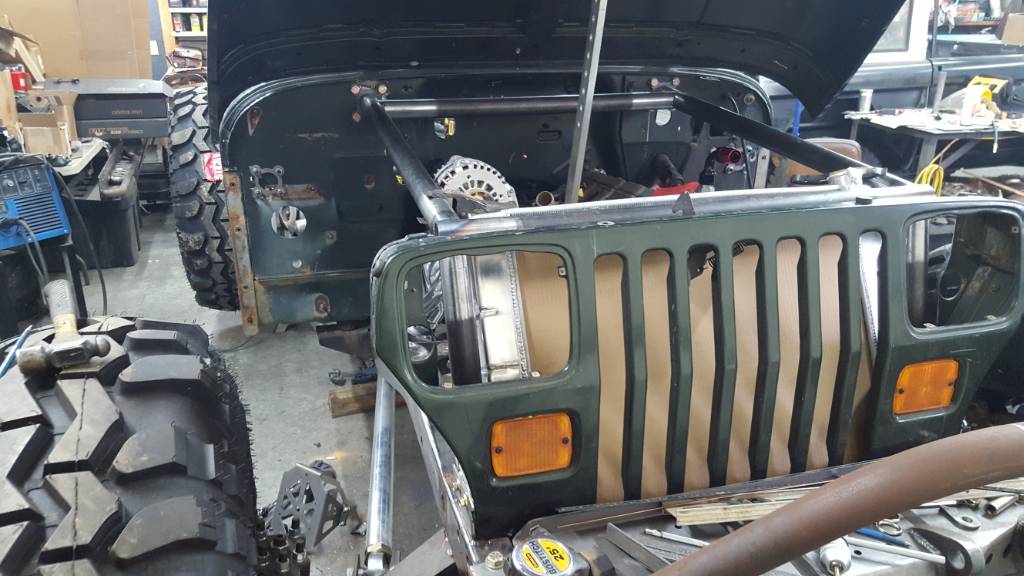

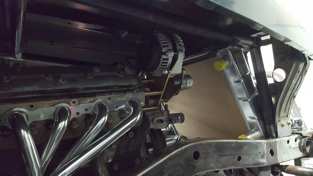

Grill location is nailed down. Slightly forward on the bottom for more radiator clearance, and to get the hood line down a bit.

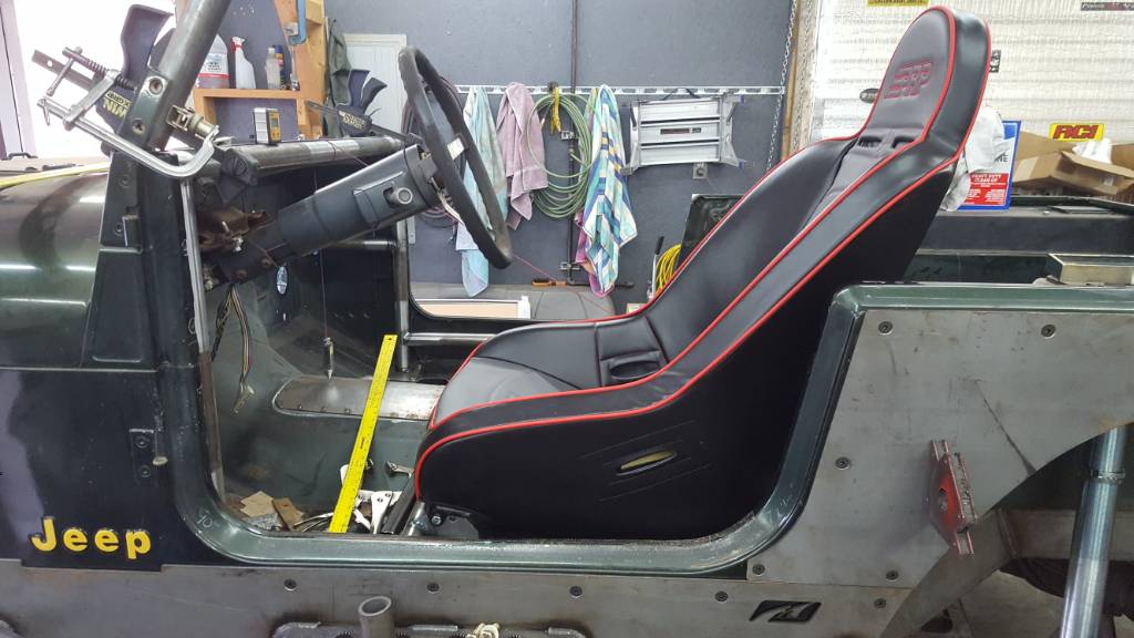

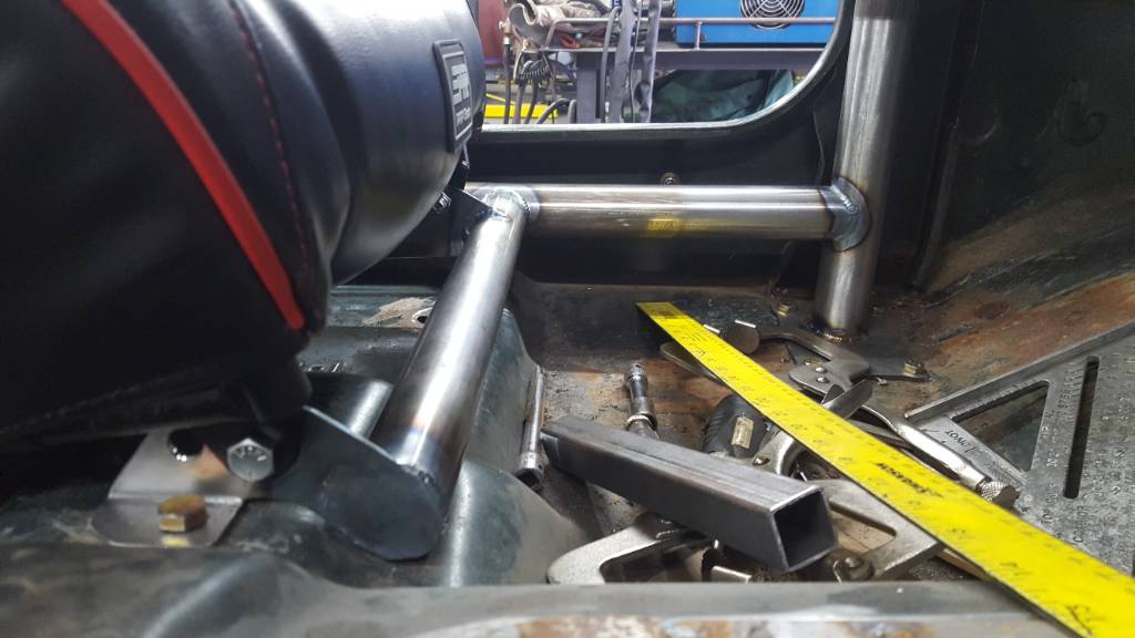

Bunch off random stuff. No great direction yet. Seat is ready for fitting for the owner; in order to determine pedal placement, roof height, sight line over dash/hood.

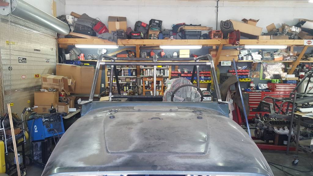

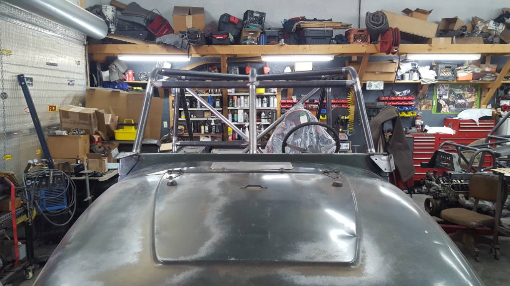

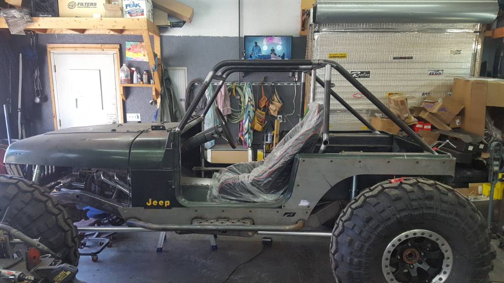

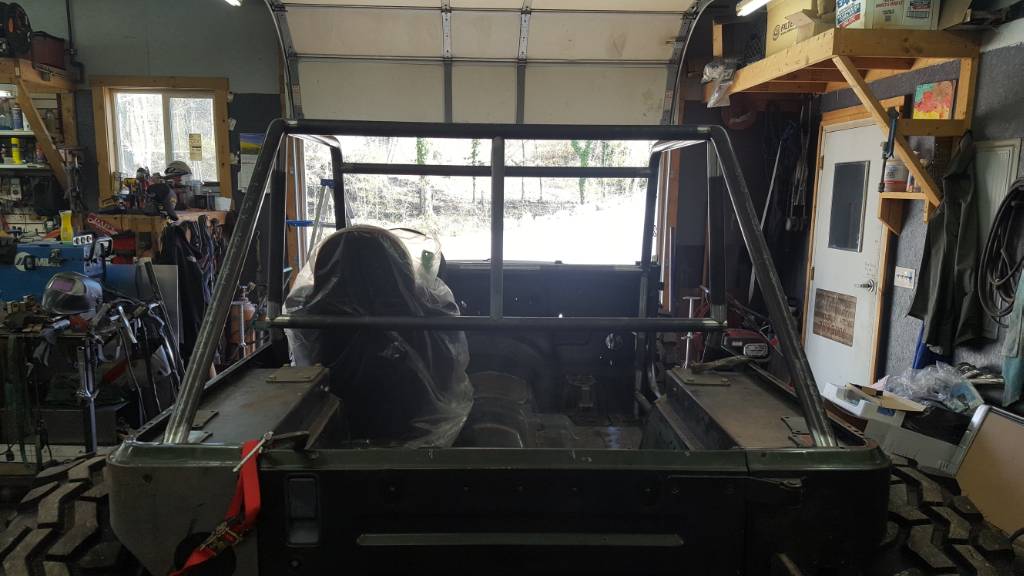

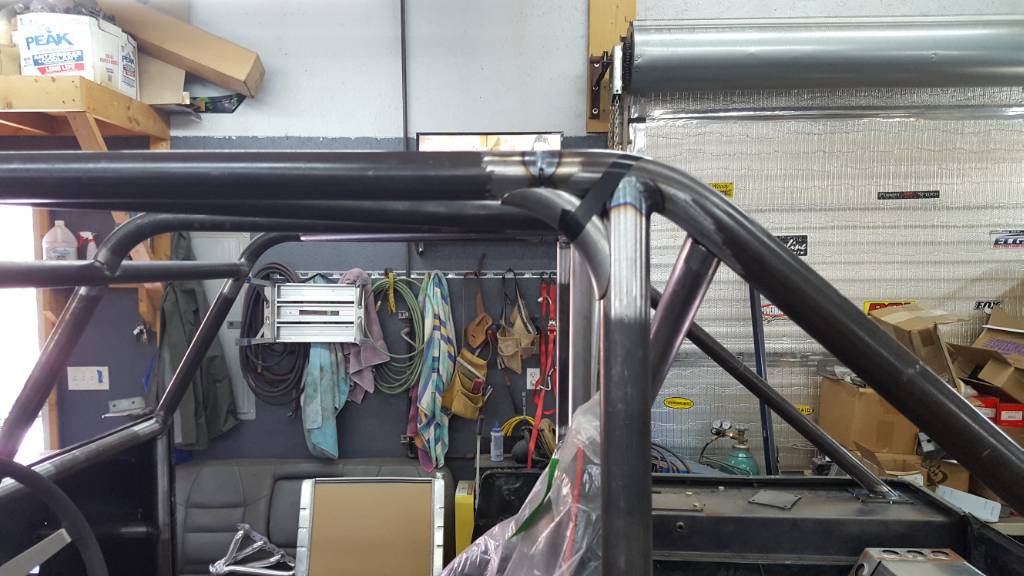

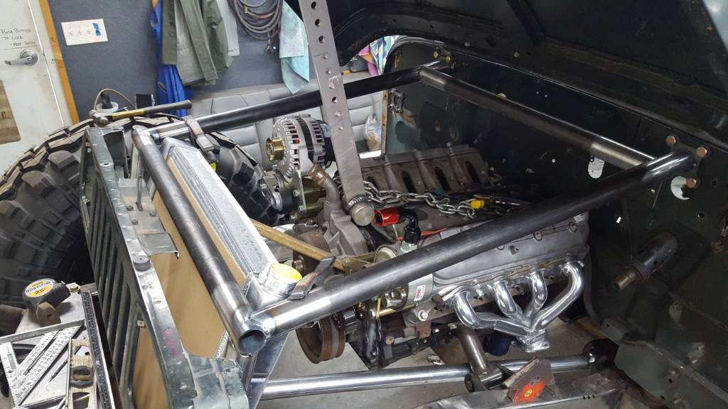

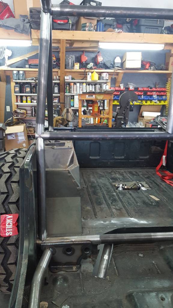

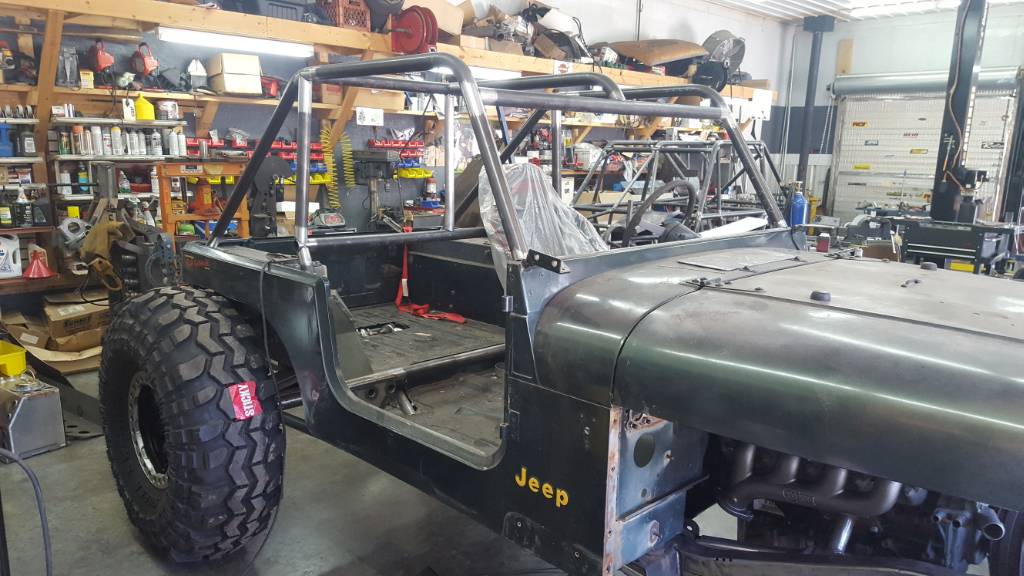

The front clip is outlined and mapped out. I I have a pretty comprehensive grasp of how I will proceed the entirety of the build now. Once David drops by for some measurements and approval of a few details I have in mind, Katie bar the doors....
Obviously my tube work is very go-fast inspired, but once all the other pieces take shape, she'll be quite attractive and pleasing to the eye.

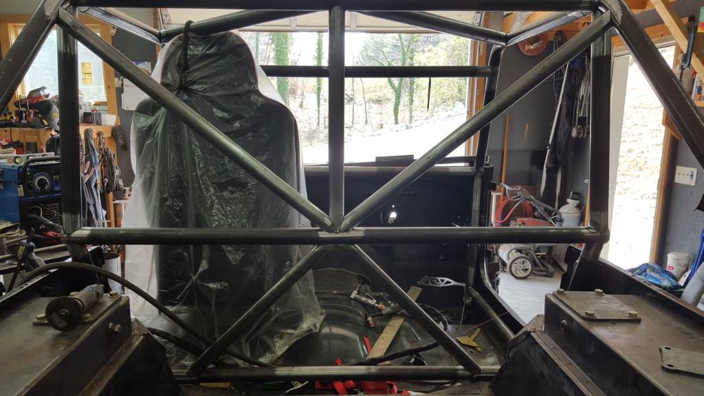

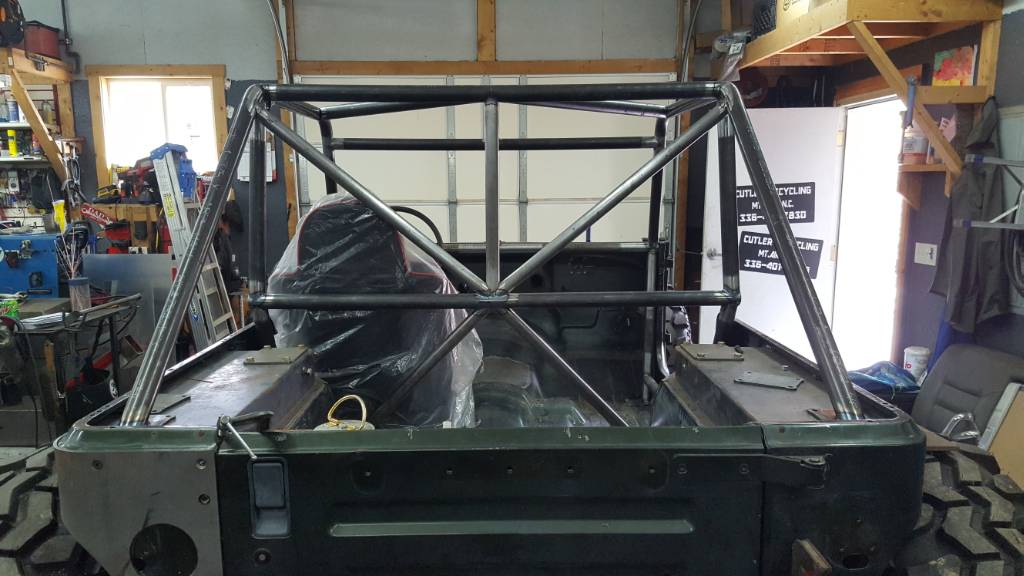

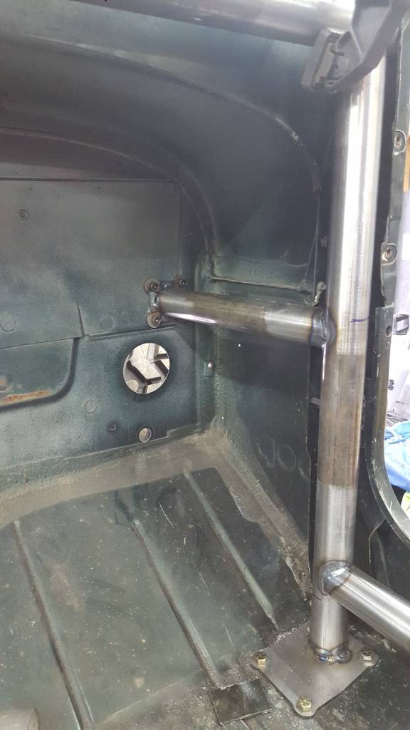

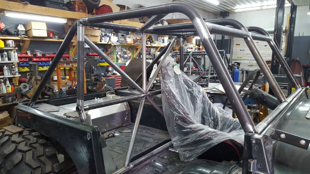

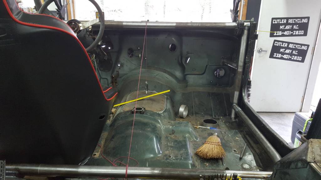

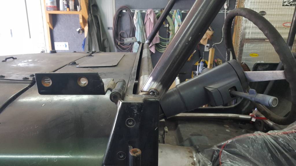

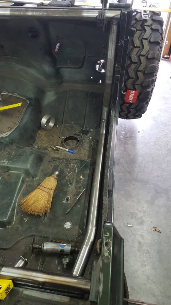

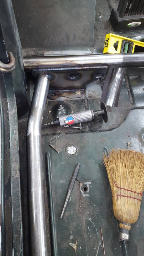

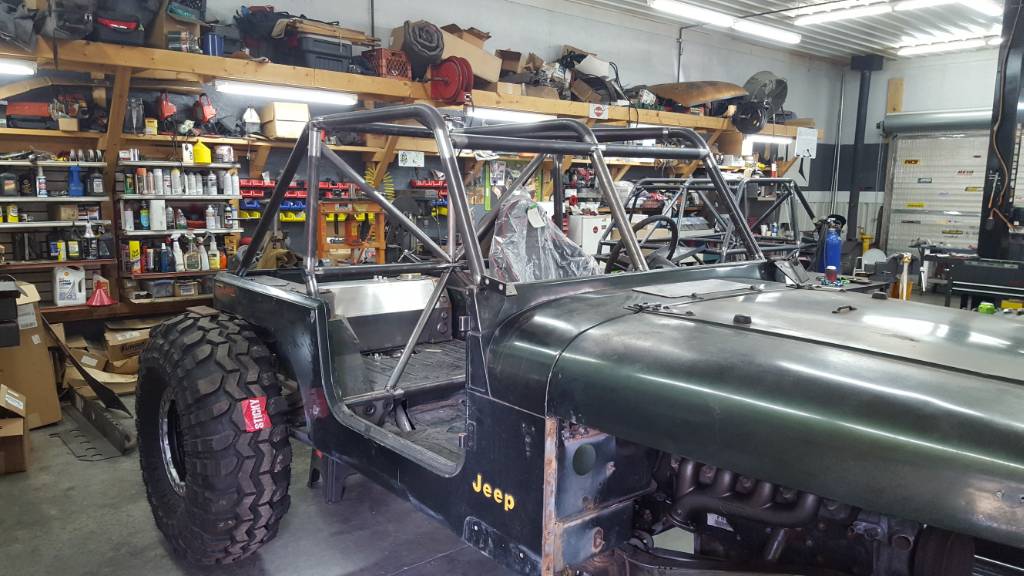

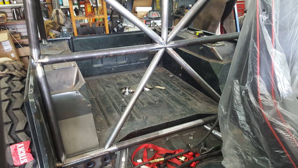

@mcutler I recall you saying your not a big fan of bending tube, on this jeep cage is the only long bent tube the one from A pillar to the rear?? I may have to rescan the mache build I just noticed that you section the tube! Is it faster to notch/section it for you then bend? I despise bending myself hence why I'm asking... lol
Correct. From tip of dash to b post then b post to fender. Splices are fine if sleeved and rosette welded correctly, then supported behind a gusset.
Sent from my SM-G925R4 using Tapatalk
So instead of bending one tube 2 times you have two tubes bent once and welded together? What is the advantage besides a whole lot less math!? I'd love to see the proper way to section the tube. I would assume 1.75 would have 1.5 inserted into it with rosette welds on each side and then welded together. Close?
Yep, less math, which is not a problem for me, but the ease of working alone is why I choose this route.
About an 8" slug, with a couple 4 rosettes in each side in two planes. 3/16 gap, heavy bevel at the joint. Or you can buy the joint sleeve from TMR.
