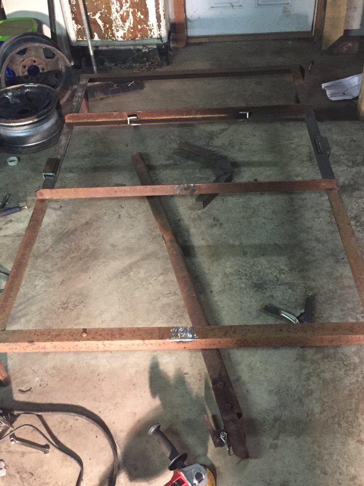

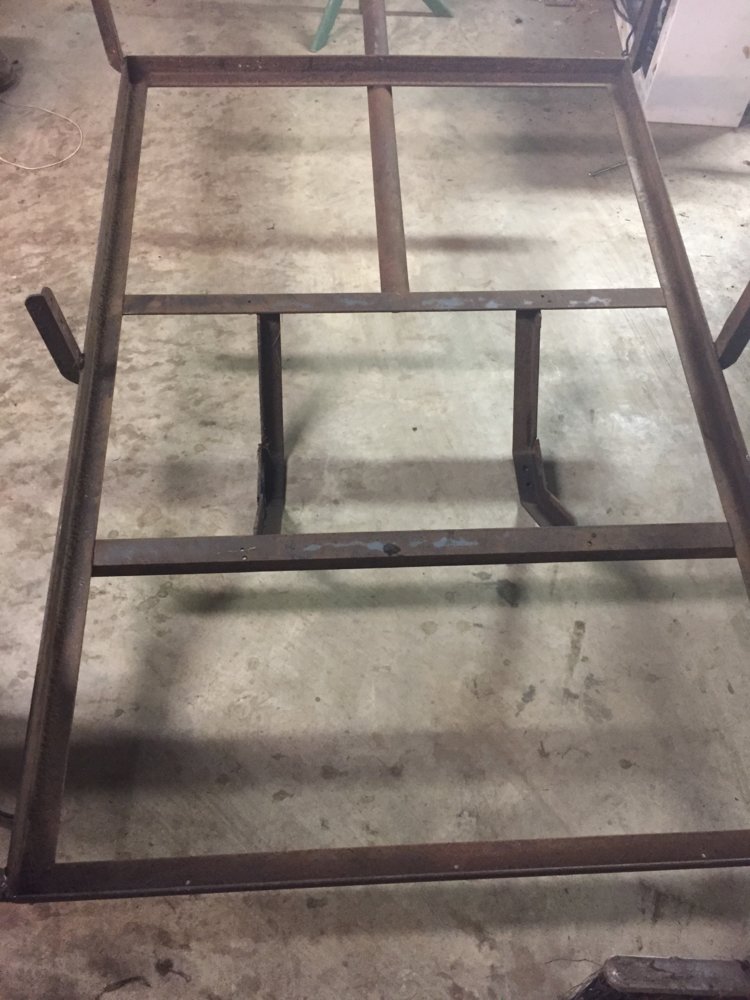

Ok so started on this 4x6 trailer and was gonna do just a hub swap leave it solid axle and new tires but after seeing frame was 1/4” and still in great rusty shape I decided to make a trail/utility/camp trailer on a cheap 2000lb square tube axle/1350lb hubs on xj steelies and goal is 33” tires.
As I brought it home minus the 46” axle under neath and 2 piece aluminum wheels! The tongue was roughly 30” to start with!

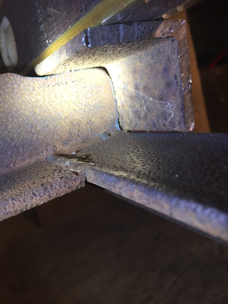

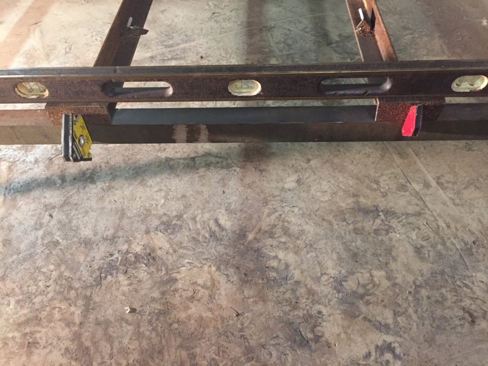

I cut out all the rusted solid axle parts and have started making risers for the leaf spring hangers, simply bc the frame is 1”ish lower than I was wanting with leafs the solid axle mount was 2-3” taller so cog is down where I want it with risers still a lot of grinding to do!

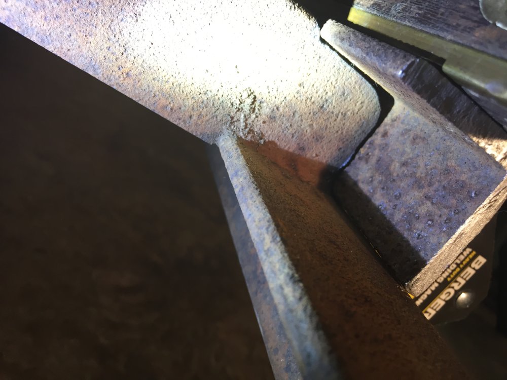

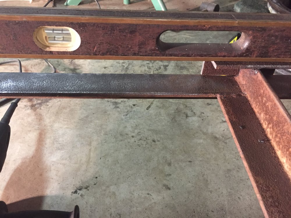

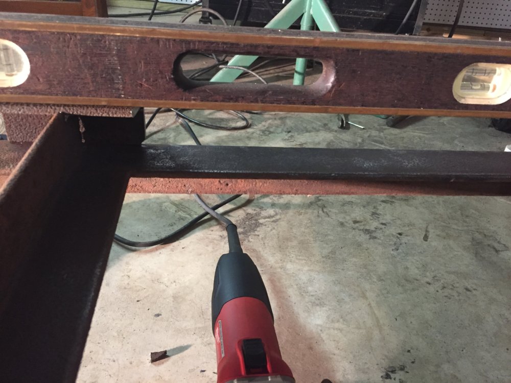

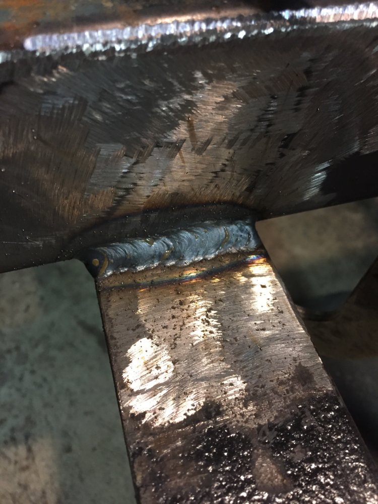

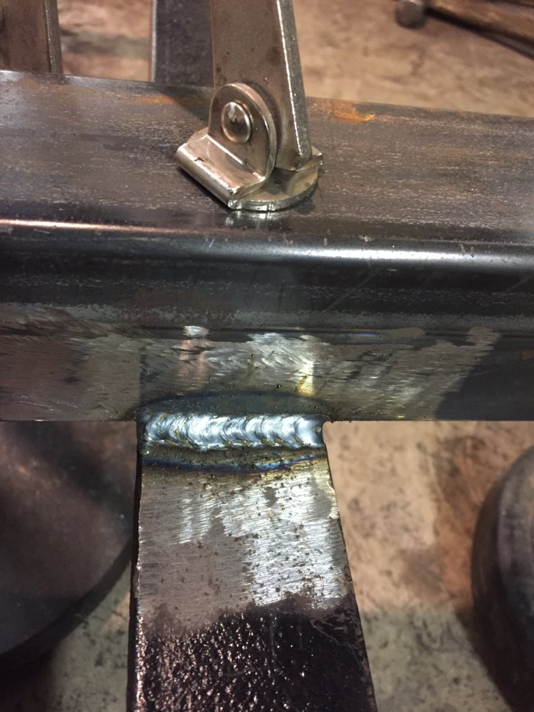

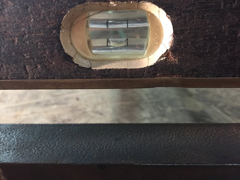

Got one side of risers grinder and lvl curious on your all’s thoughts on these risers... and don’t make fun of my old ass level either
Using the cross beams as gusset sorta curious if I need to add another support or box the riser on inside

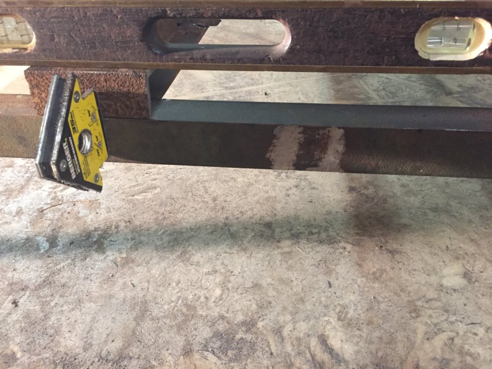

Other side grinded and leveled up!
Solution for sketchy risers... makes me feel safer already! I’ll probably be selling this thing cheap after I finish it bc now I want to build another one with a diff axle and setup!

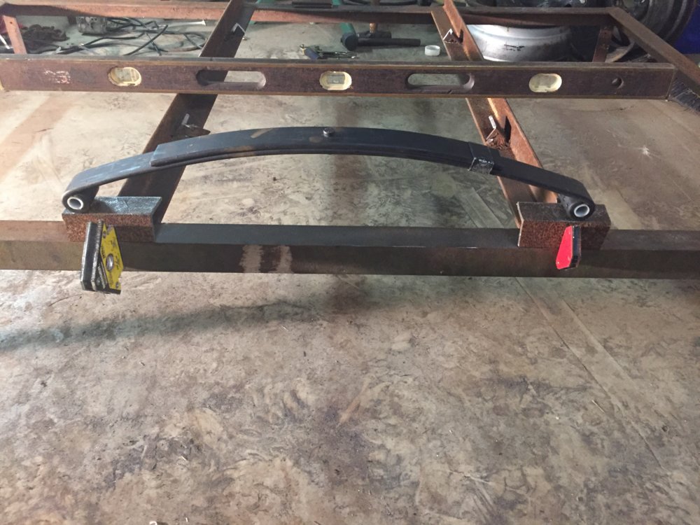

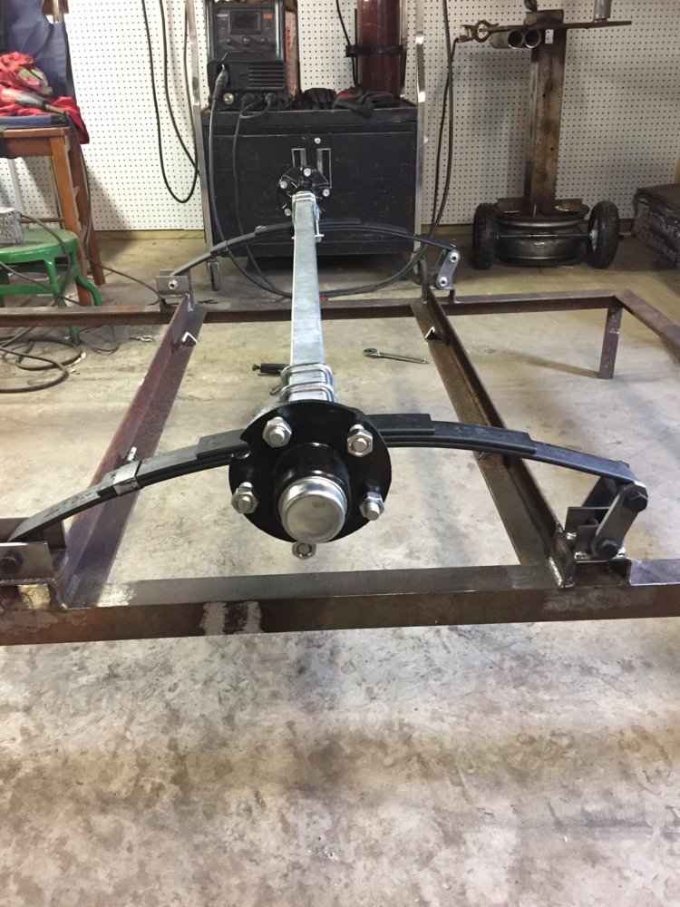

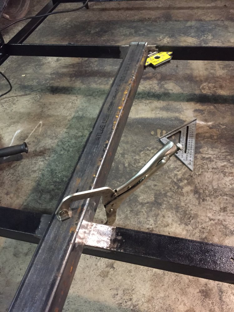

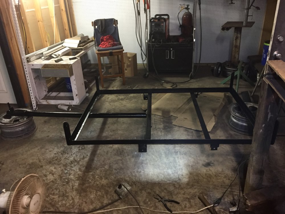

Alright we’ll i gotta say it been fun setting up the axle and shackle angles making sure all is square and safe, Ive enjoyed it! Suspension is done and hangers burnt in! Changing routes on the wheel selection bc xj wheels are just too wide for this axle width even tho they clear... Wagon wheel and maybe a 31x10.50 tire still on the fence I used 2000lb springs just so it can hold the solid 2k axle weight!!
Still need 3x3 square tube to make the tongue, non adjustable on this one tho just straight bar with some triangulation! May add wood sides on this that are removable before it’s sold. I haven’t decided tho def going wood deck haven’t decided on barn door style back or drop tailgate style the rails will be roughly 13-15” high out of angle maybe small square!
Shackle angle to much, anyone got a opinion?? I measured that bitch 10 times lol still a lot of grinding to do, I’ll not know how to act when building another one with new metal...

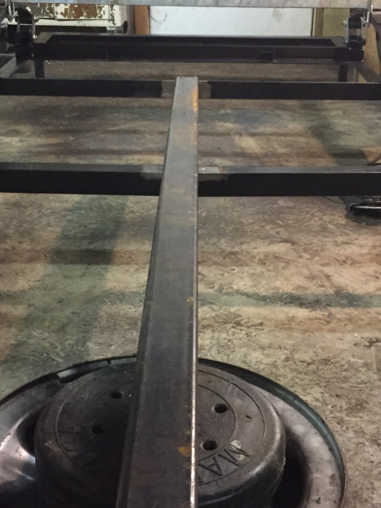

Well decided to just weld old tongue back on paint it and say fuck it, but then deep down my heart wouldn’t let it stay that way... smdh so tongue cut back off again! 2.5x2.5 11gauge square tongue 4’5” and may end up adjustable!

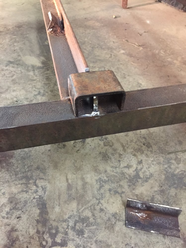

Ehhh not to shabby I don’t reckon! Paint will cover it anyway... tongues welded in I added 4 tie downs with angle iron on the sides! I’ve got 16’ of 1.5” square tube but not sure if it’s gonna be used or not! May do angle for rail too it’s cheaper an use square for my truck seat mounts!

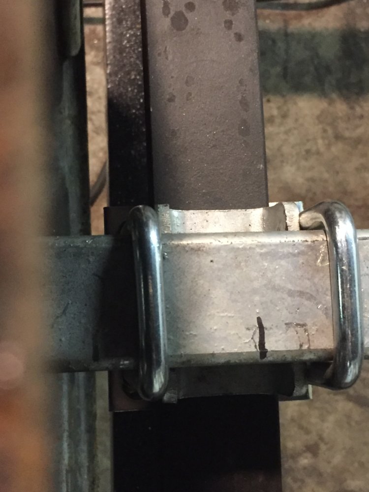

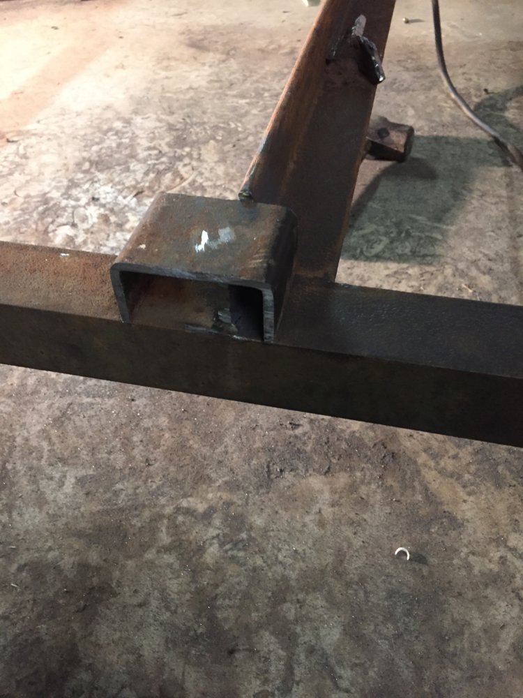

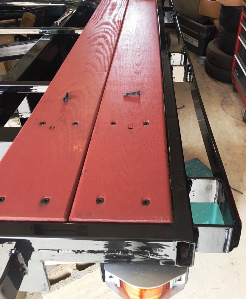

Built a 10'x8' deck over trailer while back.
Made rub rail pockets and welded on a rub rail.
Pockets an rub rails Really comes in hand when strapping stuff down.
Just be sure to make the pockets a stand away far enough from the sides to get the hooks of your straps through.

Make top rails for the sides, like a landscape trailer. It makes the trailer a hell of a lot stiffer.
