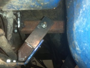

I rebuilt the trans crossmember to facilitate easier install of exhaust and in preparation for my doubler install me and timc then made up some simple dual exhaust with crossover that side exits near the rockrail in front of the tire
