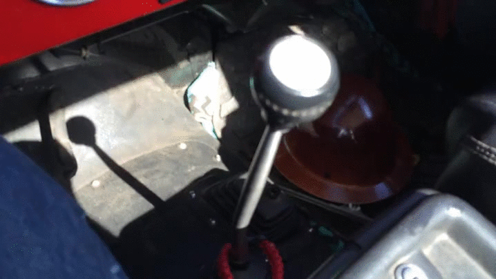

@CAROLINA ROCKRUNNER I think you might be on the right track. Took it out to try to get a video of how much you can see the movement in the stick and it hit me that this might be coming from the front. There is zero movement in the wheel though.

.gif of the video. I wasn't going too fast as there was too much traffic. This also isn't nearly as strong as it gets, but you get the idea
Direct link to .gif: Imgur GIF

does the steering wheel shake like that also? If not, I doubt its in the front. Does the shifter vibrate like that all the time, or just at those speeds?

Nothing in the steering wheel, it actually tracks straight as an arrow. The shifter only does that as I get close to the 60mph zone, usually starts around 56/57mph, and gets way worse.

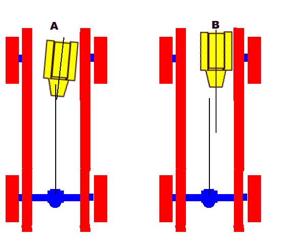

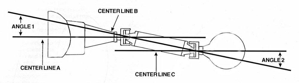

I was talking about the driveline being parallel to the frame, like this
the small amount you may be off side to side on your trans mount wouldn't be that noticeable. take the driveshaft loose on one end and turn it 180 degrees and try it again.
you bought new driveshafts, correct? Didn't pull them apart for any reason? Make sure the weights didn't fall off.
the small amount you may be off side to side on your trans mount wouldn't be that noticeable...
That's kind of what I was thinking.
..take the driveshaft loose on one end and turn it 180 degrees and try it again.
Yes, new shafts from Tom Woods. I didn't pull them apart or anything, just pulled them out of the box and installed them in the Jeep. Think I should still try to pull them apart and rotate?
I probably wouldn't pull them apart.
I'm guessing the rear is a standard 2-joint shaft. How close are the angles on each end to being equal? I think someone said earlier that you want the pinion a couple of degrees low to compensate for the springs loading up under torque.
My money is on the driveshaft. That gif of the shifter looks like a much higher speed vibration than you get from a tire. But I have been way wrong before.
I'll play with RPMs and report back.
I don't think it's the axle since it did it both with the AMC20 and the D44.
I don't think it's death wobble, it didn't start until after the AX15 swap.
Driveshaft angle was probably borderline to begin with, the additional length of the ax15 (however small) was probably all it took.
Just had it up on jack stands. Ran it up well beyond 60 and no big vibration. I might have time tomorrow to go get my tires balanced and rotated..
I don't have one currently. But like you, I'm not completely sure it's up front..
The suspension isn't quite loaded on a jackstand like it is on the street, but you also removed the tires from the equation.
while the angle shouldn't effect much, if it is more than a few degrees out of parallel, it could give a vibration. You want both yokes to be parallel horizontally and the axle to be a few degrees below parallel in the vertical plane.

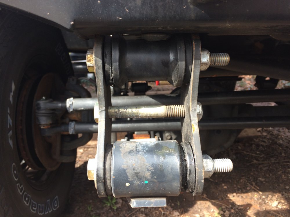

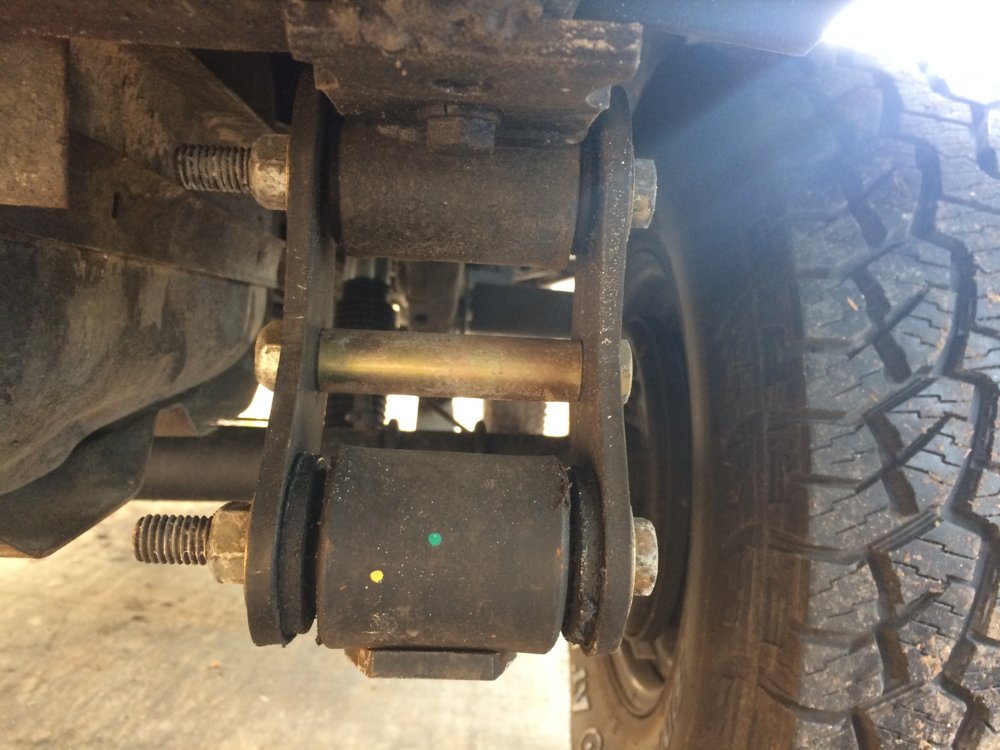

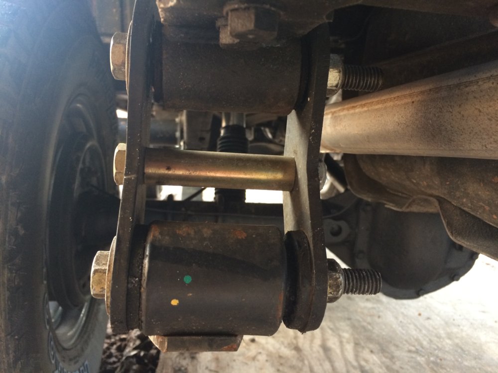

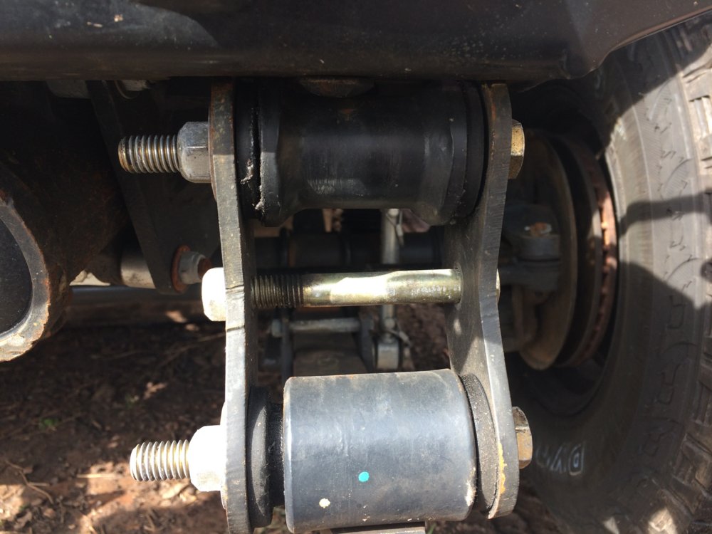

When I did the YJ spring conversion, I used Old Man Emu springs. OME makes their own bushings for their springs, but they're really expensive; so I just bought some standard YJ poly bushings. The issue is that OME springs are a .25" narrower than stock YJ springs, so there is a bit of a gap between the spring and the end of the bushing / shackle.
Today at 4WP the tech drove my Jeep around, pulled it in, looked around, and immediately noticed the gap between the bushings and the springs.
He thinks that's the cause of my vibration. That there is so much play between all the springs with all that gap on each spring that it's causing vibrations.
He said he would still balance the tires, but his money was on all that slop.
I'm not apposed to that idea, and I've been putting off buying the correct OME bushings and Crabtree shackles since I did the lift.
So that's what I'm going to do next, and go from there...
Flat washers to fill the gaps. Unless the bushings are shot and need replacing anyway.
They're not shot, but washers won't close the gap. The bushings are butted up against each other (see post #2). The OME bushings have a thicker.. flange(?), to close that gap.
I've read where some guys shave down one or both bushings to close the gap but that seems like too much of a band-aid on a major component of something I drive daily. I'd rather just do it right, without a bunch of stacked washers and what not.
I would cut half the difference of the inner side of each bushing, and cut down the sleeve. Then put a greased fender washer on each side of the bushing if needed.
As long as u don't cut too much off, you will be no worse than you are now.
While those bushings could be causing ill handling, I don't think they are causing that vibration.
Did the tire balance net anything?
It wouldn't even worry about taking too much off as long as you had that washer to hold it tight. Greaseable bushings usually have a gap between the two. I also doubt it would cause any vibration at all. Sloppy handling in the turns for sure.
