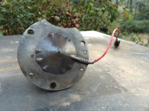

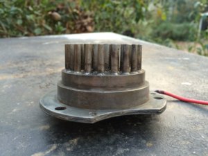

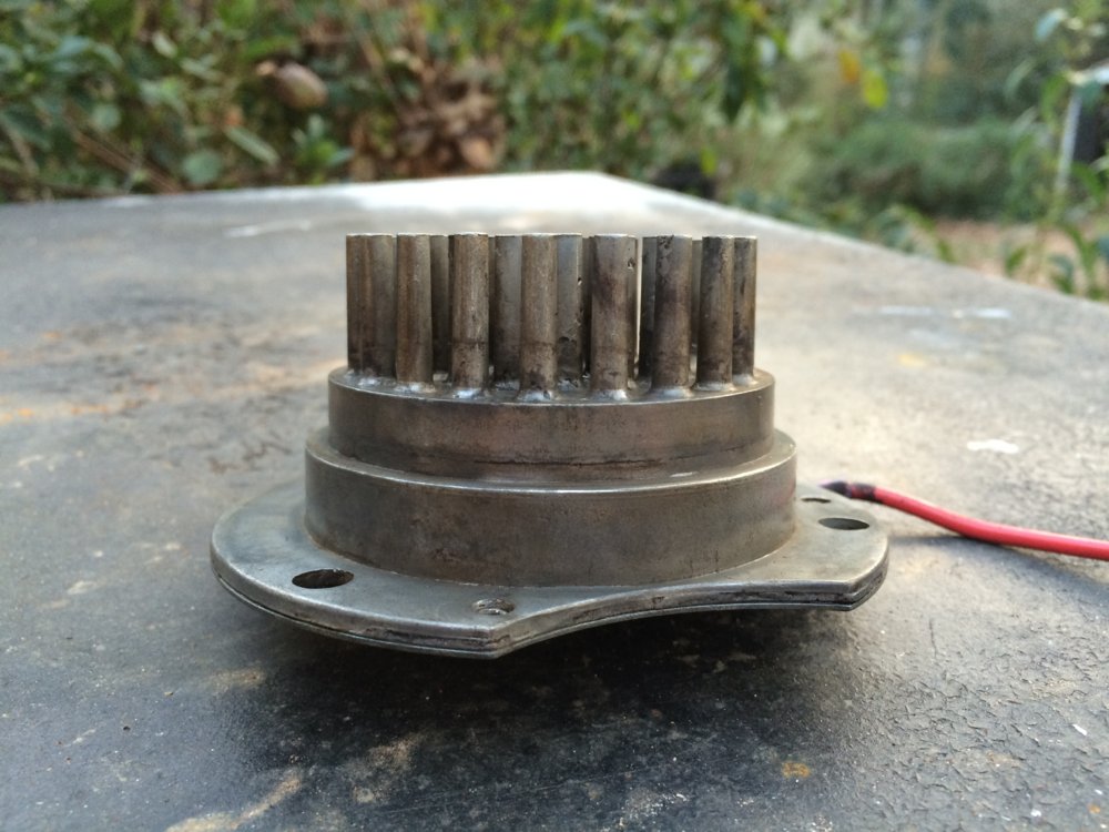

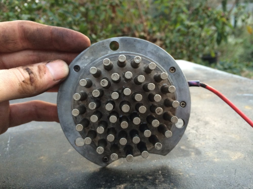

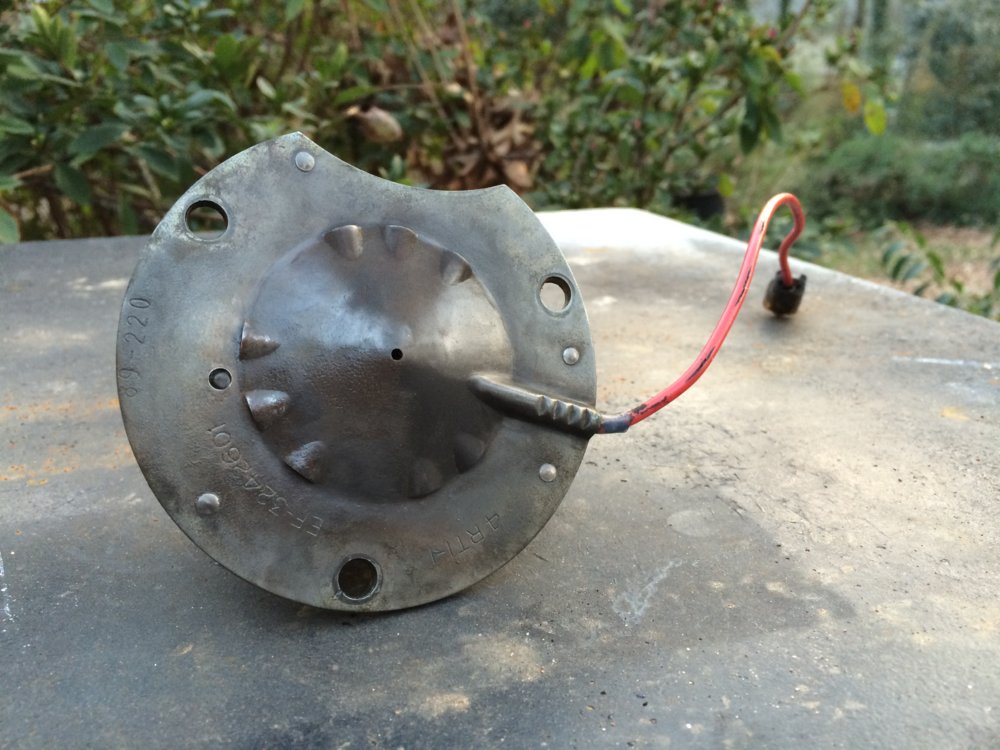

Finally found the time to make it up to see @Blaze and pick up his good intake heater. Thank you!!

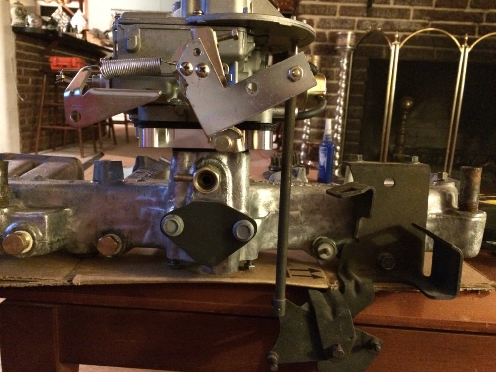

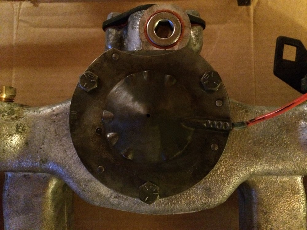

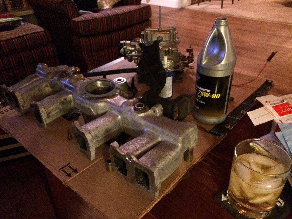

Got it all cleaned up and ready to install. I've read online that an intake/exhaust gasket kit will include the intake heater gasket and o-ring. I hope they still do...

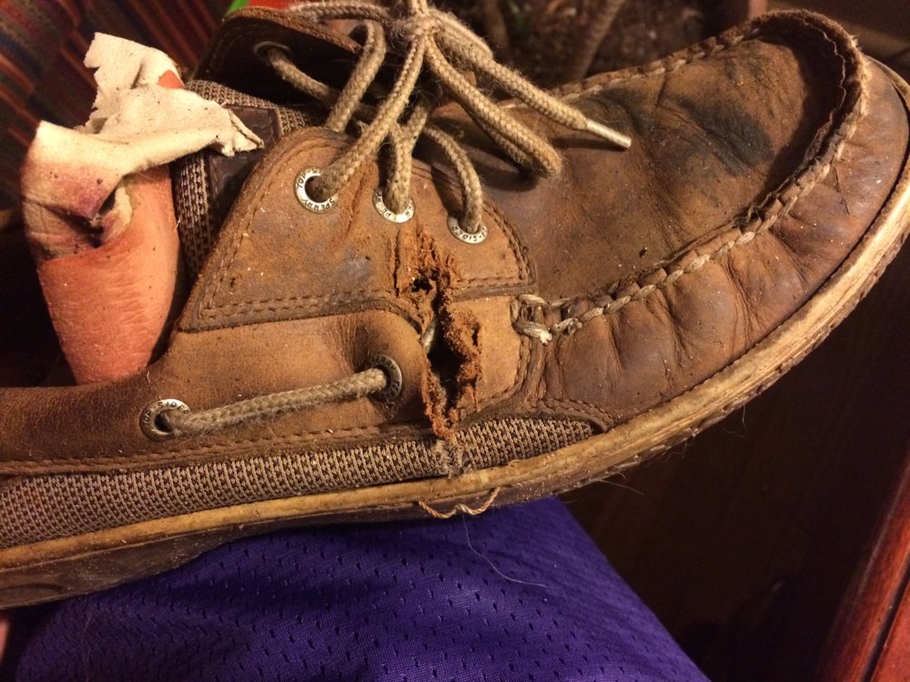

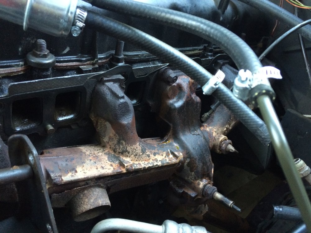

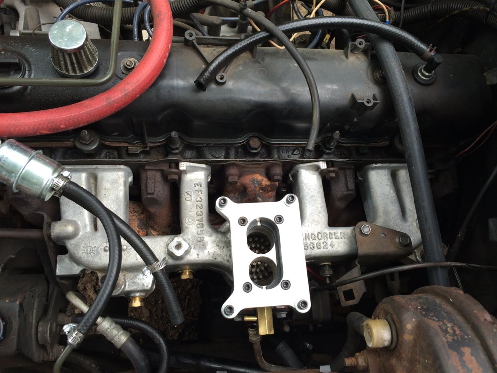

Also a first for me today. While I was cutting out a blank to cover the EGR ports on the intake my grinder got bound up and kicked back. I lost my grip on it and fell straight on my foot. It bounced on my foot, bit me twice, then landed straight on the cord.
So, I lost my whole afternoon while waiting for stitches at the ER, and I need to buy a new grinder.. Not how I planned on wrapping up my weekend..

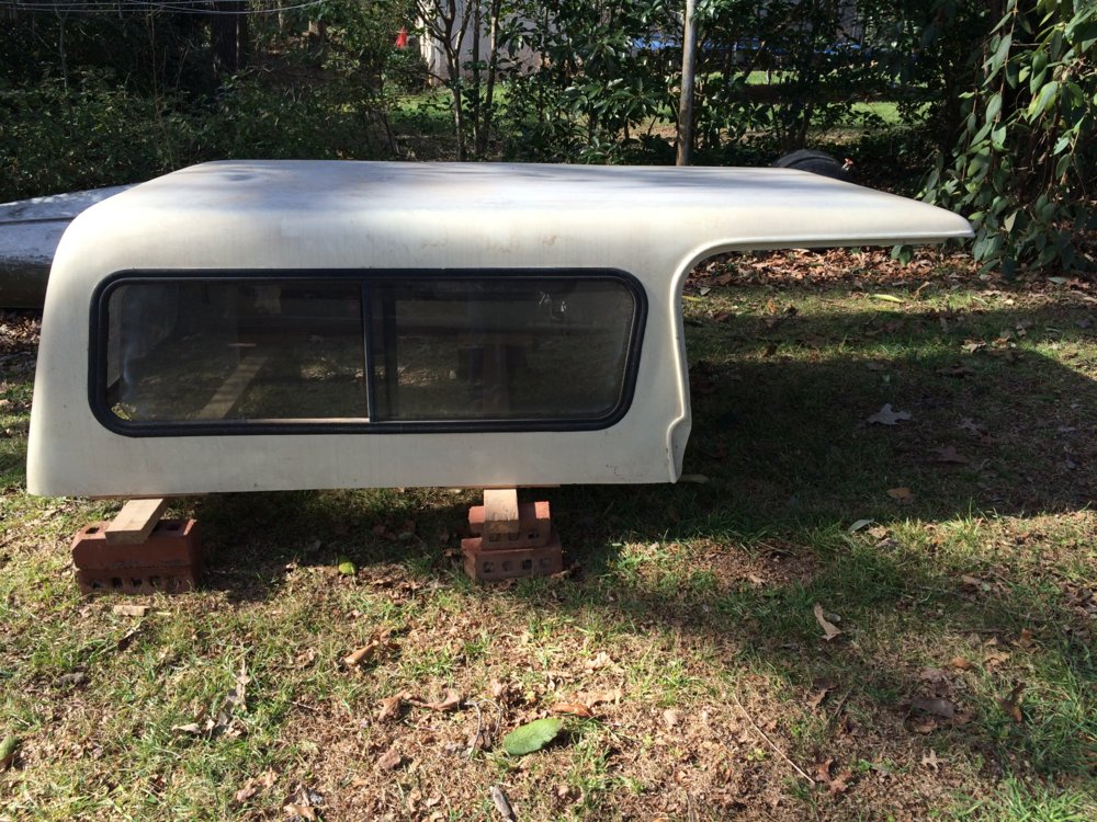

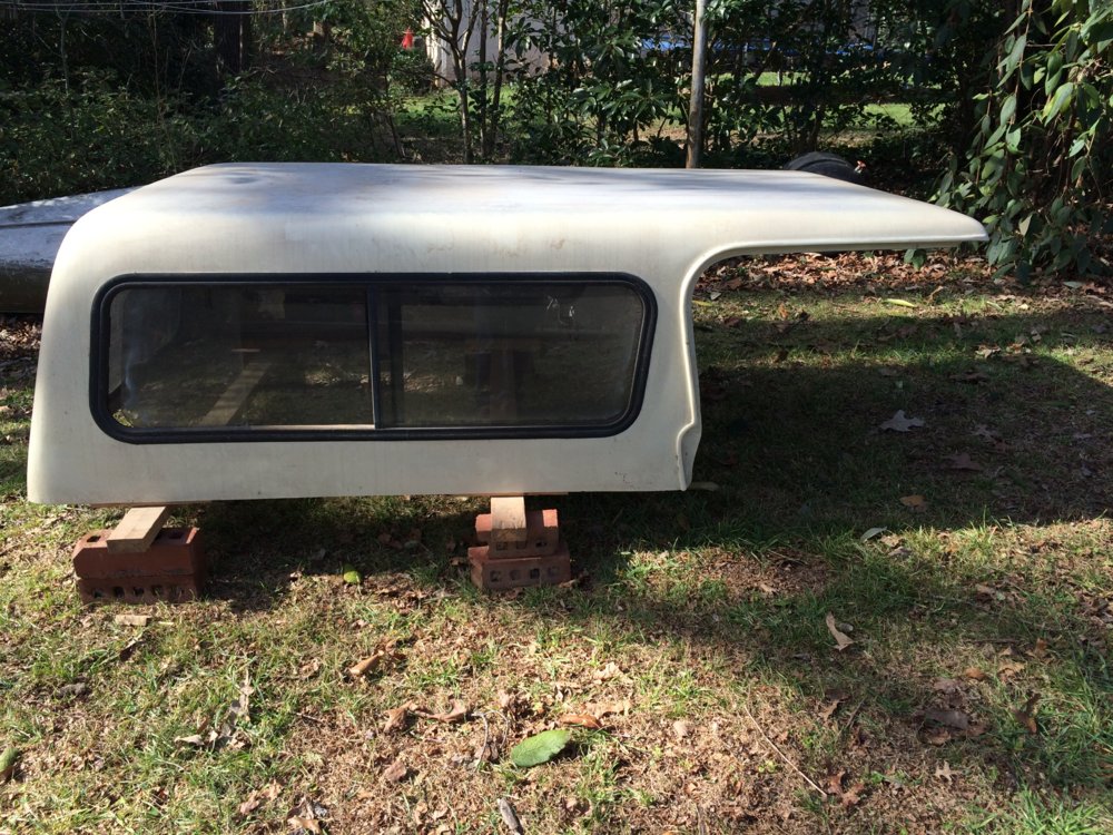

Well, what do you do when you find out that you and your wife's first try at having a baby turns out to be twin girls?
You buy a full hard top for your Scrambler so you can put a back seat in it :D
It needs a few fiberglass touch ups before I paint it.. I'm considering having someone else do the work on it since my honey-do list has grown exponentially. If anyone knows a good fiberglass guy in Raleigh let me know.
With that being said, I haven't had any time to touch the Jeep. I'm hoping I can finish getting the house baby ready this month so I can spend what time I have left before the girls come (roughly three months) finishing some things up on the Jeep.

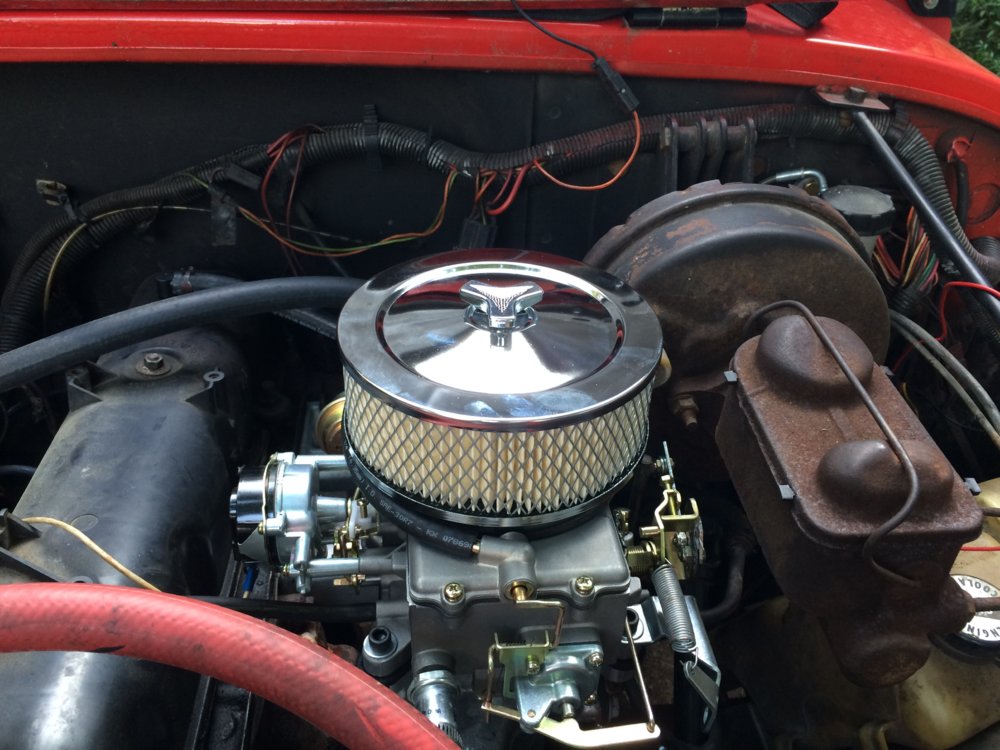

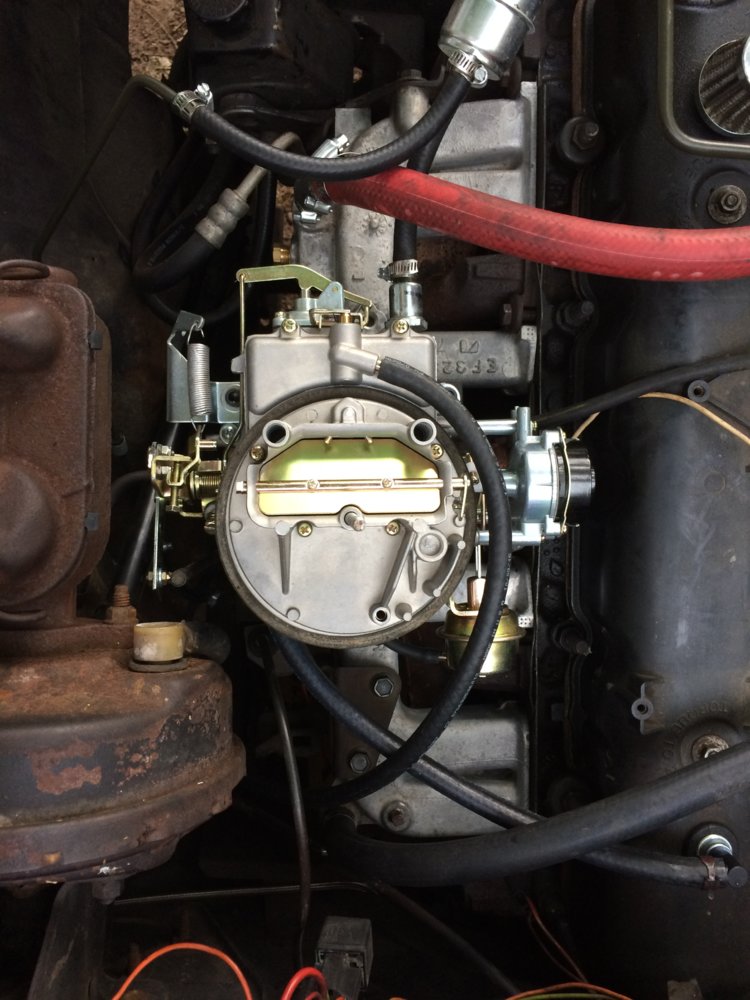

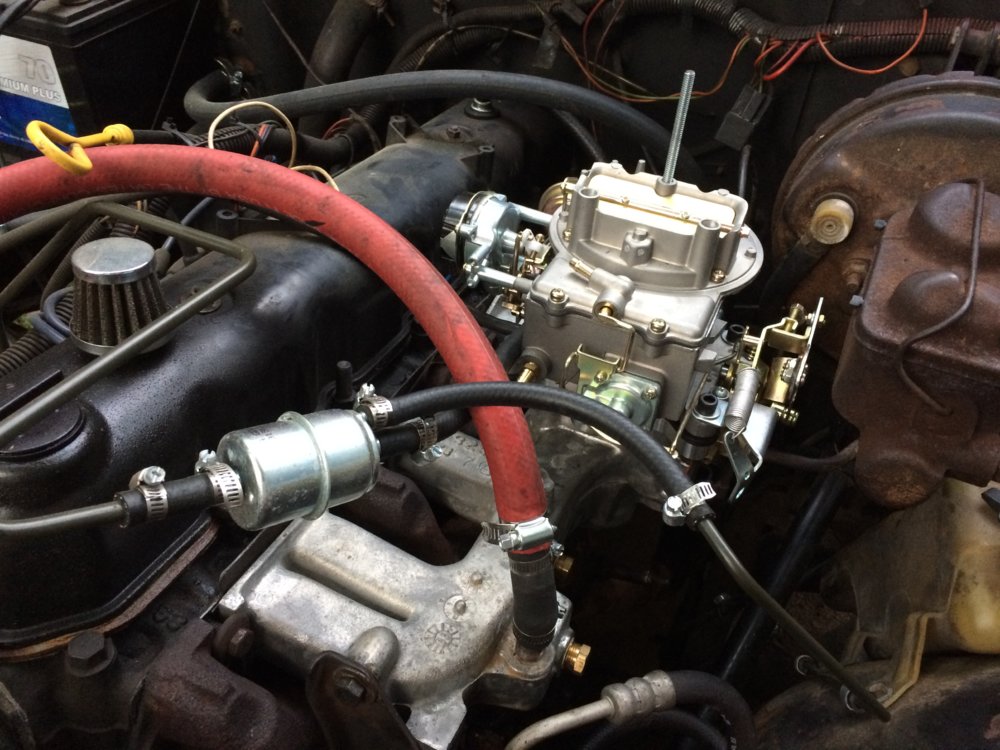

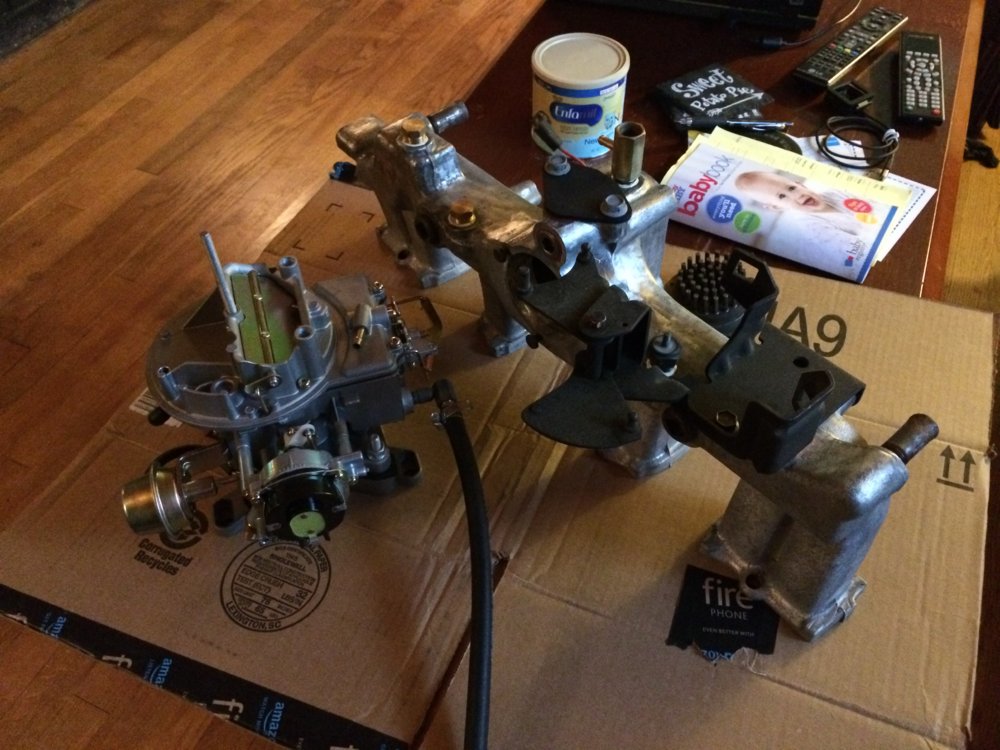

OEM intake is all mocked up with the MC2150, so it's ready to install. I also got the Jeep inspected so it's ready for the swap!

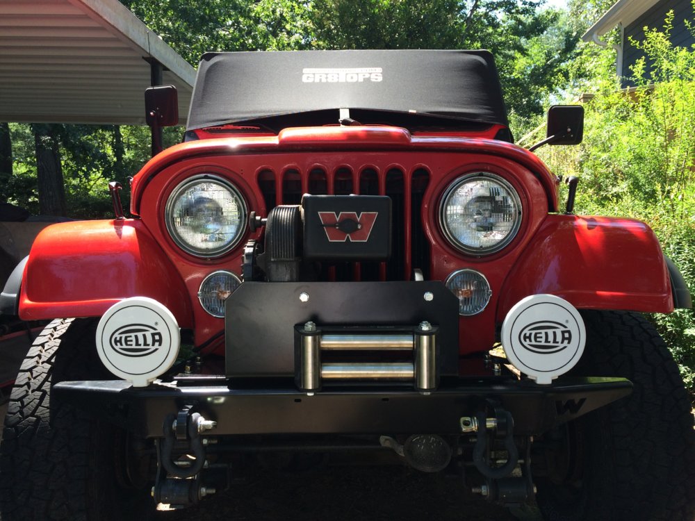

For fathers day, even though I told her not to spend any money, my wife bought me the winch plate and new cable I need to finally install the 8274 I bought a year ago. I plan to use 2/0 gauge cable to wire the winch, through a keyed disconnect and secured with one of those Factor 55 lockable bolts. Good plan?
This is the keyed disconnect I'm planning on purchasing: Flaming River Big Switch
Is that a good switch to use, or is there a better / safer solution? I want it easily accessible so I'm planning on securely mounting it straight to the winch plate.

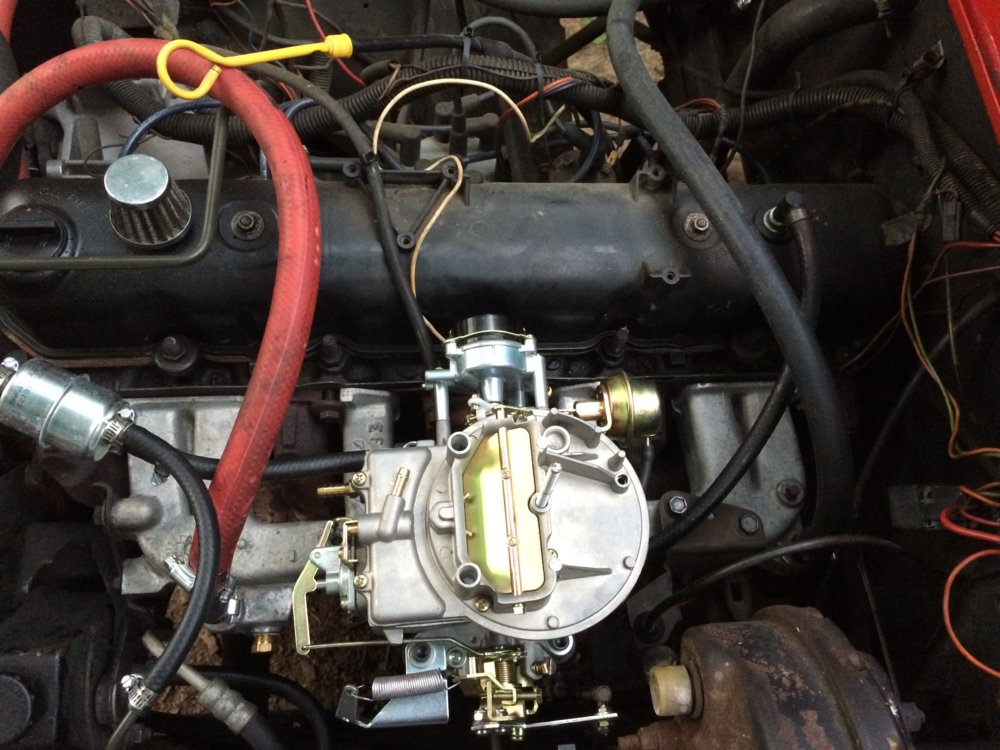

Was a very straight forward install. I did have to fight with the power steering bracket to get it to fit. Even still I couldn't get the big through bolt at the top to line all the way up.
I checked my timing and tuned the carb and it cranked and ran like nothing had happened.
On my first drive, the very first thing that I noticed was my gas pedal. It wasn't hard as all get out to press and actually felt like a normal car. That's a relief.
The second thing I noticed? Definitely down on power compared to the Offy and 4bbl. Pretty surprised how noticeable it was, but I haven't started tuning the carb any more than just my initial tune, I have a sneaking suspicion that I'm running a little lean right now. I will be buying a wide band A/F gauge to further tune it, just down the road. That's a lot of money right now with twins on the way.
Starting to wire the winch up. This is not at all what I should be spending my Jeep money on (still no 4wd), but having an inoperable winch on the front is killing me.

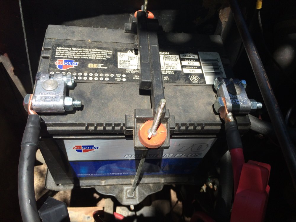

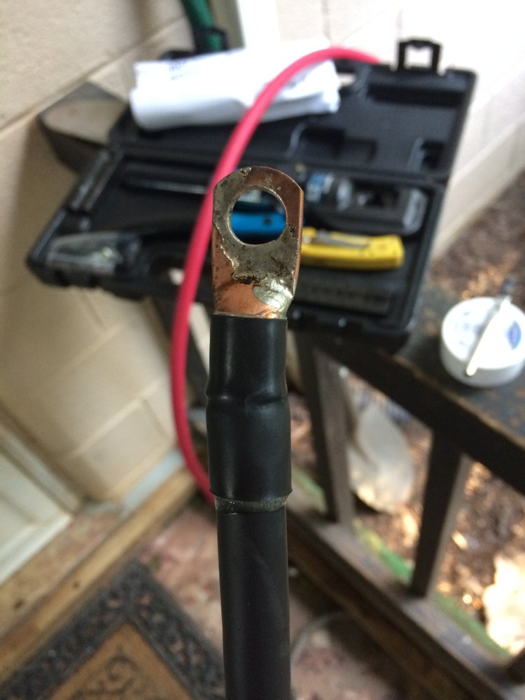

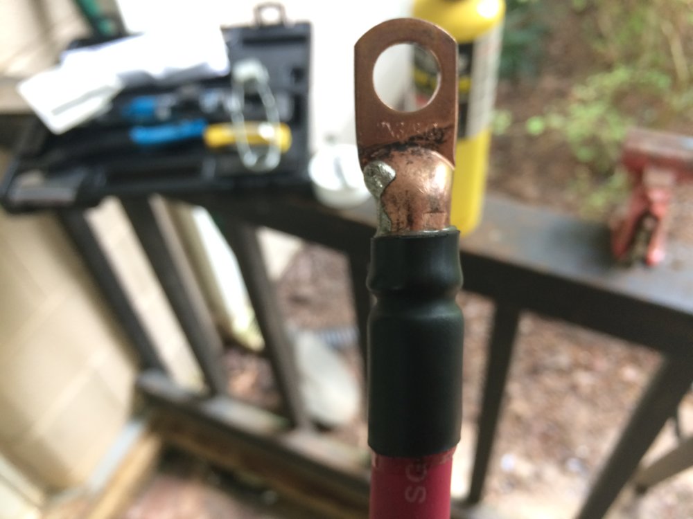

I'm swapping over to mil-spec terminals so I'm running new main battery leads first, 2awg. This is my first time doing a crimp and solder connection. I don't think I did too bad, but it's not pretty.
I'm going to run the winch in 2/0, through a Flaming River keyed switch mounted next to the winch. I'm considering branching off of that to an Anderson connector for quick accessory connections (like jumper cables), But I'm still thinking about it.
The 8274 has one bad relay so I'm thinking about doing the solenoid swap as well.

Cable lugs look nice. I am using the same exact battery terminals too. I got finished doing a bunch of that for a solenoid box relocation. I did a lot of research prior to beginning mine and saw only negative support for any solder. Instead I put silicone under the shrink wrap where any copper wire was exposed after crimping.
Did you just solder up the lugs after the crimp or dunk the wire into molten solder in the lug then crimp?

I first slapped some flux on the cable and the inside of the cable terminal, then crimp, then heat and solder.
I used the shrink wrap that has the glue built into it, so once heated the glue will seal everything off from the environment. You can see the glue coming out of each end of both pictures of my lugs.
Here's the end product:
A small update - The MC2150 I bought came with .48/.49 jets and a 7.5 power valve. I bumped the jets to .50s and the power valve to 8.5. So far it seems to be running better without running rich.
I also filled it up for the first time since I swapped the carb and intake and it averaged 17.6 mpg! That's up from the 11.x I was getting with the Offy / Holley combo! :)
Nice I've got the 2100 on my 8, before I regeared the jeep I got 21mpg average on a drive to hilton head and back. Nice to hear of the improvement over the Holley setup, I've been toying with the idea of changing mine. I guess I'm better off leaving it as it is.
