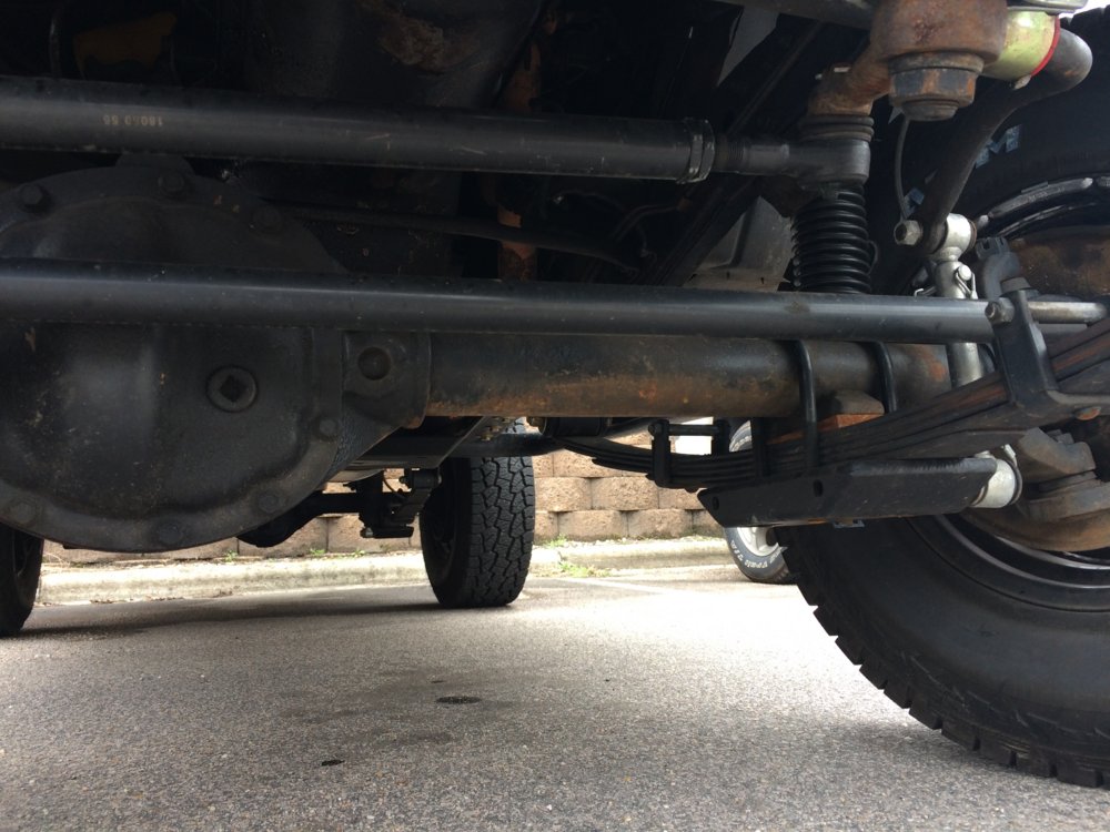

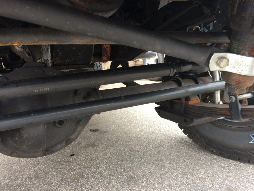

I had the same problem once I hit 55 . Do you have a steering stabilizer ? And have you checked to make sure that the front axle long tube is not bent? Mine would give off a slight vibration at 55 and some times it felt like the whole jeep was about to come apart and shifter would shake like crazy.
No steering stabilizer (yet.. I still need to add one), but the long tube appears to be ok.
Get a stabilizer and take it to your local 4wd shop and have them make sure axle is not bent. I bet that is the issue I chased the same problem for months .

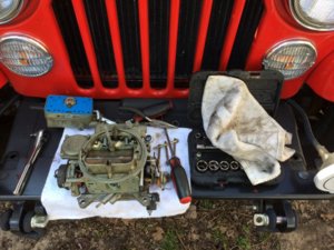

Also, my 'quick' OE intake and carb swap is taking me waaay more time than I imagined (of course), so I finally broke down and spent the $20 for a 9.5 power valve and a set of .46 and .47 main jets for the Holley 390. Gotta keep the daily, dailyable.
In an interesting turn of events, I have fooled my company into getting me a company car. The Jeep is still my only personal vehicle, but it at least doesn't have to do the daily grind anymore.

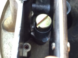

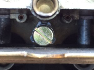

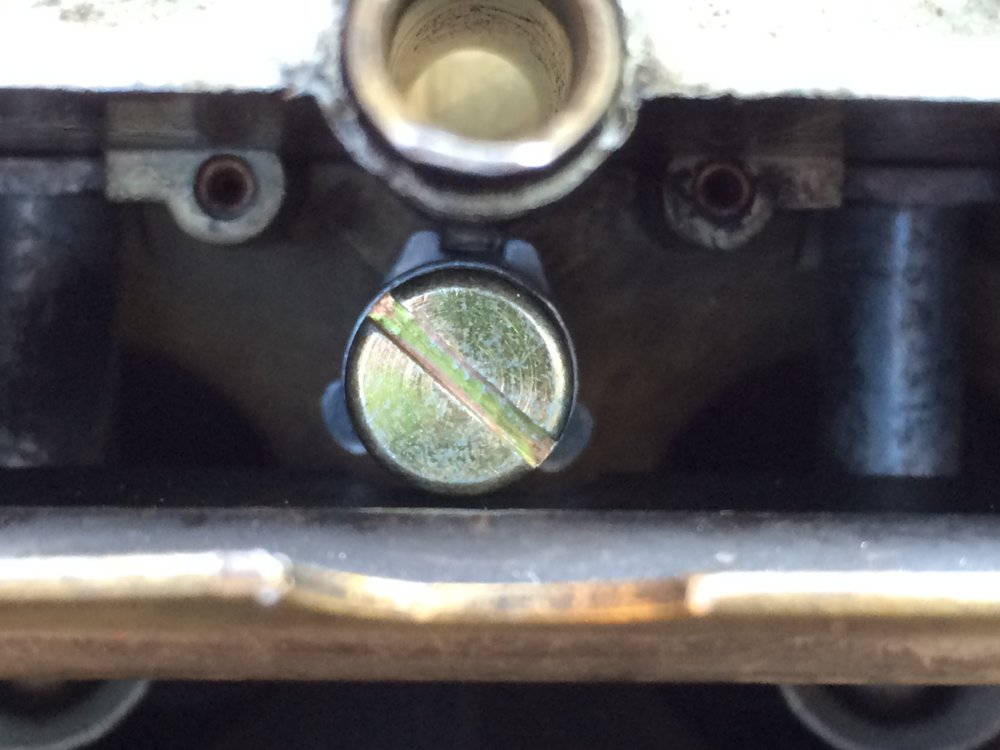

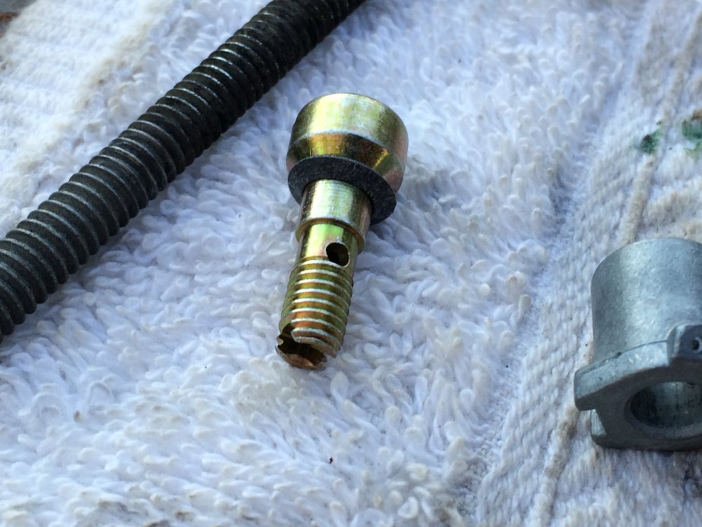

With that said, I stripped the F'ing accelerator pump nozzle screw yesterday while trying to tune out a stumble. So now I'm waiting on a 12-28 helicoil (which are really hard to find!) and some parts from Holley.
I still haven't figured out the vibration. Still leaning towards wheels though...

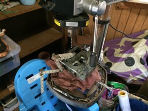

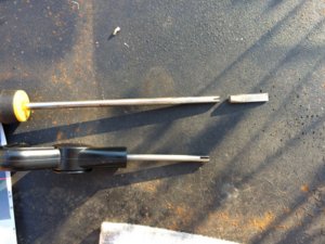

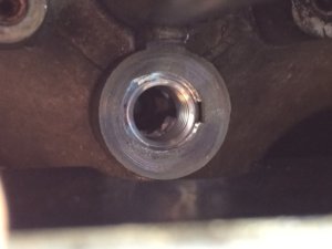

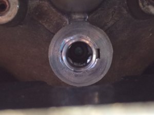

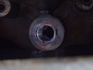

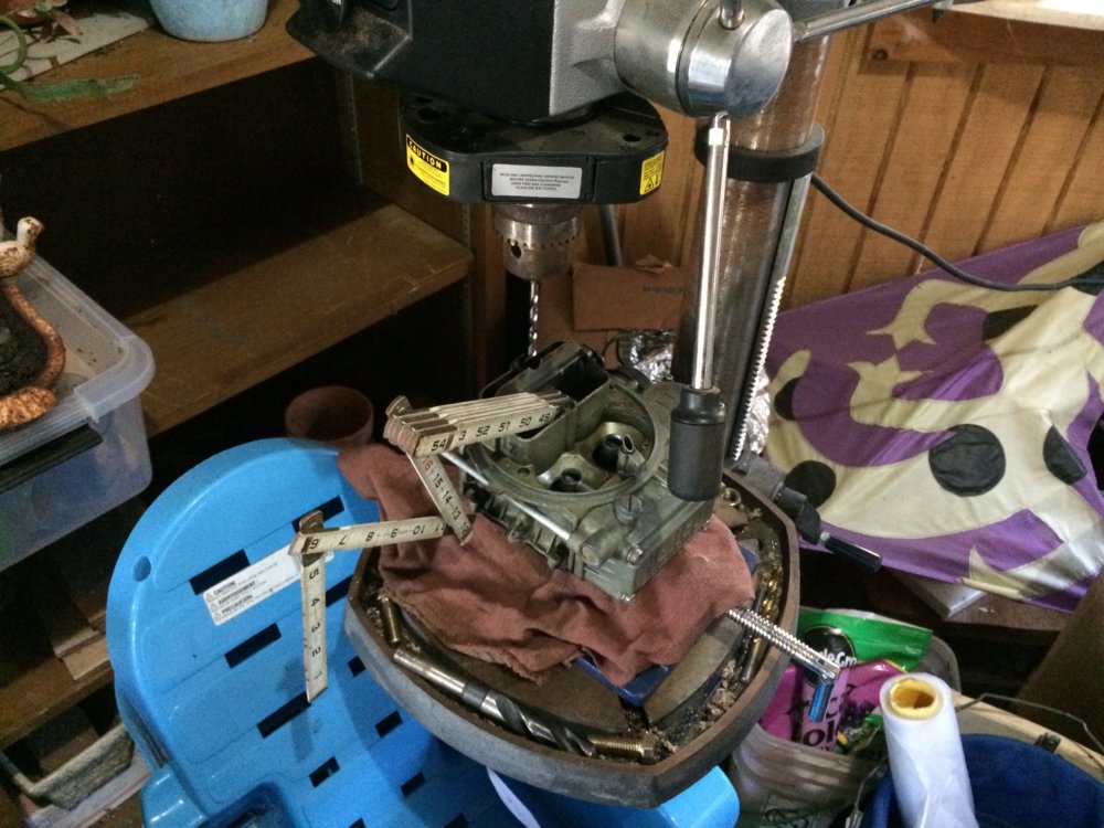

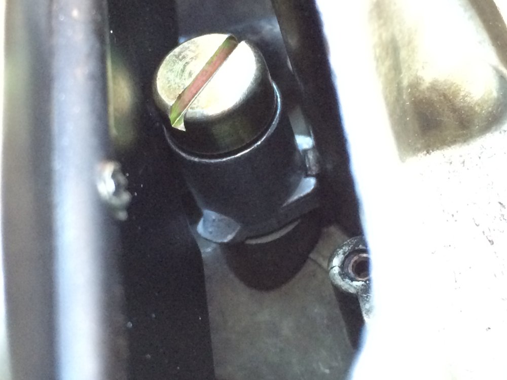

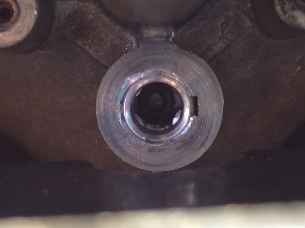

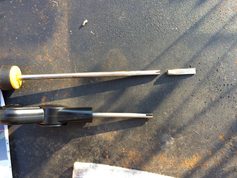

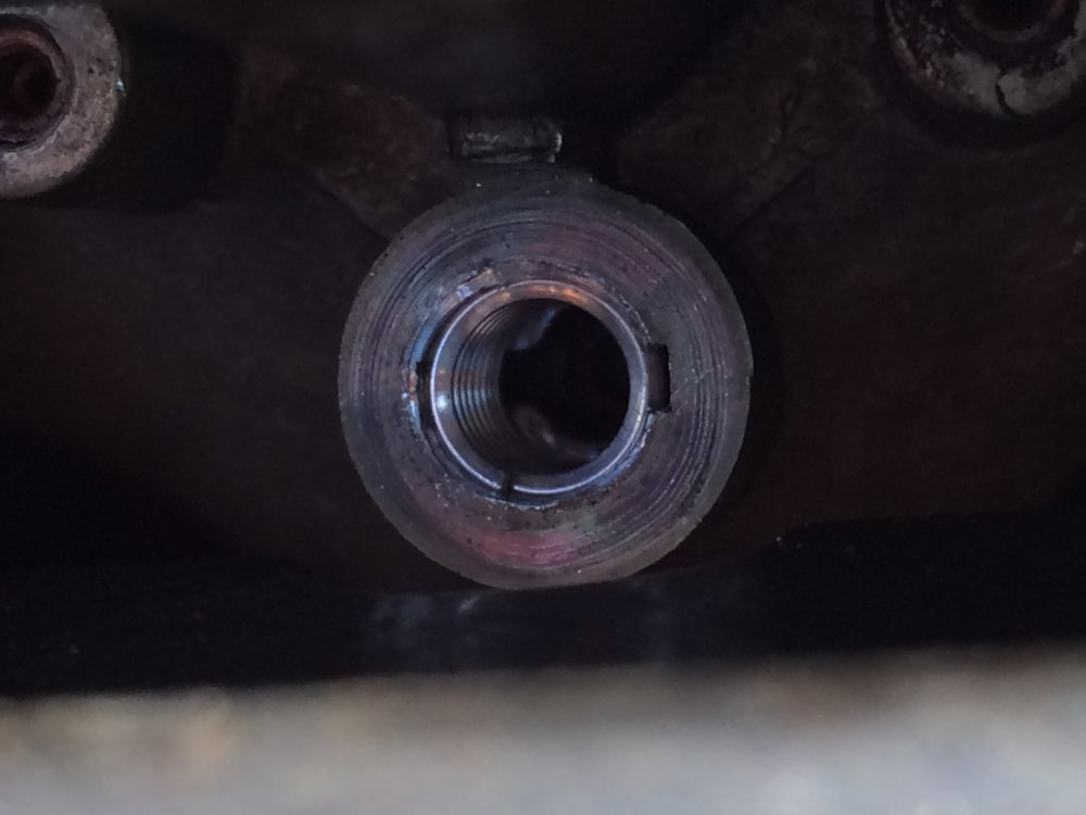

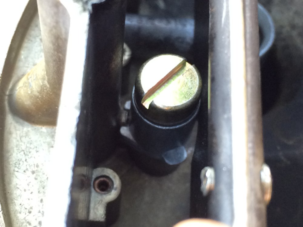

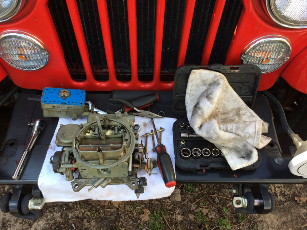

Fixed my stripped out squirter nozzle housing in the 390 over the weekend. That was fun!

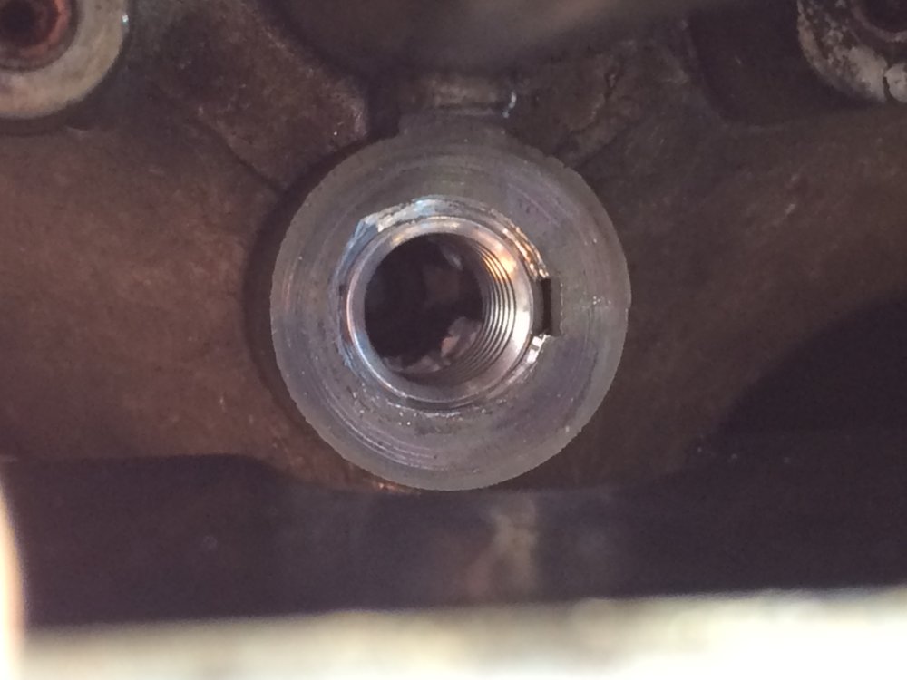

Had to sacrifice a screwdriver to the helicoil gods so I could install the thing down in the primaries. The supplied tool was too short to reach past the choke plate and primary bowl breather.
IMG_2393.JPG IMG_2396.JPG IMG_2399.JPG IMG_2401.JPG IMG_2402.JPG IMG_2404.JPG IMG_2405.JPG IMG_2406.JPG IMG_2407.JPG IMG_2408.JPG
You can see in the pics that I goofed and drilled my hole a little left of center. It seemed to seal up fine, so, so far all is good.
