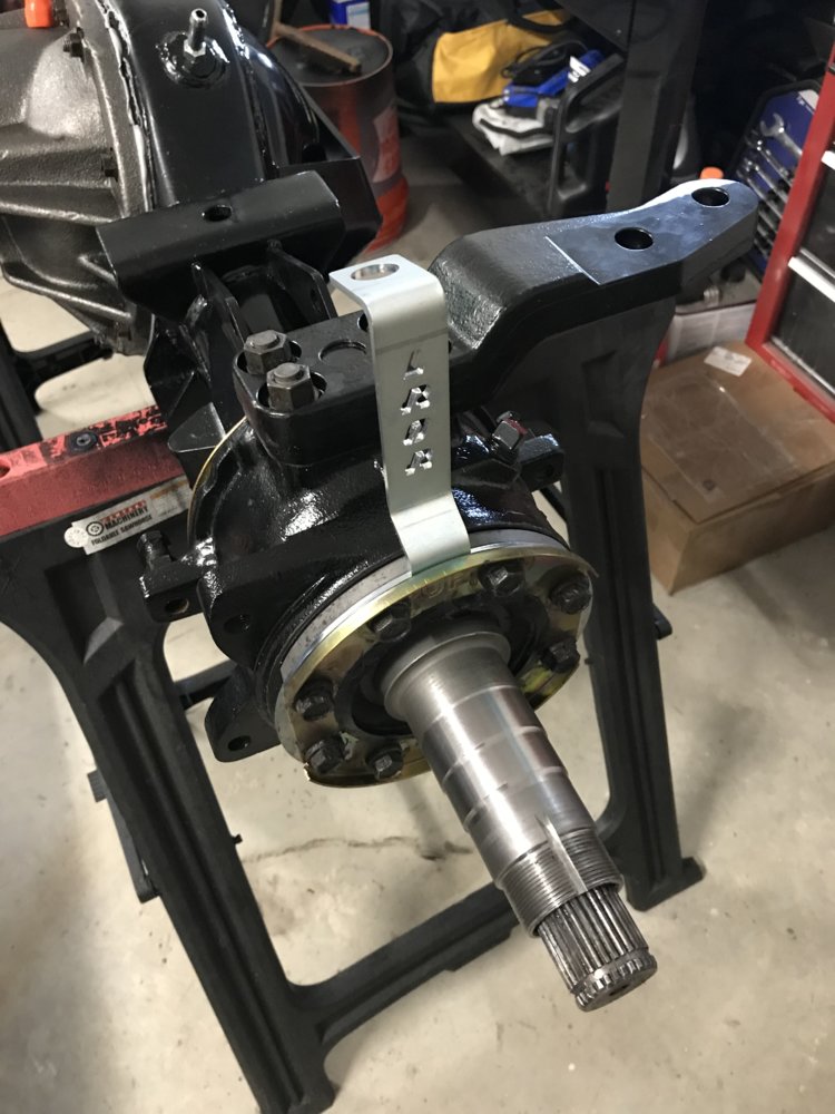

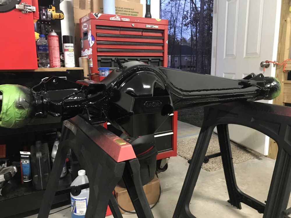

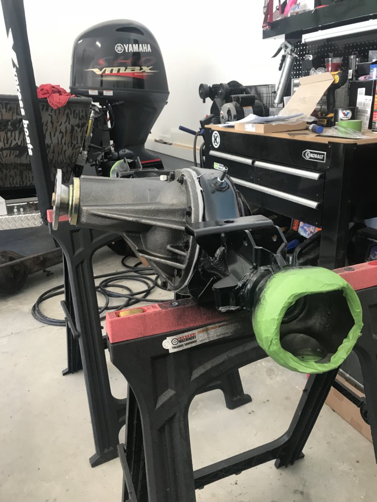

Blasting

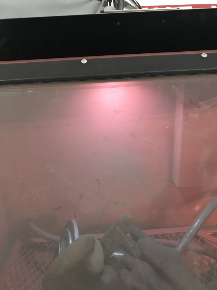

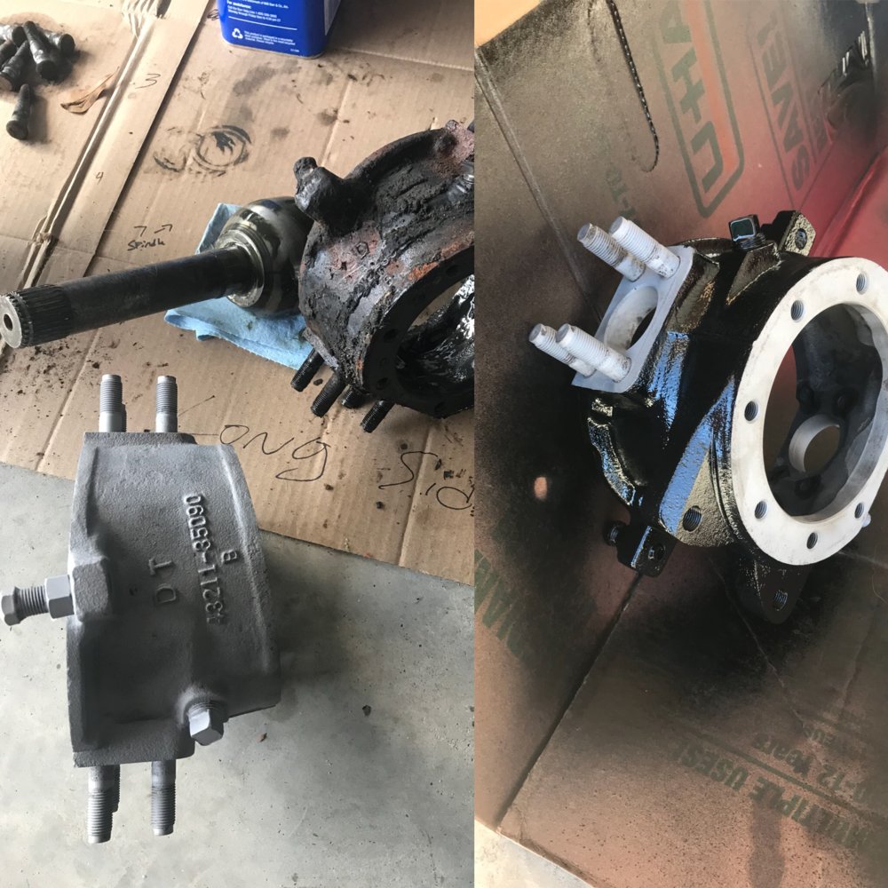

Not happy with the aluminum oxide media, I believe it’s too abrasive. Have to get some glass tomorrow.

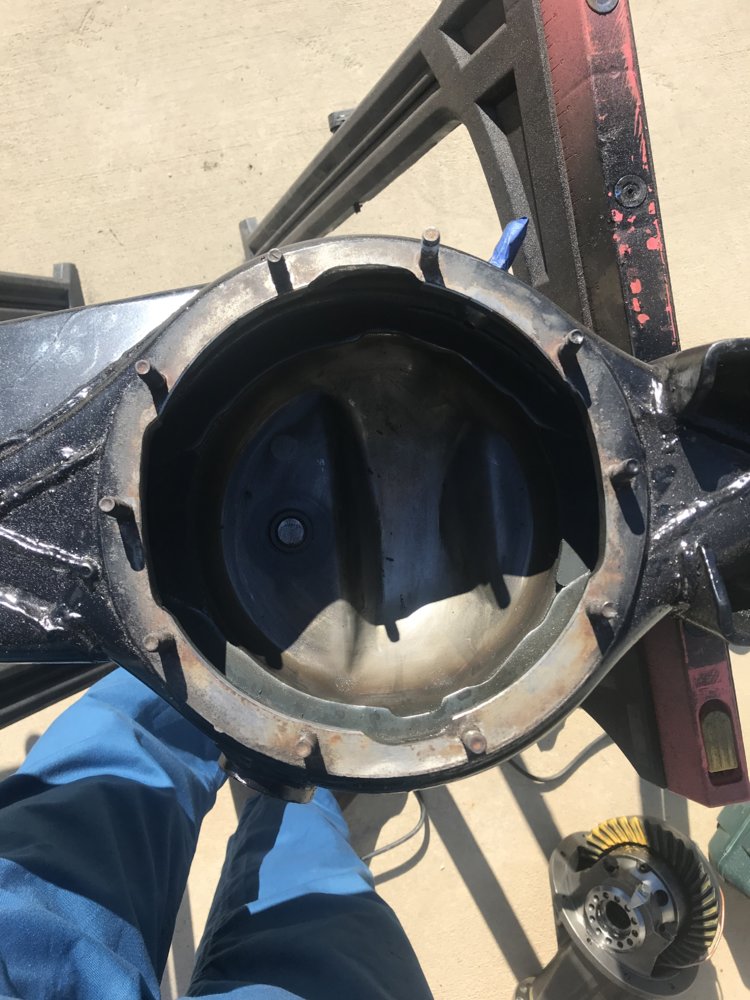

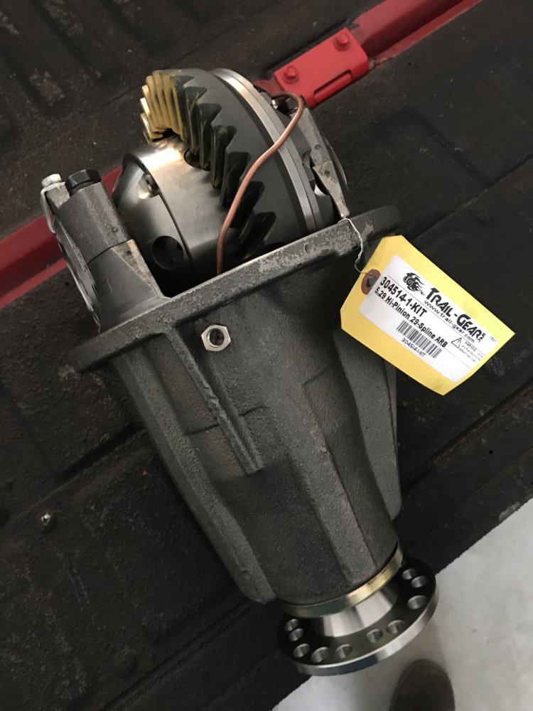

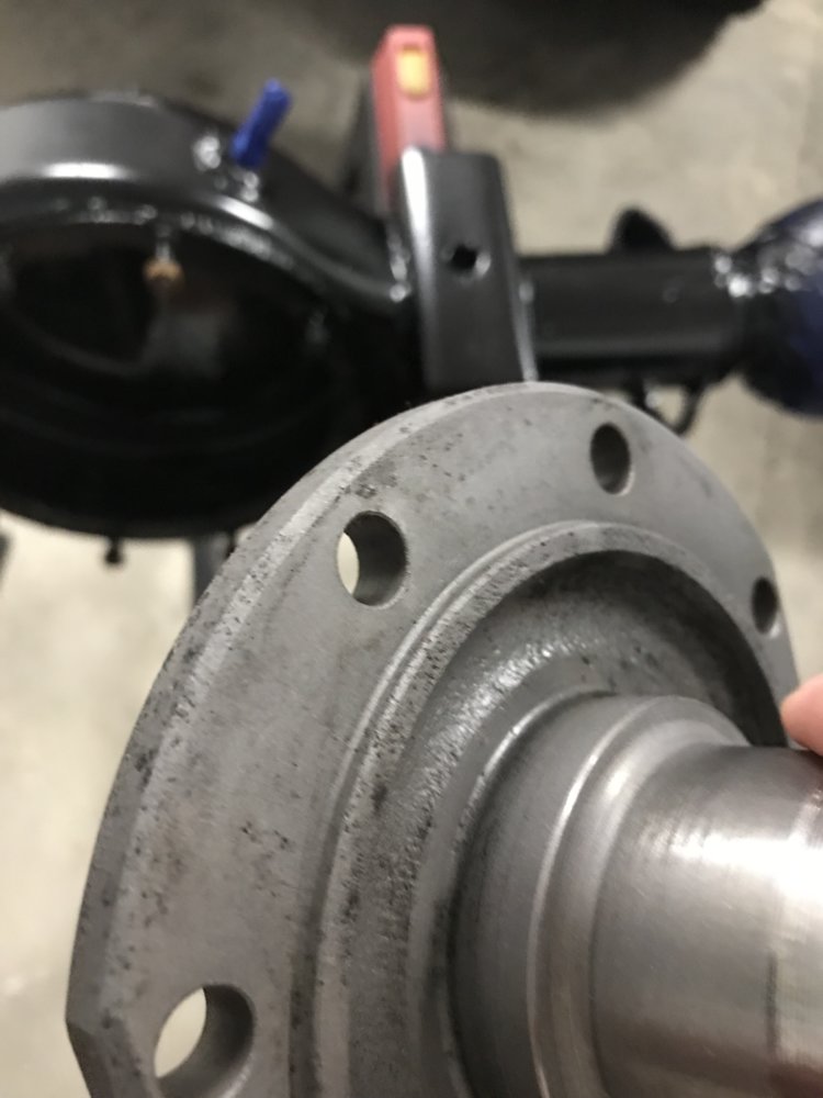

A dry fit makes me think I’ve got some clearancing to do on the housing to get this thing to fit. The bearing caps and ring gear are larger on this diff versus the 4cyl diff. Anyone have experience with that?

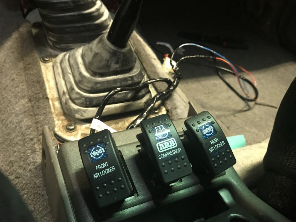

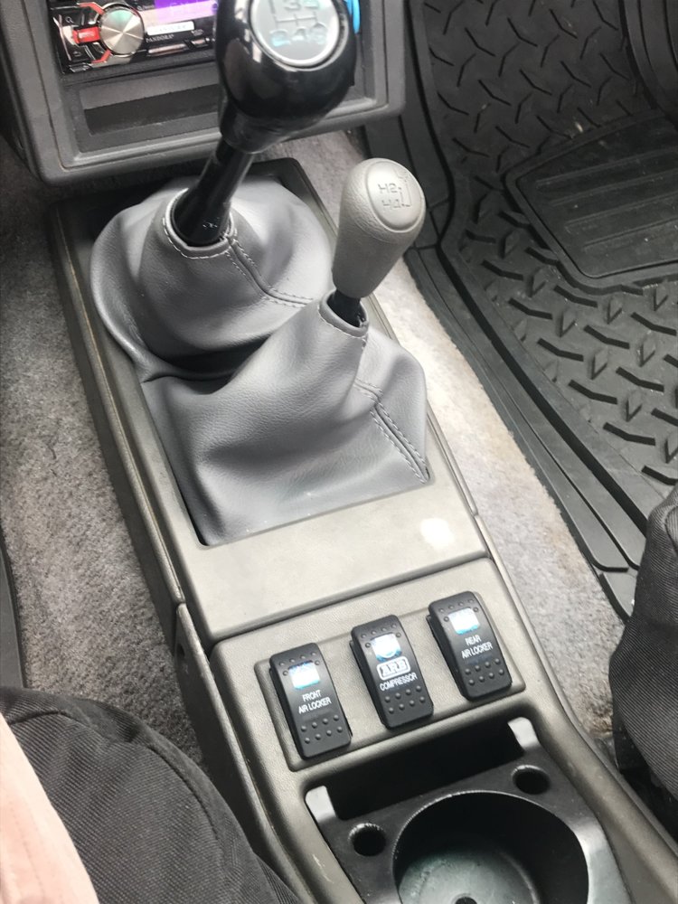

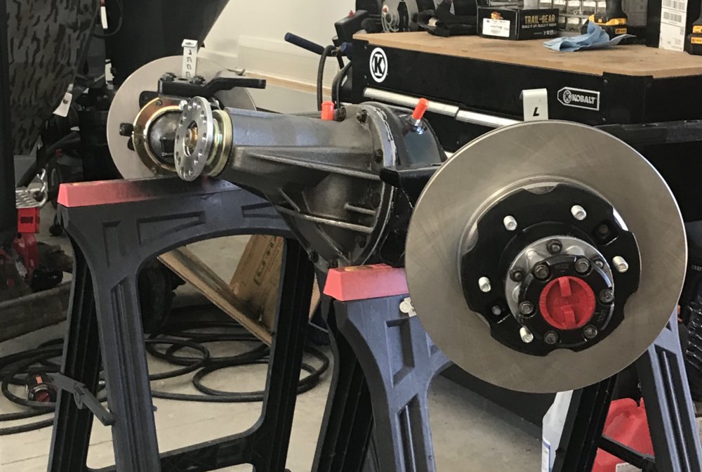

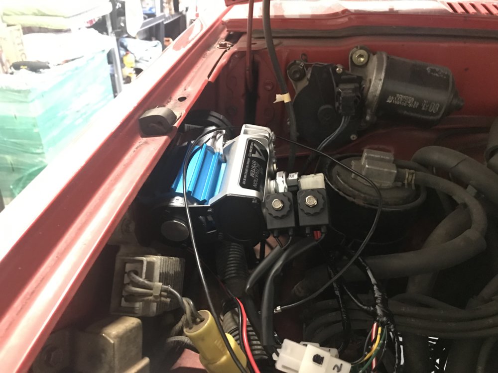

Full lock in progress. Ckma12 was not going to fit without some crazy wizardry so I used the smaller cksa12 compressor. No worries, I can just use my portable compressor for filling tires.
