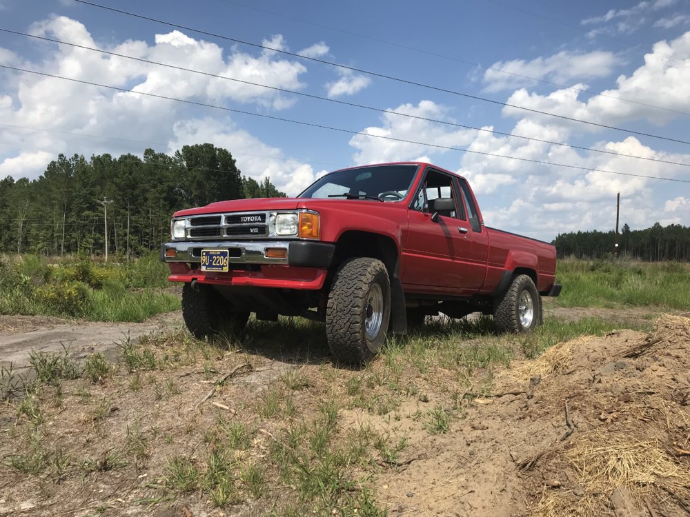

Don't know how u feel about em, but my 84 xcab runs RUFs with chevy rears, and a 2" BL. Clears 36 IROKS with no scrub. Back fender needed a little massaging from previous dent, but front was fine
"dont know how I feel about'em", as in body lift? I'm not a fan thats for sure. did you have a BL and the fenders trimmed or BL only and no rubbing?
2.5" backspacing wheels? wheel spacers?

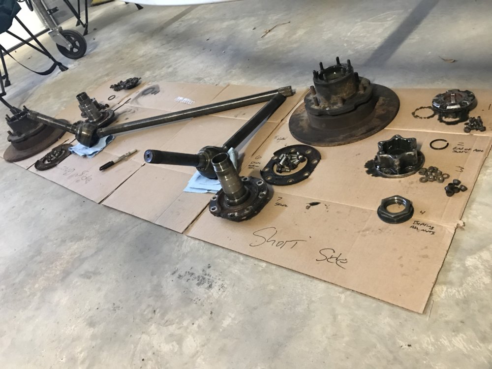

Hey, those parts look lonely sitting there all alone. Hey man let me know how that MC HD clutch works out. Cant wait to see the finished product.
nope no money for that unfortunately. New timing chain, sprockets and guides,New clutch, Replace gaskets, New headers and exhaust. I think I'll be able to get the carb to work pretty good after some mods to it: lower float level, vent overflow out of carb, lower fuel pressure with regulator.

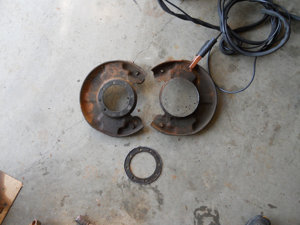

Not that I am stalking your thread, but I saw you were talking about brake plate eliminators, if you haven't purchased them already you can make them real cheap. Just cut em out and grind smooth.
ATTACH]
I cut mine out of the factory backing plates also but not the small circle like pictured. I cut almost all the way around and left the small section where the brake line support is on top. I just like using the factory brake line support tab. I figured it couldn't hurt.
Nope havent baught any yet. That should be happening around the same time as the regear and Aussie's.
Great idea, I'm going to do this.
2" BL, 15x10 3.75" BS, 1.5" WS, and no trimming other than to move bent sheetmetal. Inside fenderwell was beat back pretty good but that was from before the RUFs.

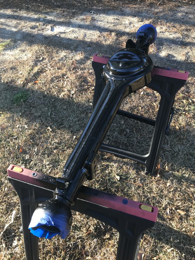

Progress. Brackets cut and grinded smooth. Wire wheeled and painted. Have to media blast all the other axle parts and reassemble.
