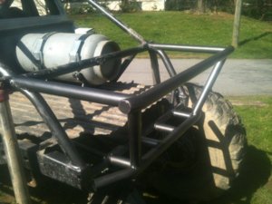

I saved the bedsides just for good measure.you should use the bed sides!!Figured you and a lot of other people would be happyI saved the bedsides just for good measure.

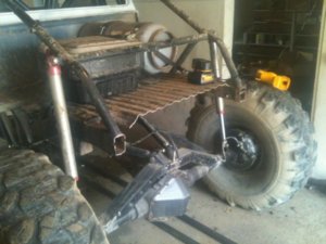

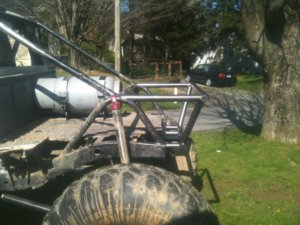

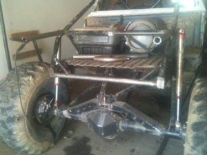

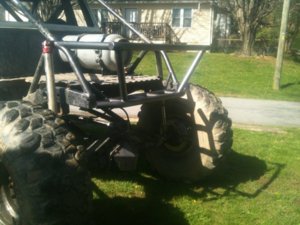

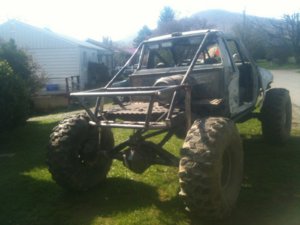

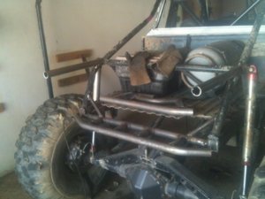

What kit did you use 4-6'' Lift, and what leafs, toyota leafs?? RUF??The front spring hanger kit from Sky and the Chevy 60 U bolt kit showed up tonight. Got a good bit of work done. Ditched the heavy ass front bumper that was on the truck, cleaned up the frame, welded up all the usual stress points around the front spring hanger and front crossmember that like to tear apart on these trucks and mocked up the spring hanger.
Tires and wheels should be mounted up. Will pick those up tomorrow and hopefully have the front end sitting on its own weight later this week.
Just be sure to box in the underside of the hanger...mine is already bashed in.
