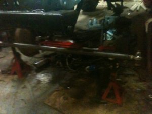

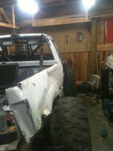

Orbital in, tie rod made, hood pinned...

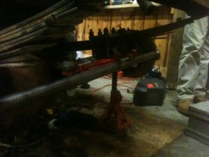

Passenger hub on and narrowed up a little. Just need to go grab some new brake pads.

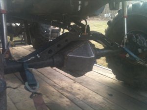

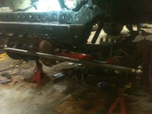

Got the hydro ram mounted tonight. Clearances are pretty tight when turned lock to lock but it should work out fine.

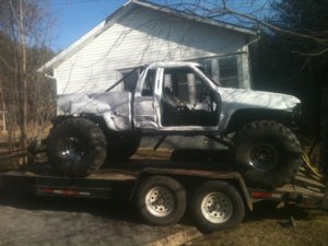

Should have the new front brake calipers in the morning. Going to get it put back together and rolled onto the trailer and move it over to the house tomorrow night. Will probably take it down to Alliance in a week or two for plumbing of the brakes and hydro.

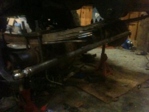

Russell braided 10" SS Line 7/16 banjo on one end and female inverted flare on the other. This runs into a standard 3/16 hard line running up the axle and truss. They join at the top with a standard Dorman Tee fitting. From here I have a soft line running over the joint to the upper link tube. Part Number for this (Wagner F49927, Bendix 88423, Tru Torque H49927, Raybestos BH36531) That should about cover all the local parts houses. After the flex line it runs down the link with 3/16 hard line again and into another soft line over top of the joint. This soft line (Wagner F130685, Bendix 77920, Tru Torque H380070, Raybestos BH380070). It will run more 3/16 hard line up the frame to the master cylinder.
If you wanted to, the two soft lines I have listed will thread into each other and be about 20" Long so you could just thread them together right out of the tee and run hard line down your framerail to the top of the axle since youre still on leaf springs. Should leave enough for droop without binding the lines. Way cheaper than running SS line the whole way.
I am using 1/4" rubber coated straps to hold all of the hard line to the axle, truss and frame. Got em at Lowes in the hardware section. Just gotta find the right drawer. They run about $1.40 per pair IIRC.

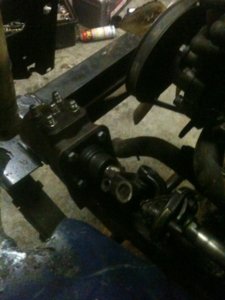

Some front axle beef from RPM and the truck sitting just about perfect.

A little shot of the rear axle all plumbed up. Just waiting on some braided stainless from Jegs so I can finish up the front brakes.
