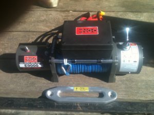

Winch showed up today. Figured id give these new Engo winches a try. So far, less than impressed. Bolts were loose (not ones for the electrical connections) a few small scratches and the leads from the solenoid box to the terminals are a little short, limiting how and where you can mount the box and a few small frays in the synthetic line. Kind of expected with a budget winch and all of it can be made to work but just a few things that make or break first impressions. We will see how it holds up.

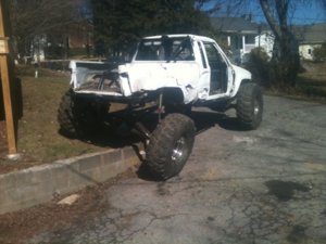

Off the trailer and drove it around a bit today. Brakes and Hydro still need to be bled a bit more and go over all the bolts but it's almost there.

haha love the looks of that bed just hangin on for the ride!! truck looks awesome.

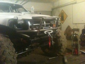

Winch mount done and grill cut to fit. Going to shake it down on Saturday and see how everything goes. So far the only things I think might need to be addressed is a rear sway bar to help the front end work a little more and a higher output steering pump. But it works as is so Ill roll with it for now.
Shakedown went good...Steering needs a higher output pump and to relocate a higher capacity cooler. Stock pump just cant keep up with a 2x8 ram and it wanted to get hot and lock up a lot. Otherwise it just flat out worked. We will address the steering issue then give it another go.
